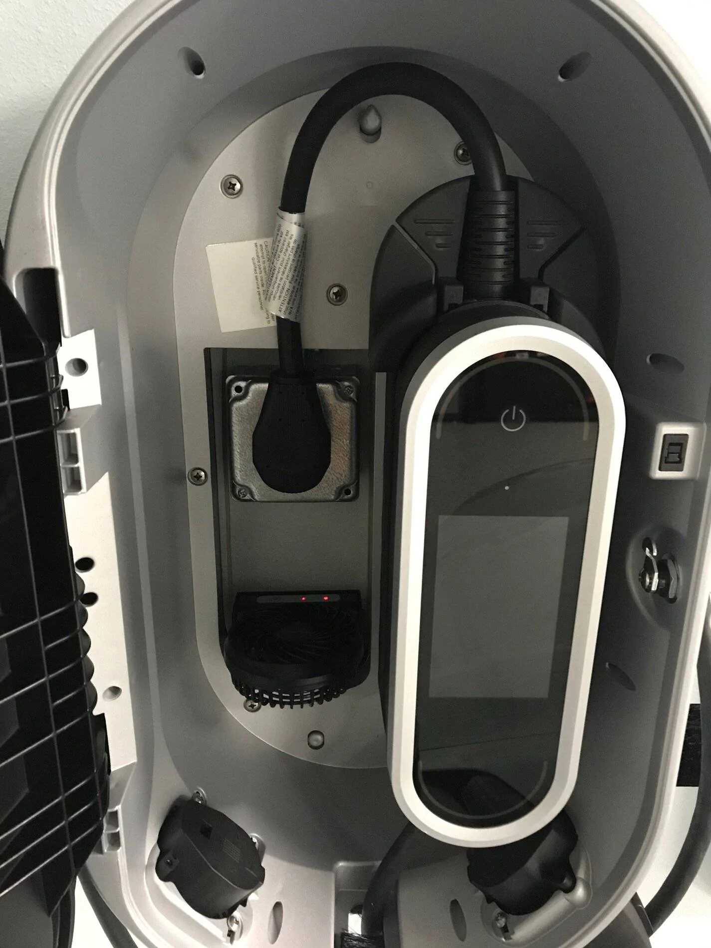

I ordered a 25 foot cable with my Porsche charger for my Taycan. Charger
getting extremely hot .
A warning about overheating appeared on the screen.
Also- having problems connecting car to charger.
Electrician who installed charging station is coming to my house this week.
Anyone else experiencing this?
Thanks
Here is how I solved my PMCC overheating issue.
First I had to put a fan in the front part of the car to blow a steady stream of air into the intake vent on the passenger side. If you haven’t noticed this is where the fan sucks air in to cool the battery when it needs cooling during charging. By putting a fan here I help the internal car fan move much more air and keep the battery cooler.
Second, I lowered the charger to max out at 30Amps.
That seemed to do the trick.

Anyone know where to buy this fan or have link. Seems perfect size and if rechargeable battery...
5 - Add small cooling fan, airflow can reduce temps significantly.
Not sure what fan you are referring to but a small computer fan something like this Fan probably would do the trick along w/a spring wound count-down timer (8 hr or whatever)......course you'd need to cut holes for both the fan and exhaust.
Like I need another project :headbang:.

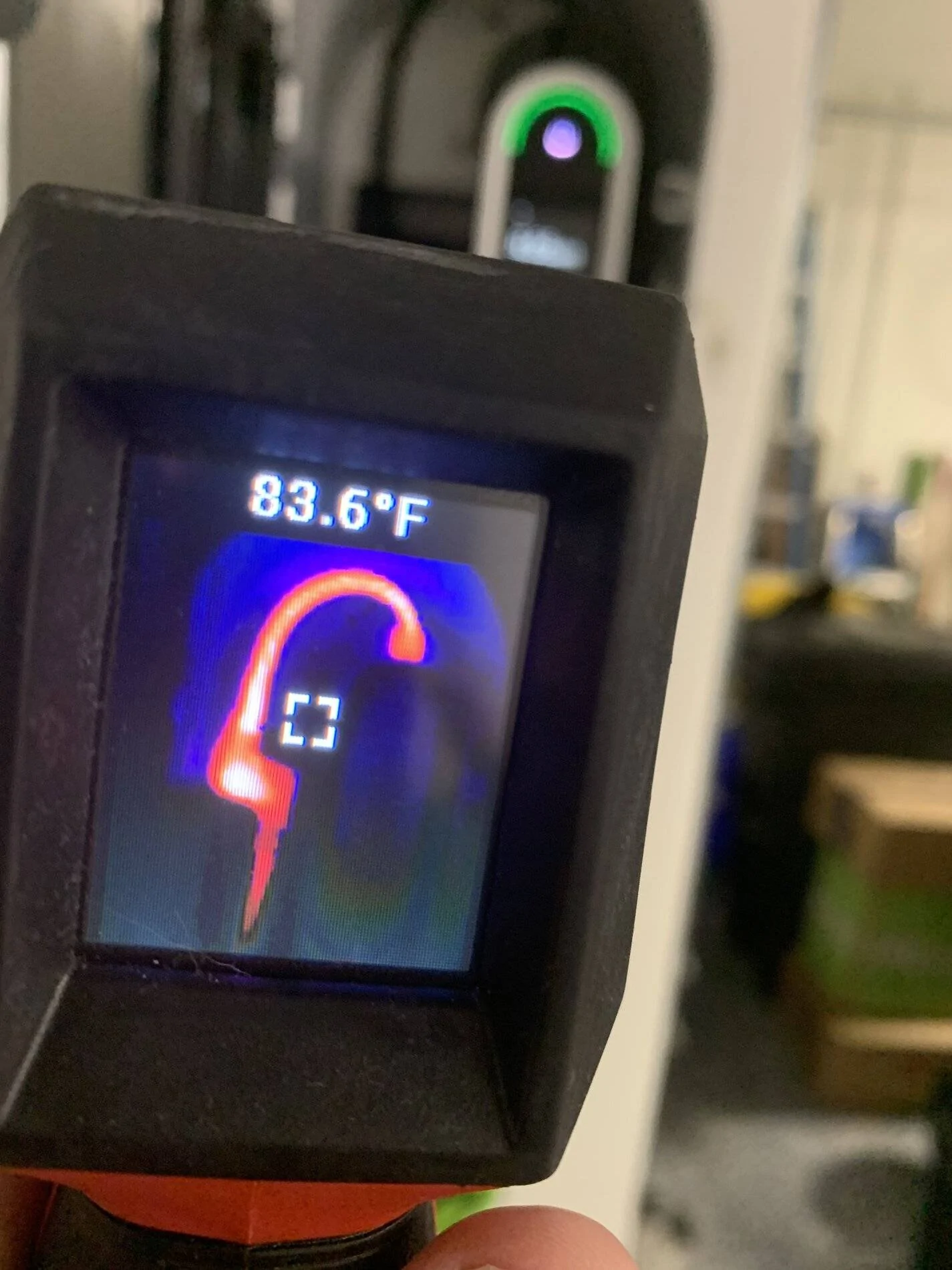

The same thing happened to me earlier this summer. Charger changed from green to red warning me about overheating.
Ironically, I had a water leak in the house that got a carpet wet. Went to Lowes and purchased a fan designed to move air and dry out the carpet - $100.00. Now that I have dried the carpet what am I going to use this fan for..............??? I laid the fan in its back so the air flow went up and put it underneath the charger. My garage faces west..........in Texas. No more overheating warnings. I charged the car earlier this week and after 5 hours of charging, all of the electric cords are cool, the charger is cool, and so am I!!!?. It's just one of those ironic things that happen to us. Same tool to dry the carpet can be used to cool the charger.
