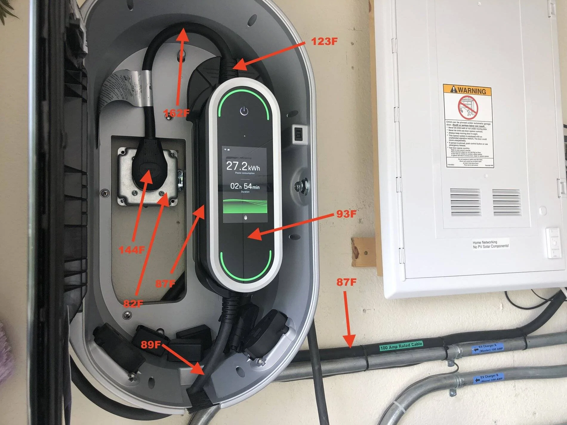

your understanding is mostly wrong - porsche is wrong and they are deflecting blame on the victim - the specs are necessary because Porsche mis-designed their power supply cable to run hotter than you'd drink your coffee - other EVSE's don't get this hot when running the same charging loads - in fact Porsche is the only EVSE in North America that runs this hot - the spec's mitigate Porsche's requirements to accommodate a product that runs 160F surface temperature in normal operation vs. competitive products that don't get much above 105F or even less in identical situations…
yes if you follow Porsche's specification their power supply cable will no longer melt the NEMA 14-50 socket it's plugged into - but it doesn't have to be that way - competitive products do not stress the NEMA socket as much as the porsche product…
following Porsche's specification does not change the fact that their product runs much much hotter than necessary - it simple means that their poor design will no longer induce failures in other aspects of the system - however if properly designed the porsche product would not have induced those failures in the first place.
also keep in mind it is they who released a tech bulletin and software update that basically nerfs their product to 50% of it's specified rate - and while you can override it - the PMCC will default back to the 50% rate after each power cycle…
personally I prefer an EVSE that runs cooler than 150F in normal/expected operation, doesn't require an indecipherable sticker, and doesn't obtain a surface termperature in normal operation that is considered officially scalding hot if water was the same temperature…
there is no reason Porsche needs their power supply cable to achieve temperatures of 162F in normal operation…other EVSE's that use appropriate wire gauge run much much cooler lessening the likely hood of melting the socket they are plugged into…
but yeah the Hubble NEMA 14-50 socket is ceramic vs. plastic so it can handle 160F+ operating temperatures which the Porsche EVSE commonly achieves in less than one hour of normal operation…so it's a great choice if you to pair it with an EVSE that doubles as a space heater/hot-plate.

while I'll take the rare internet "win" in this case - I believe the poster's original perspective demonstrates the effectiveness of Porsche's communication in this circumstance at pushing their narrative in this circumstance.
Porsche's narrative is:
Our EVSE is not at fault for achieving nominal operating temperatures of scalding 160F (or more) surface temperature - it's the customer's crappy infrastructure that is at fault. So please do not mix/match our excellent high thermal achieving high performance EVSE with your wimp-ass $12 leviton NEMA melty plastic socket - otherwise we can't be held responsible for our powerful and capable and flawless EVSE taxing your wimpy american residential circuit into submission - the NEMA socket melting is simply it's capitulation acknowledging the superiority of the power of German engineering that continues to dominate the world. Your socket melting simply proves you american's can not handle or compete with the glory that is German engineering and do not deserve to be in the same garage with the Taycan or it's flawless EVSE. Our 16 amp NEMA 14-50/6-50 power supply cable has been operating just fine with our 16/32 amp Hybrids and 918 spyder since 2014 [opps that's a 40 amp cable cause we updated the label in 2021 - our bad - honest it really really is a 40 amp cable, the previous labels noting it was a 16 amp rated cable since 2014 were all wrong, just wrong - it always was 40 amps - your label is just a printing error]
Porsche's EVSE Narrative is bit like Apple's iPhone 4 narrative: You're holding it wrong.
Porsche's version 2023: You're plugging it in wrong…
My Narrative is:
Why do none of the alternative J-1772 EVSE's I own never get much above 105F (or less) operating temperature running at identical 9.6 kW load capacities? And why haven't you, Porsche, distributed a new power supply cable better suited for 8+ hour loads at 9.6 kW that will not achieve nominal operating temperatures of 160F+ - why hasn't the cable originally distributed in 2014 for 16 & 32 amps loads with Hybrids and the 918 spyder been upgraded- would the extra $7 in 6 gauge wire makes your $3200 EVSE unprofitable? Vs. competitive products that do the same thing with out excessive operating temperatures for $200 retail? Is there not room in that $3000 margin for 16 inches of high quality 6 AWG cooper wire? Did your engineers miss the fact that EVERY EE engineering table produced since the 1950's shows a predicted temperature rise of 90F delta above ambient temperatures - which might lead to your EVSE being unique in the North American market place in that it doesn't play well with others?
Porsche's mastery of communication and leaning on their long standing engineering excellence reputation has gotten them through this mess - I would venture most of Porsche's customers believe their narrative - I personally find that unfortunate.
also keep in mind it is they who released a tech bulletin and software update that basically nerfs their product to 50% of it's specified rate - and while you can override it - the PMCC will default back to the 50% rate after each power cycle…but not the PMC+ - but I believe the PMC+ would also default to 50% if Porsche had the ability to modify it's firmware (which they don't) - so Porsche let's an indecipherable sticker stand in for their lack of a firmware update.
personally I prefer an EVSE that runs cooler than 150F in normal/expected operation, doesn't require an indecipherable sticker, and doesn't achieve an operational surface temperature in normal operation that is considered legally scalding hot if water of the same temperature was allowed to touch a child's skin…
there is no reason Porsche needs their power supply cable to achieve temperatures of 162F in normal operation in 65F ambient conditions…other EVSE's that use appropriate wire gauge run much much cooler decreasing the likely hood of melting the socket they are plugged into…
