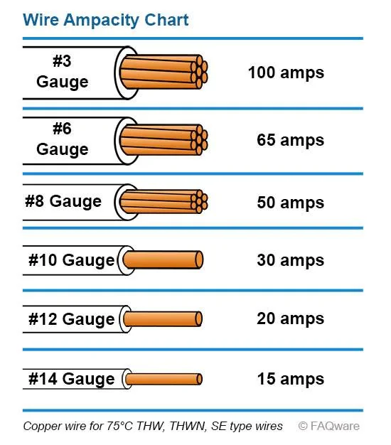

So for clarity, if you ran 6 gauge wire and the PMCC doesn't last, you can change the 50 amp breaker to a 60 and direct wire to one of the 48 amp chargers (direct wiring) and you can then increase the charge to 11Kw? Just wondering as I ran 6 gauge and am one of the few that is getting a No Charge PMCC from Porsche as we were in the build timeframe where they are honoring the no cost charger and are crediting my MSRP by the cost of the charger (see other thread).
Thanks Dave in advance.
160
5,810
8,648
yes 6 gauge wire will support 60 amp breaker 48 amp charging - so the swap/upgrade in the future from 50 amp breaker to a 60 amp breaker would _NO_ issue
NOTE: wire gauge requirement for XX amps vary by length of the run - so consult your local electrician for the “correct” gauge given the length of your particular “run” - my overall point is if 8 gauge is the requirement - then you might go bigger amp rating and request 6 or 4…but only your licenced electrician can advise you on the correct gauge wire for your particluar home and circumstance (not me or the internet) but once we’ve establish what is required, bump it up to the next or 1 or 2 gauges from the base requirement to provide some head room for the future.
there is _ZERO_ safety or performance issue with running a smaller breaker on higher amp wire
I’m a super big fan of pulling higher AMP wire and simply swapping the two ends in the future - the MAJOR labor cost _IS_ the wire pull - and it’s virtually no different to pull 4, 6, 8 gauge wire - might as well pull the highest quality highest amp wire - then in the future swapping a breaker can be a 20 minute DIY project...
