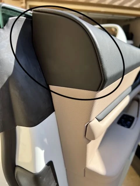

I just got my 2022 RWD and have a similar rattle from the front door, it is from the top area where the cover is, anyone has any idea if it is easy to remove this cover so can check where the noise is?
Porsche Taycan How I fixed the door rattles IMG_9263
Yes this cover comes out very easily with plastic pry tools. But you cannot remove it completely to drive the car without it because it has something like a plastic string to keep it together with the door panel.
Btw I also thought some of my rattles came from that cover but they didn't. They come from the panel itself. This area is where you push to open the door and the panel is too flimsy.

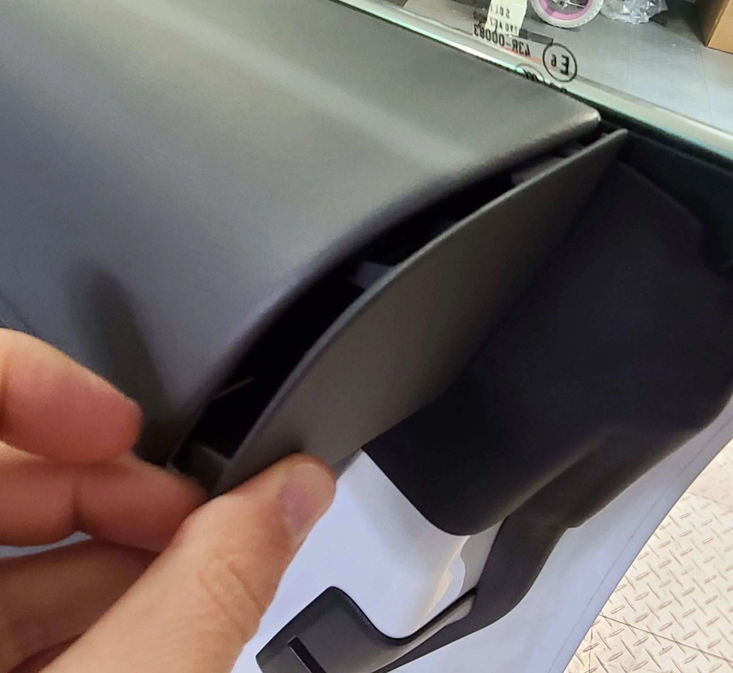

'22 RWD have a "ticking" sound on the drivers side door that seems to be coming from where the glass meets the upper weater stripping. This happens when riding on rough pavement. It's not loud and generalyy covered up by the radio. I have cleaned the glass and put silicone spray on the rubber, so far no help. Any suggestions?
I think I have the same sound. I jammed a piece of foam between the piece in the photo and the door, and it seemed to go away.
Porsche Taycan How I fixed the door rattles 1648100606851

Can you tell me how you jammed the foam in there? did you have to take off the door panel?
It's pretty easy to remove if you have some plastic prying tools, see @chrisk's post above. Like he says though, it doesn't come off completely because there's some sort of cable to keep it attached to the door but you can take it off far enough to stuff some foam in there
This didn't work for me so the rattling must have been coming from somewhere else. I asked my dealer to see if they could fix the rattling when I took my car in for a recall and they seemed to have solved it (for now)
