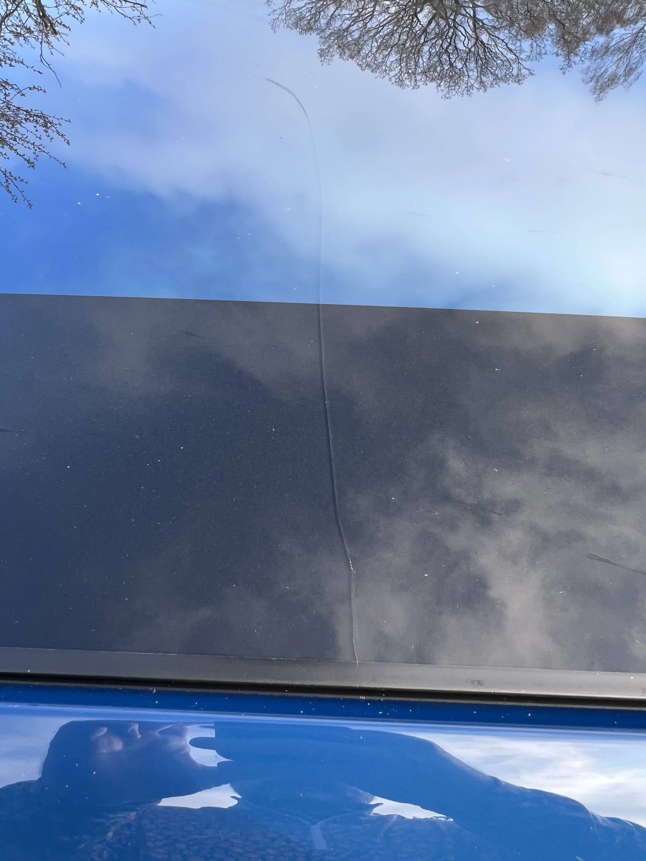

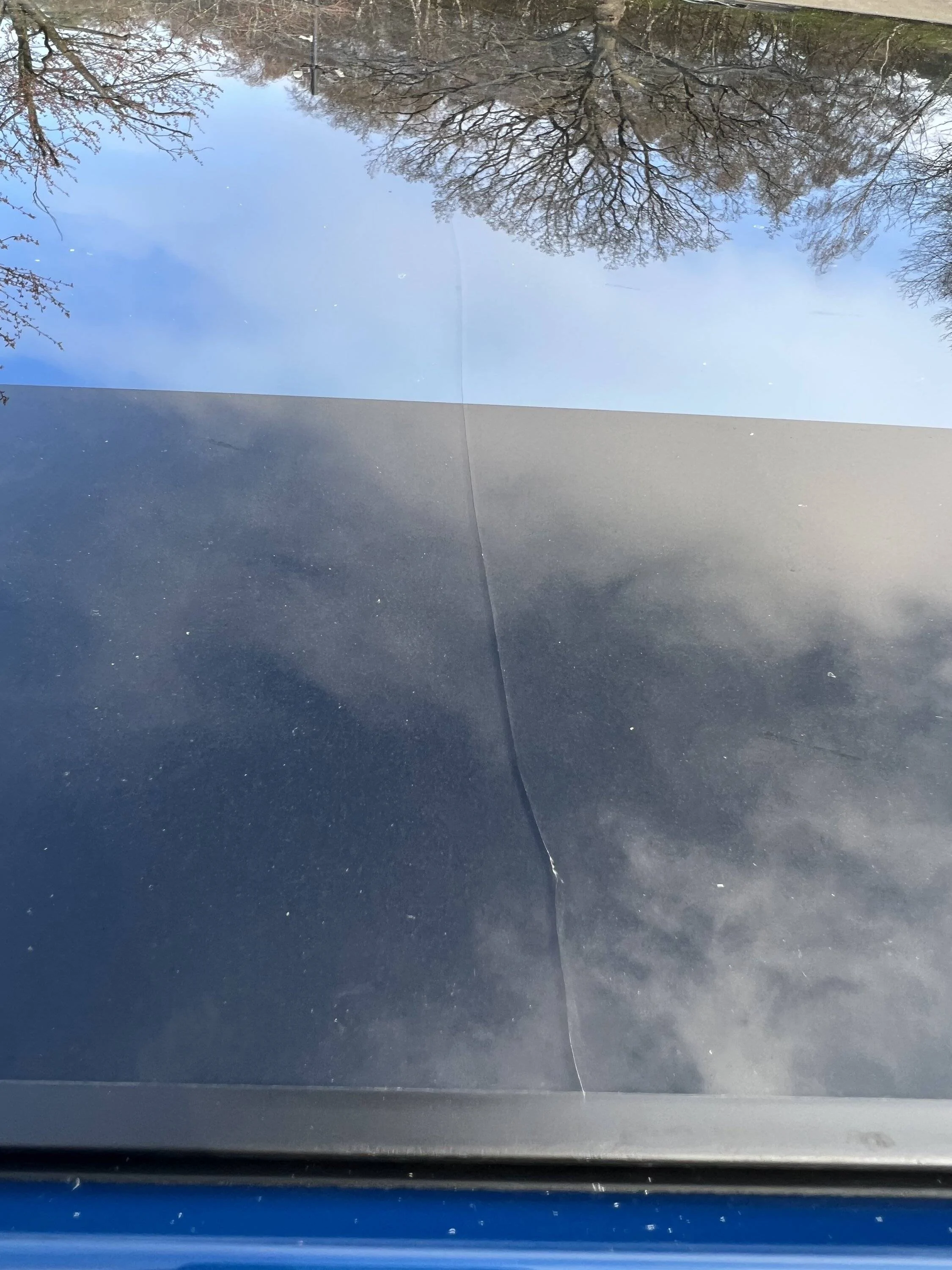

Add me to the cracked roof list. I have the VLC roof. 2 month old CT. 1,100 miles.
Crack was not there on Saturday at 5.30pm - my daughter and I were sat in a jam changing roof settings so we looked at the roof. 50 mile Journey home and then 5 miles to the golf club Sunday morning and showing a mate the car and we spotted it. Taking to the dealer tomorrow and will see what they say. Zero sign of any impact or chip. Absolutely no question this is a design fault.

This is the first vlc crack I've heard of. Congrats! And sorry! Best of luck with the dealer.

Thank you! Visited dealer this morning. They could not see any signs of damage causing the crack, so have taken photos and sent to Porsche UK to (hopefully) authorise the repair under warranty. They have seen a couple of these, all on the standard panoramic roof on CT's.

Latest update. Only two hours after seeing the car and sending photos to Porsche GB, I have been advised that replacement under warranty has been authorised. Expect to get the replacement roof in the next 2-3 weeks and apparently it is a 2 day job.
