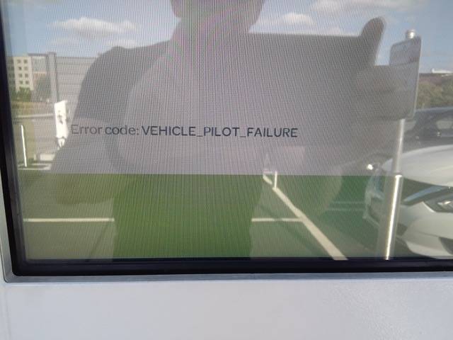

Well, not great news. Haven't fully diagnosed yet (since I've only tried the five cables at the Burlington, MA location), but:
Porsche Taycan Near disaster, but is it charger(s) or car? (UPDATE: it's the car) IMG_20200913_165101
Also got INTERNAL_VEHICLE_CHARGING_ERROR and TOWER_STOPPED_CHARGER.

Who knows, but my question is when you have a fault like that (with the red ring lighting up), is there a way to clear the faults “out in the field” or reboot the car so you can try to charge somewhere else? I realize everything is new and problems will happen. An early adopters, this is our risk. But, we should have a tech team to be able to call. Shouldn’t there be a 24/7 roadside assistance team for Taycan while there are bugs to be worked out? Unfortunately, I’m now not enthusiastic about taking this car on a long trip (which I really hate feeling that way). What do you think? Shouldn’t there be more of a 24/7 call line for Taycan emergencies?
This is, unfortunately, the problem. EA is very nice and all, but they don't seem to have any information. They have some things they can do (reboot chargers, remote start) and can see whether the charger is passing some internal diagnostic, and when the last succesful charge was, but when things go wrong...
Some of the chargers will give messages like the above, some just give codes. But neither gives actionable information, and EA cannot explain any of the messages.
Porsche support isn't available on weekends, and I'm not convinced they have any information either (certainly when I've talked to them before they haven't been very useful, even while being pleasant to deal with).
And the dealerships are still pretty new here, too: there hasn't been enough time and troubleshooting to really populate the knowledge base and systems necessary to truly know what's wrong.
Today, I drove out to a different charger and, hey, it worked fine. I'll try the Burlington charger again later to see whether it'll work. But I don't really know if it's the car or the chargers. It's more intermittent, though.

So, I went back to Burlington this morning, with a SOC of about 70%, and it worked fine. I'm going to run it down to 8% or so (which is where I was before) and see if that makes a difference...

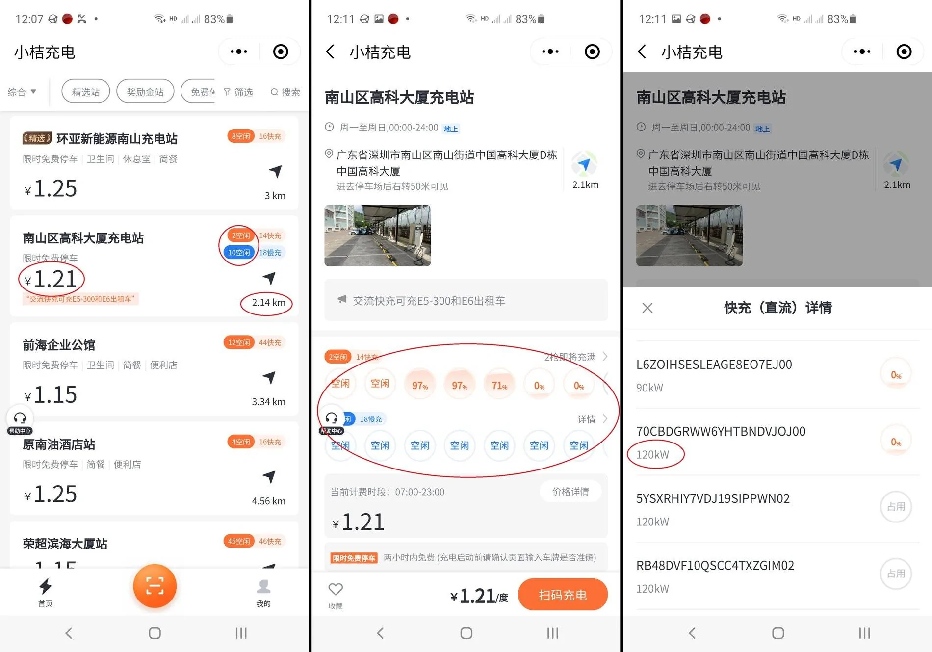

Nonsense! You load your phone with a couple of apps, so you know where you find all the charging options along the way. Her in China it looks like this:
Porsche Taycan Near disaster, but is it charger(s) or car? (UPDATE: it's the car) Screenshot_20200919-120731_WeChat
Red circles left to right:
Price 1.21 RMB is 0.18 USD per kWh
Amount of chargers not in use
2.14 km away from my current location
All the chargers and their SoC of connected vehicles
120kW max charging power
