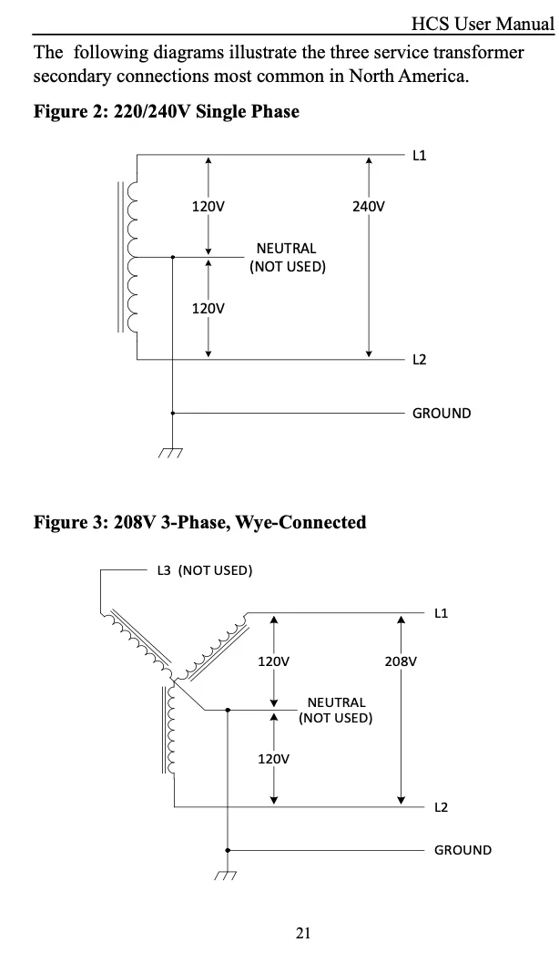

here is the wiring diagram from ClipperCreek for their HCS-60 EVSE - page 21 of the manual - note the picture clearly states
https://store.clippercreek.com/hcs-...906.1307337947.1596817371-62111800.1596666995
Neutral (Not Used)
in fact they even specify to _NOT_ connect the neutral
NOTE: …any two of the legs can be used to provide 208V to the HCS. For example, L1 & L2, or L1 & L3, or L2 & L3. Leave the unused leg open. Do not connect it to a Neutral bar, or to Ground. Be sure the center point is grounded to Earth somewhere in the system.

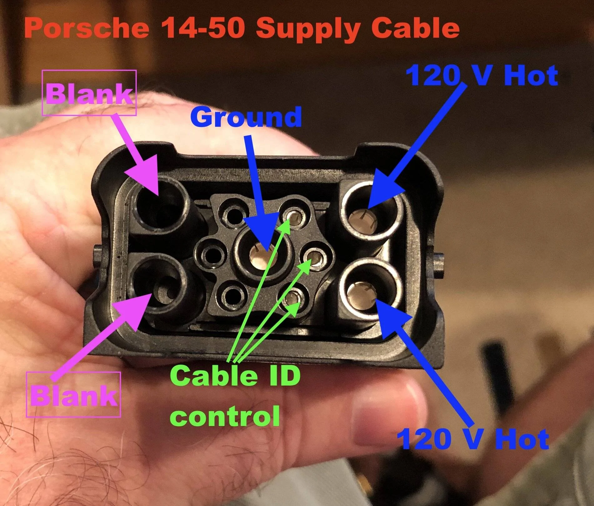

LOL - well all that proves is Porsche doesn't even know their own connector - I just checked my 14-50 Porsche supply cable - and it doesn't even have a conductor for the neutral inside the cable - annotated picture soon…

the Porsche EVSE supply cable does not even contain a wire for the neutral - like every other EVSE I've seen over the past 7 years…so it's BS if Porsche is asking for the neutral to be wired up - the inside of Porsche's OWN supply cable shows that to be simply a misunderstanding from the Tech's
the inside of the cable is pretty clearly optimized for 3 conductors (2 hots + ground) - I'm willing to bet there is _NO_ neutral wire even in the cable - the layout of the internals of the connector is pretty clear with some well educated speculation:
  • 4 possible "high voltage" conductors locations on the "corners" of the connector
    • 2 in this picture are "used" and big enough for 120 volts
    • 2 in this picture are "un-used/blank" - there is no wire here!!
      • one of them would need wire in this spot if the neutral was being passed to the PMCC - it's black - so the neutral has no connector in this cable.
  • center pin - ground
  • 6 "small" communication wires - I'm going to guess these are ID pins - the 5-15 supply cable has a different set with conductors - this is clearly a 6-bit binary pattern that the PMCC can use to identify which type of cable is installed and configure itself to "know" what type of cable it's using - 2^6 is 64 different possible combinations - and the software on the PMCC will use this binary pattern to identify the cable.
Porsche doesn't even wire up the Neutral in their own supply cable.
the Neutral is unused in EVSE applications.
