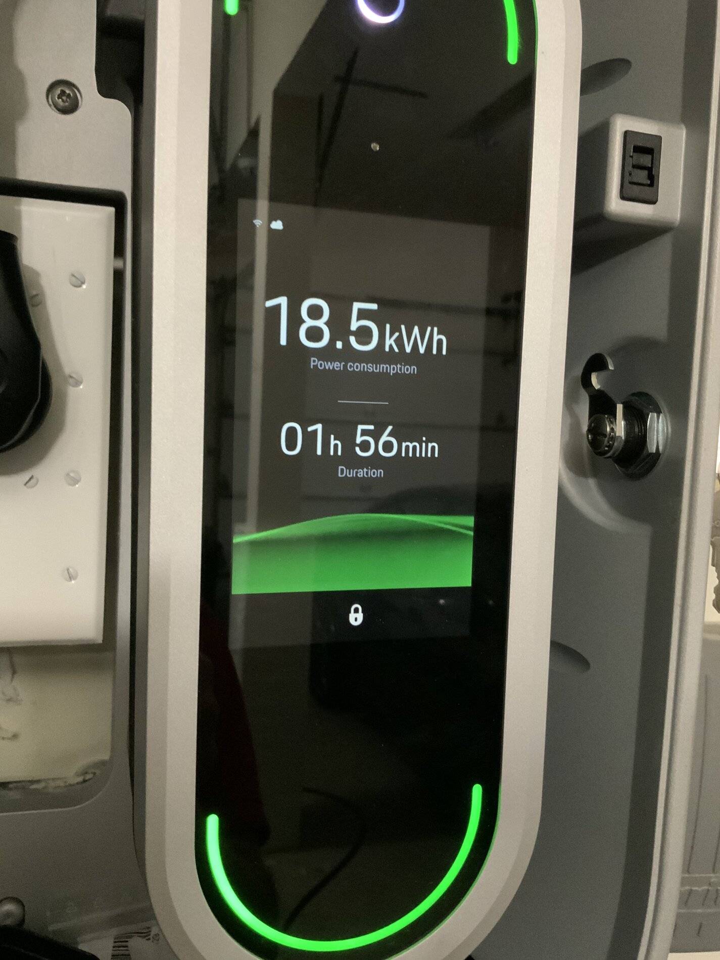

KenU - what does the PMCC report as the amp rate, and what does the car report as kW during the charging session?
I'd love to know your AMPs & Volts and with those two pieces of information we can work out your likely voltage.
since you now have 4 gauge wire to the NEMA 14-50 box - you can simply upgrade the breaker to 60 or 80 amps at the panel - and hardwire in a 60 or 80 amp ClipperCreek charger using the existing conduit/wire you've run for the PMCC.
This is what it shows now and at the beginning of the charging the amps were fluctuating between 39.8 and 39.7A. Is this what you’re looking for?
Porsche Taycan NEMA 14-50 Supply cable heat data AAF6FECD-FFEF-4FC4-9333-CBBA2F0D4D14
192
7,006
10,478
partially
during the charging session - the center console battery-charge UI can show either miles/min or kW
what is the kW during the charge cycle?
since
watts = amps * volts
if I have watts and amps I can do algebra and get an estimate as to the Volts ;-)
I'm wondering if your voltage is particularly "high" causing additional load on Porsche's under-spec wire.
