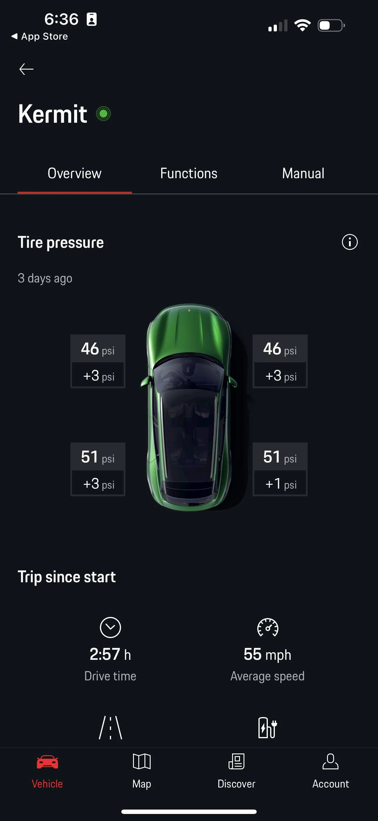

I haven’t noticed a difference. I do see something weird in that it shows different values for tire pressure overages for the rear tires despite showing them as having equal pressure. What gives?
Mine did that. I suspect it's something to do with the change using the actual pressures and the pressure gauges just showing rounded measures. That should just about account for up to 2 psi difference. But it's a bit silly.
Mine corrected itself when i went to the garage and checked them all etc on the air machine.
This happens in the previous version too. It's either a bug or the result of a very accurate measurement, which takes into account the difference in temperature between tires showing the same pressure. In fact the user manual (Good to Know) suggests to adjust the pressure based on the delta values rather then the pressure.

The different deviations on the rear tires are most likely because they were set differently in the system. You can set in the PCM what the "correct" pressure is for all 4 tires and then the app and PCM show the deviation from that "correct" pressure. So if you have the left rear "correct" pressure set in the PCM at 40 PSI and the right rear set at 42 PSI, if both TPMS are reading the actual pressure at 39PSI the left will show -1 and the right will show -3. Hope that makes sense.

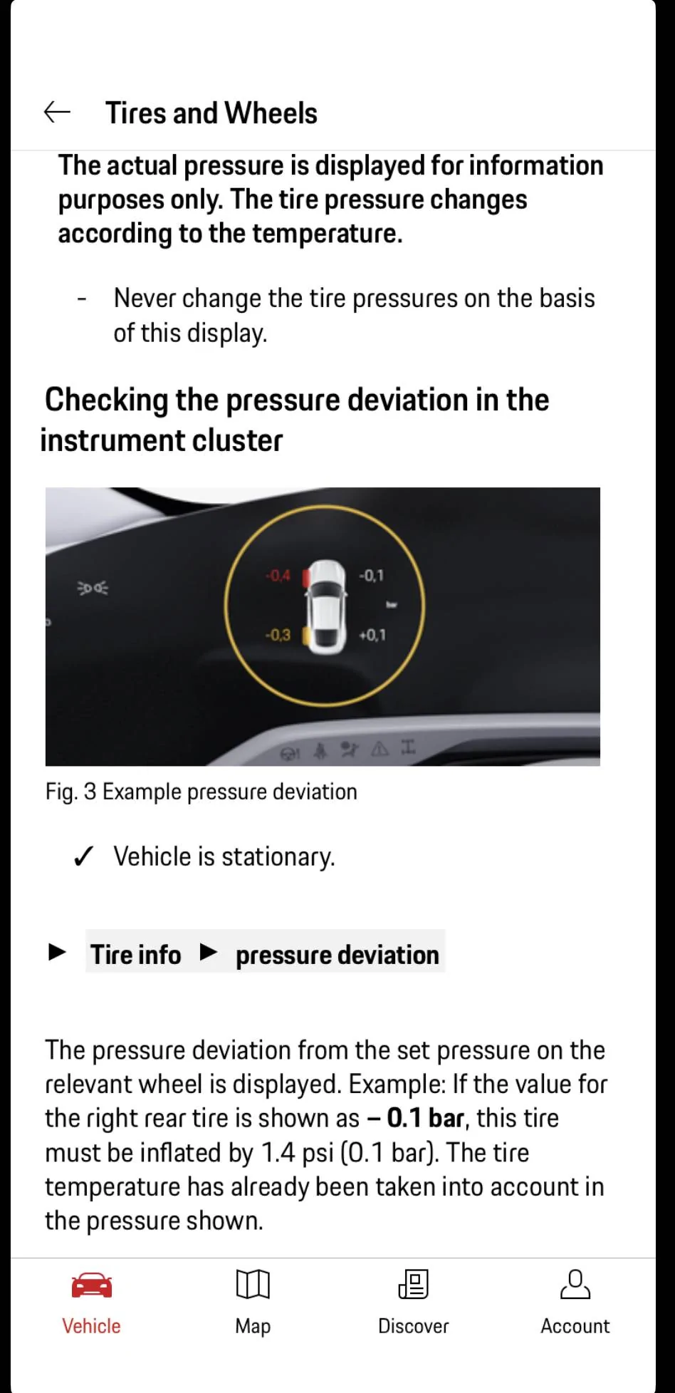

The above seems self contradictory. On one hand
Porsche Taycan New “My Porsche” app (6.0) released 1668203102719
but then
Porsche Taycan New “My Porsche” app (6.0) released 1668203134981
So according to the above you should inflate the tire based on the display, but don't change the tire pressures based on this display? How does inflating by 1.4psi not change the tire pressure?

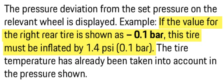

but then
My guess is ignore the 36psi and follow the +1.4. One is psi display and one is differential. Don’t follow psi.

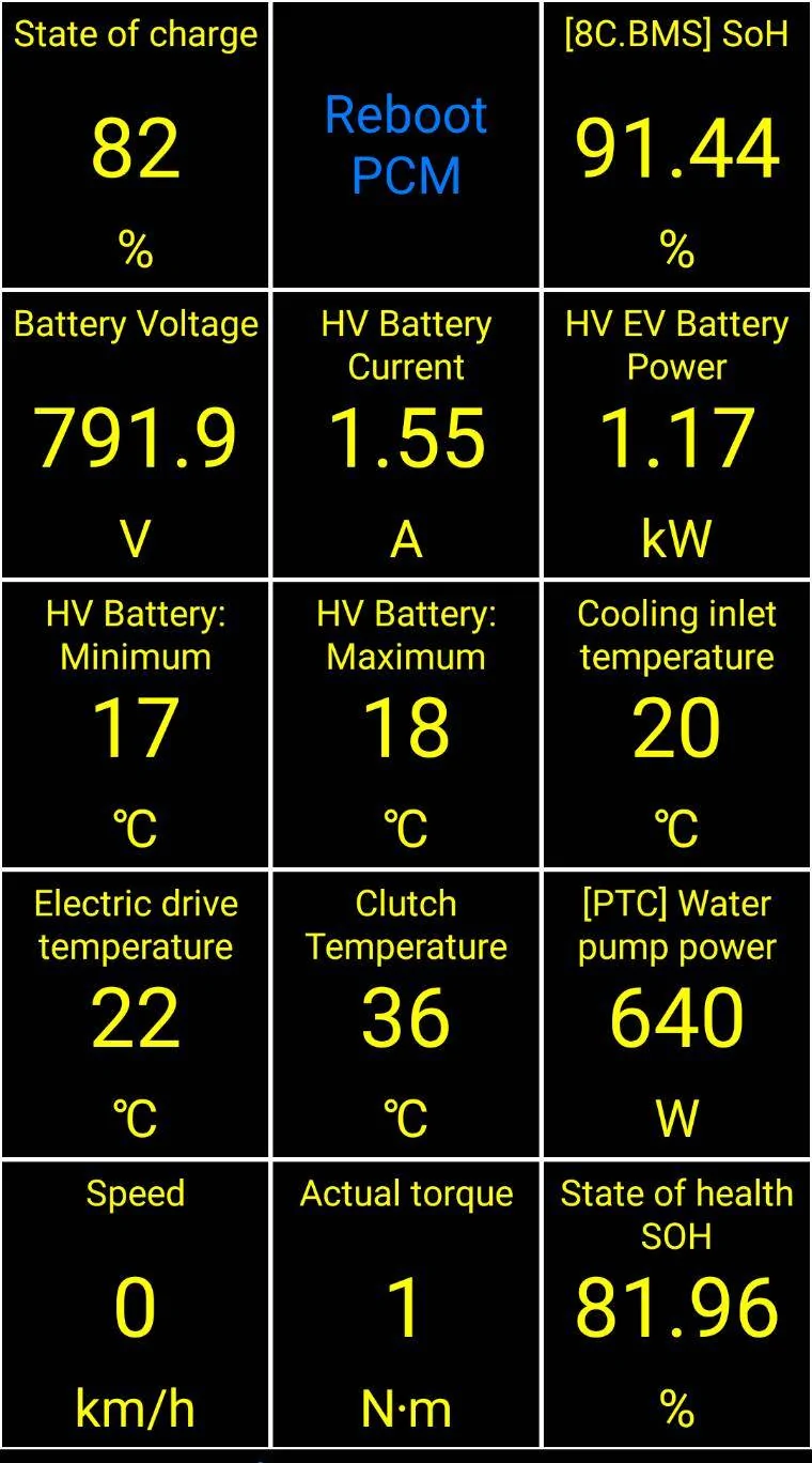

@Dee: SoH 81% only? How comes?
pEAkfrEAk
Feb 14, 2020
384
585
Germany
Porsche Taycan GTS [MY2023]
The SoH is 91.44% (see upper right corner). The value in the lower right corner is the SoC. The labeling is just wrong. It's a known bug.
