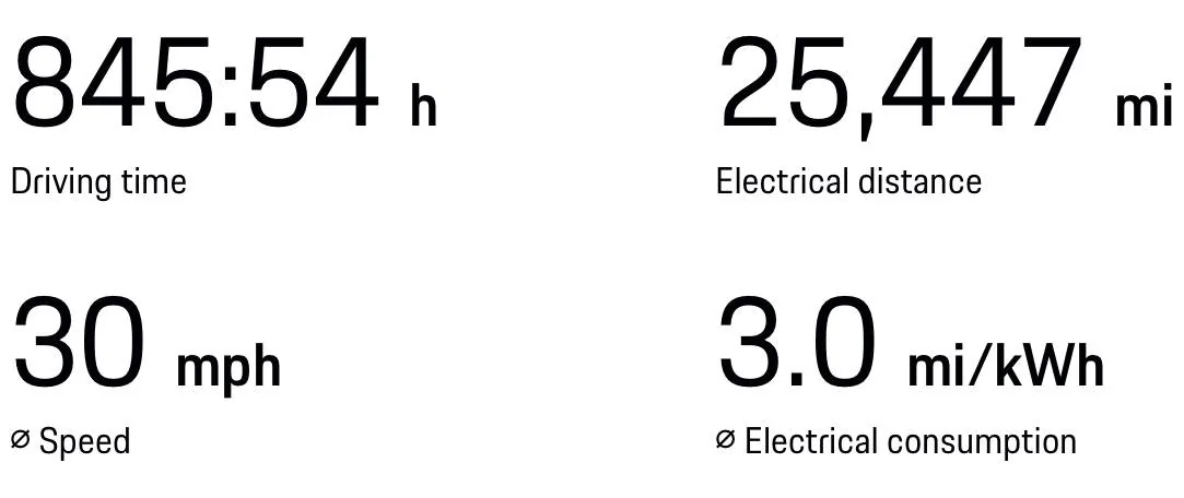

when driving my GT3 "normally" the gas tank gauge @ full shows 430 miles range
when driving home after one day @ laguna seca the gas tank gauge @ full shows 75 miles range
EV battery range is similar - it's based on "recent" driving consumption - and assumes it will be the same consumption going forward…this leads to wildly optimistic/pessimistic estimates…
you can however trust two things which are more difficult to consult:
trip computer and consumption - you should see 2.5 - 3.2 miles/kWh
enter a destination in PCM navigation and see what the battery estimates are at the destination (it's normally accurate +/- 3%)
ignore the "miles" shown on the dash or in the battery meter - it's like the range estimate on the gas tank on my GT3 - it's easily mislead and nothing to do with actual range you will achieve - your trip computer consumption "meter" will be a far more accurate estimator of your range.
if you want to go further - drive slower - it will increase your range…
here if my trip date for my 2020 Taycan Turbo - it's settled into about 3.0 miles/kwh for the last 25,xxx miles - you can expect similar or better numbers from a 4S - so unless you're getting below 2.5 or 2.4 miles/kwh - your 4S is fine…
also trust the miles you can actually drive - vs. what the dash board is showing you - remember my GT3 can only go 75 miles on a _FULL_ tank of gas according to the same sort of estimate after a day at the track - this is grossly wrong for normal street driving…and show how ridiculous these sorts of estimates can be.
Ok this makes sense. Thank you. I had been driving mostly very sedately and so I suppose I was expecting a full charge to show more range but will check the above (thanks for guidance) and then be patient and stop panicking!
