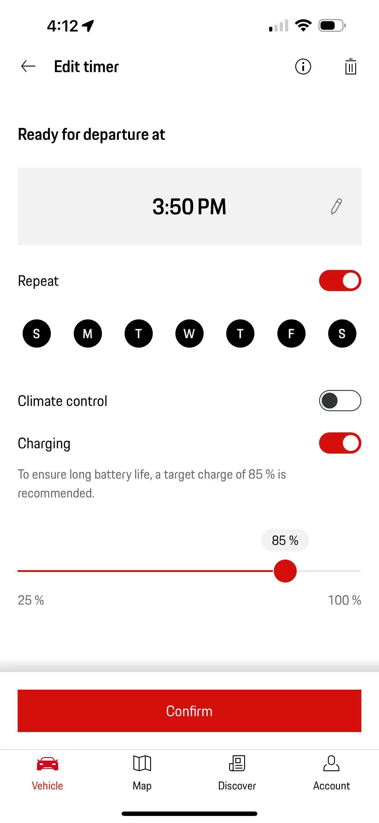

I have a timer set to finish charging at 3:50pm, 85%

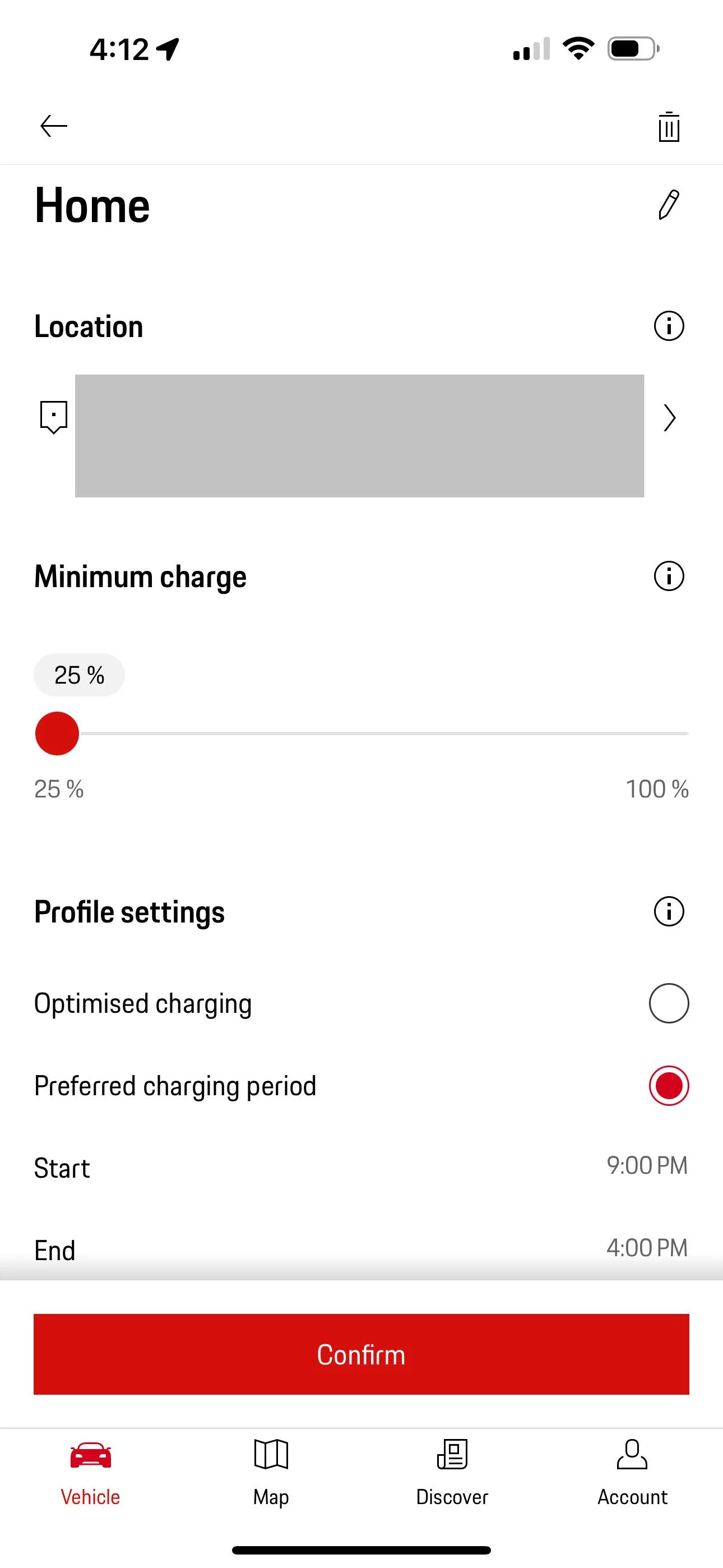

I have a profile set to only charge form 9pm-4pm (ie don't charge from 4pm - 9pm as TOU rates are very high and I charge when my solar is in max production).
Normally, the car starts charging whenever it needs to, and finishes about at 3:50pm No issue.

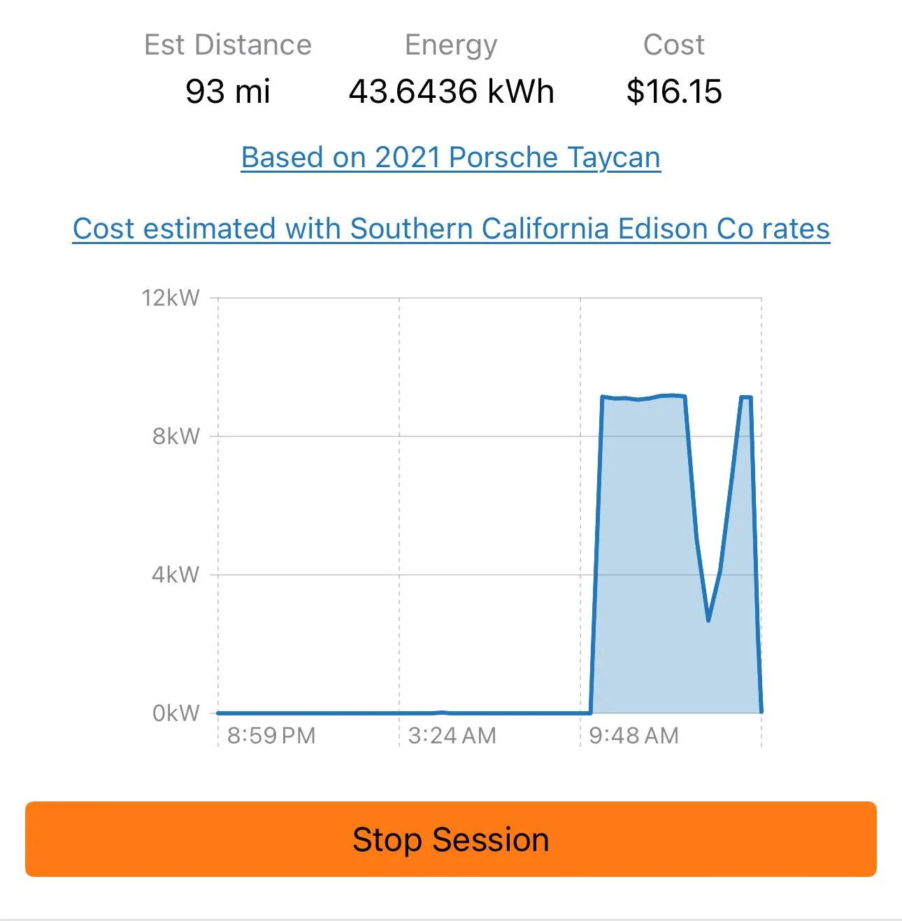

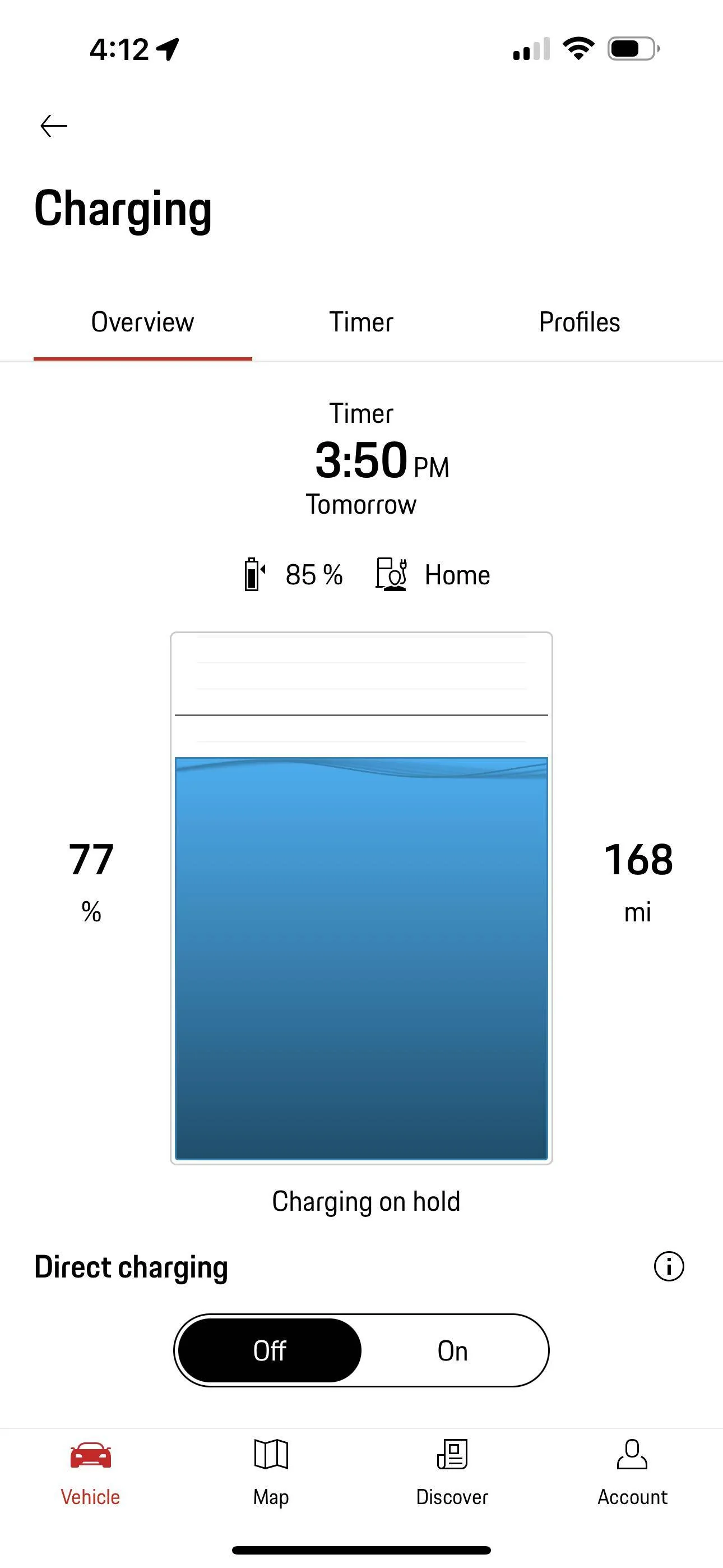

Today: the car starts to charge at about 10am. It's charging at full rate. Then after 3 hours about 1pm, it DROPS the charge rate to 2.2kwh (it never stopped charging). And sits there for about an hour. Then at 2pm it starts charging at full rate again until 3:50 when I get a message from the porsche app "can't meet charge target" and the car stops charging at 77%. The timer then turns blue and the charge is "on hold" This is all in the graphs on the CP app.
Essentially it seems the car started to regulate the charge rate for some reason and then it missed the charge target.
The car has NEVER done this before. I can set "direct charging" on right now and it will charge at full rate.
