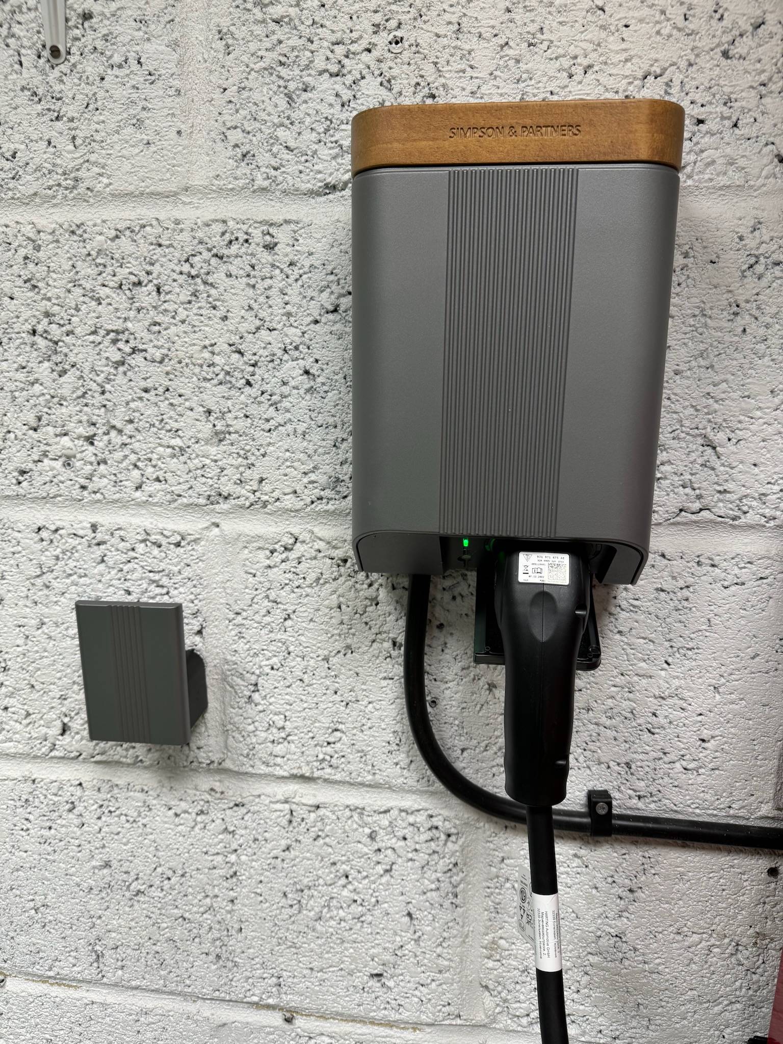

I wanted a charger that looked good, because many look like ugly lumps of black plastic to me.
Andersen's product looks good but they went bust briefly last year so I was nervous of trusting their ecosystem (since if their servers go down their chargers are effectively disabled). Andersen's original founders and designers had been forced out of the business well beforehand and already set up a second company, Simpson & Partners, also making a stylish wall box available in a range of colours to match my property. S&P's chargers can operate via Bluetooth to your phone as well as via their servers over WiFi, so if S&P's servers have a glitch or are shut down the box still works. This appeals to me a lot more so I went with that and don't regret it at all.
The only thing the S&P box doesn't have is in-box cable/plug storage, but I plug my Taycan in so often that this would probably be more of a hassle than it's worth.
A downside of Simpson & Partners I've discovered is that it's not yet compatible with Ovo's Anytime cheap EV charging service. I hope it will be soon though.
Hope you're pleased with your Taycan when you get it, OP!

I use an S&P Home7Plus EVSE with OVO Anytime connecting directly to the car. This relies on connectivity between OVO Anytime and Porsche servers and the car. Such connectivity is notorious for being somewhat flakey. I’ve had instances where the car has not charged at all by the required time and other instances where it has charged to 100%. Mostly, it charges to somewhere close to the request % by the desired time.
I spoke with S&P about adding integration with OVO Charge Anytime into their EVSEs last year but they said they had no plans for this. Since then I noticed that they do now have Octopus integration.
Otherwise, the S&P EVSE is nice and small and their app seems good too. They have support for load sharing (which I need for my 60amp fused house) and also solar integration both at additional cost. They are definitely not the cheapest EVSEs on ten market.

The S&P I have is untethered. However, you can lock the cable to the EVSE via their app. It keeps the lock pin engaged in the EVSE/cable even when the car end of the cable is unplugged or the car is not charging. I think untethered EVSEs are better because you can easily replace the cable when it or the plugs get damaged or you need to lengthen or shorten the cable.
Porsche Taycan Newbie - any home charger recommendations? IMG_4328
