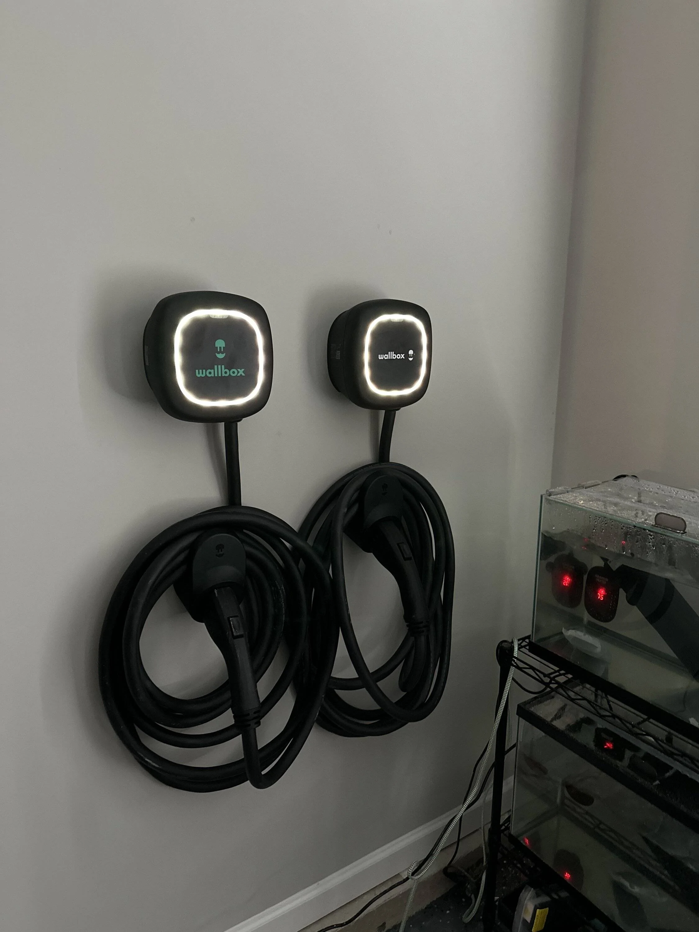

Sorry, but what on earth are those electrified fish tank things!?
And so not a complete thread hi-jack, I have the pulsar wallbox too (just 1 though) and think it's very good.
