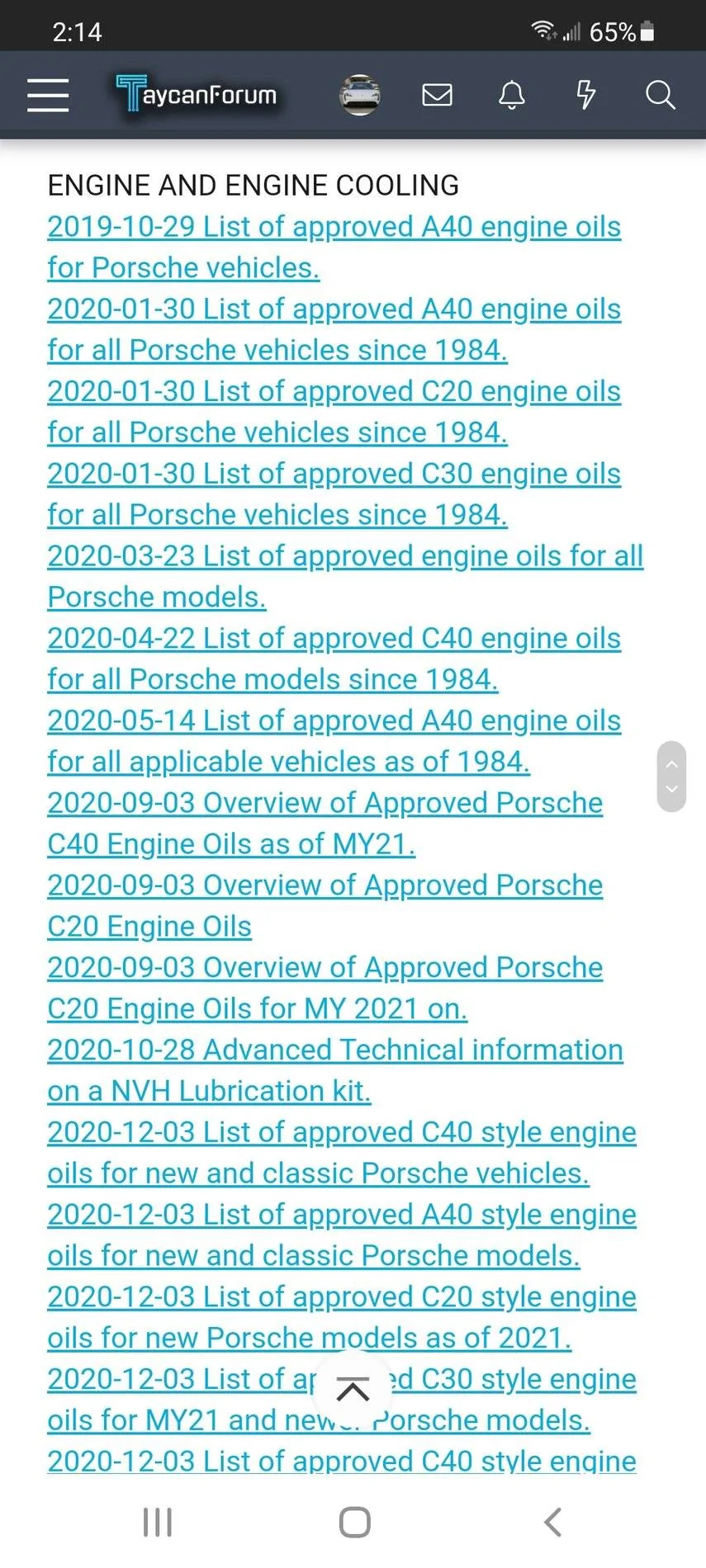

ENGINE AND ENGINE COOLING
2019-10-29 List of approved A40 engine oils for Porsche vehicles.
2020-01-30 List of approved A40 engine oils for all Porsche vehicles since 1984.
2020-01-30 List of approved C20 engine oils for all Porsche vehicles since 1984.
2020-01-30 List of approved C30 engine oils for all Porsche vehicles since 1984.
2020-03-23 List of approved engine oils for all Porsche models.
2020-04-22 List of approved C40 engine oils for all Porsche models since 1984.
2020-05-14 List of approved A40 engine oils for all applicable vehicles as of 1984.
2020-09-03 Overview of Approved Porsche C40 Engine Oils as of MY21.
2020-09-03 Overview of Approved Porsche C20 Engine Oils
2020-09-03 Overview of Approved Porsche C20 Engine Oils for MY 2021 on.
2020-10-28 Advanced Technical information on a NVH Lubrication kit.
2020-12-03 List of approved C40 style engine oils for new and classic Porsche vehicles.
2020-12-03 List of approved A40 style engine oils for new and classic Porsche models.
2020-12-03 List of approved C20 style engine oils for new Porsche models as of 2021.
2020-12-03 List of approved C30 style engine oils for MY21 and newer Porsche models.
2020-12-03 List of approved C40 style engine oils for MY21 and newer Porsche models.
2020-12-23 Instructions for replacing the DME in the Taycan.
2021-03-05 List of approved C20 engine oils for all new and classic Porsche models 1984 and newer.
2021-03-05 List of approved C20 engine oils for all new MY 2021 Porsche vehicles.
2021-03-05 List of approved C30 engine oils for MY 2021 Porsche vehicles.
2021-03-05 List of approved C40 engine oils for all MY2021 Porsche vehicles.
2021-03-05 List of approved C30 engine oils for all new and Classic Porsche vehicles MY1984 and newer.
2021-03-05 List of approved C40 engine oils for new and classic Porsche vehicles MY 1984 and newer.
2021-03-05 List of approved A40 style engine oils for new and classic Porsche vehicles MY 1984 and newer.
2021-03-26 List of approved C30 style engine oils for new Porsche vehicles.
2021-03-26 List of approved C40 engine oils for new Porsche vehicles.
2021-03-26 List of approved C20 style engine oils for classic and new Porsche models since 1984.
2021-03-26 List of approved C20 engine oils for new Porsche vehicles.

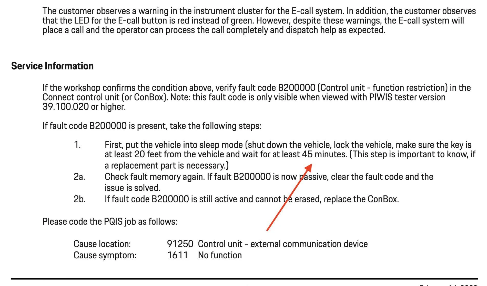

2020-02-07 Instructions for fixing the customer complaint that their Taycan is not charging.
2020-02-14 Instructions for fixing the fault code B200000 on the new Taycan. The fault is for the E Call warning.

He even posted links to approved engine oils for Porsche engines ?which I know are posted on NHTSA for all Porsches but I would expect any Taycan owner who know that Taycan does not need engine oil and they wouldn't include those links.
Of course I know, I will filter out engine oil text from now on, as more or less requested :p
