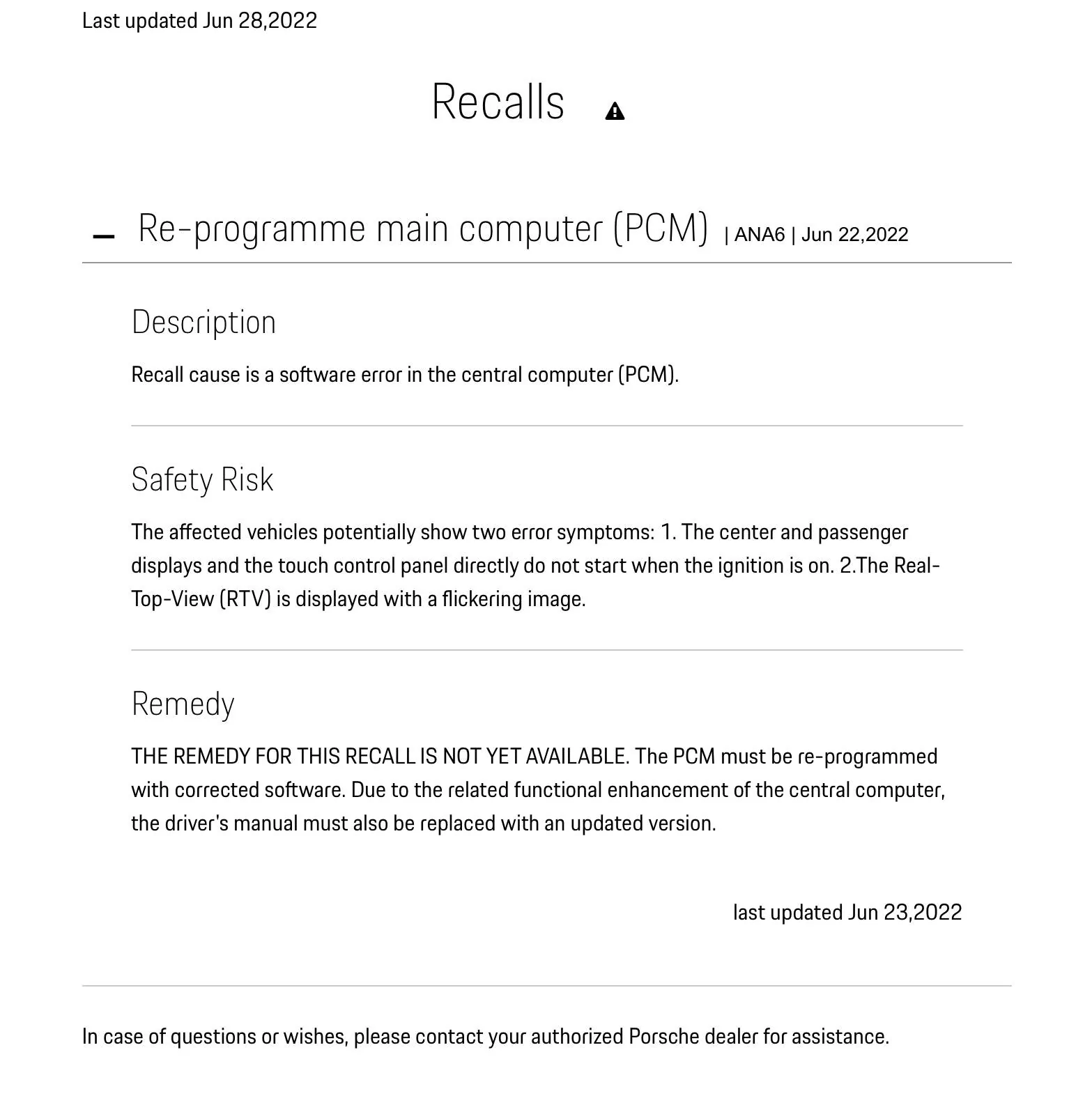

Please detail ANA6 when information is available. It's about blacking out PCM screens and is a stop-delivery on my car.

I checked the Porsche recall Vin link and my 2021 4S needs the PCM update. Here is info they provided!
Porsche Taycan List of updates / campaign numbers for Taycan D1A2ABA2-B563-4DF2-9FB9-4F3D6D24ECE5
