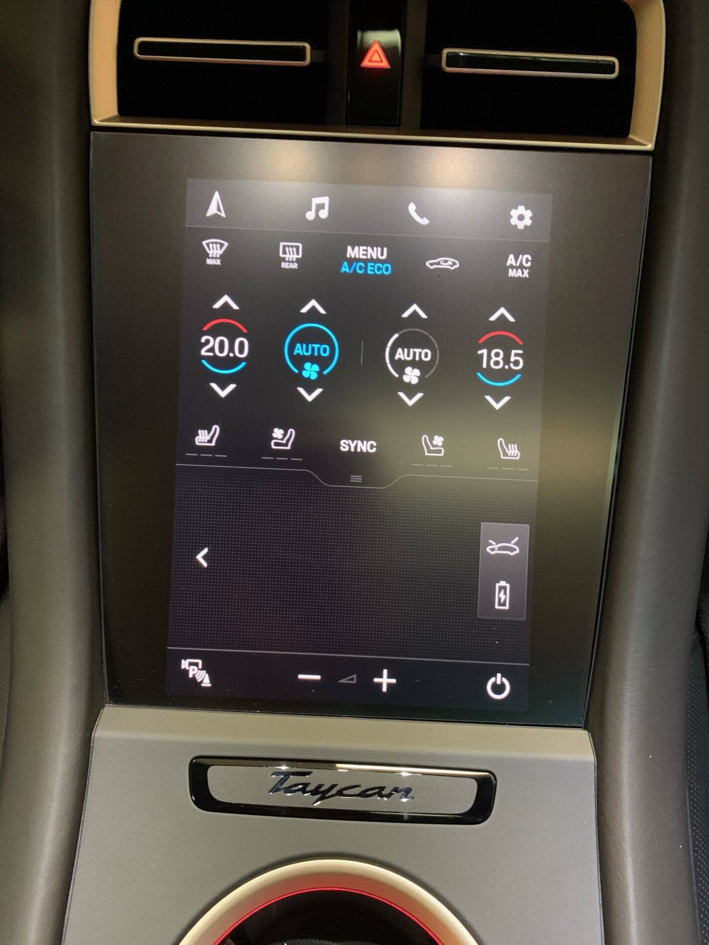

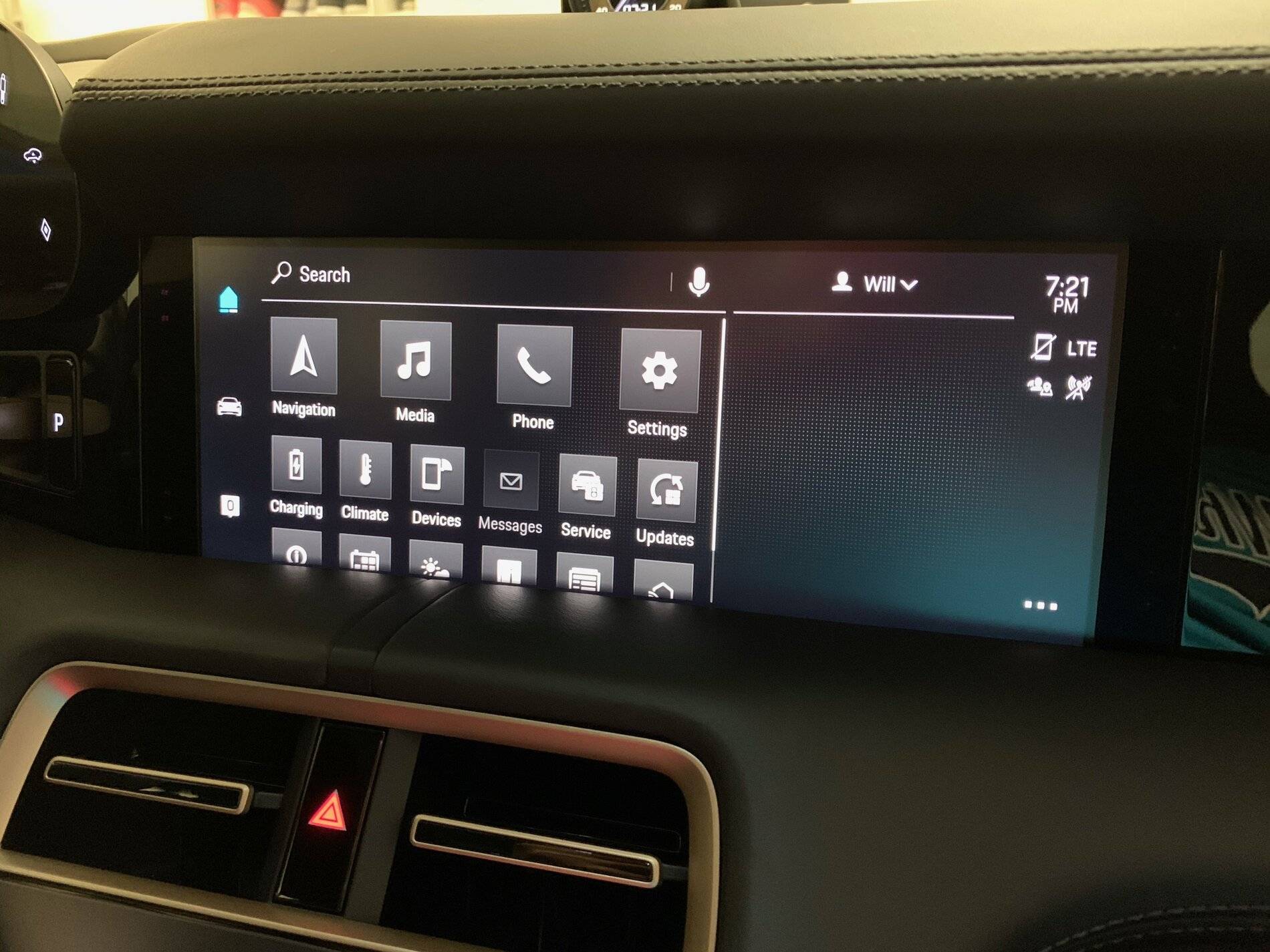

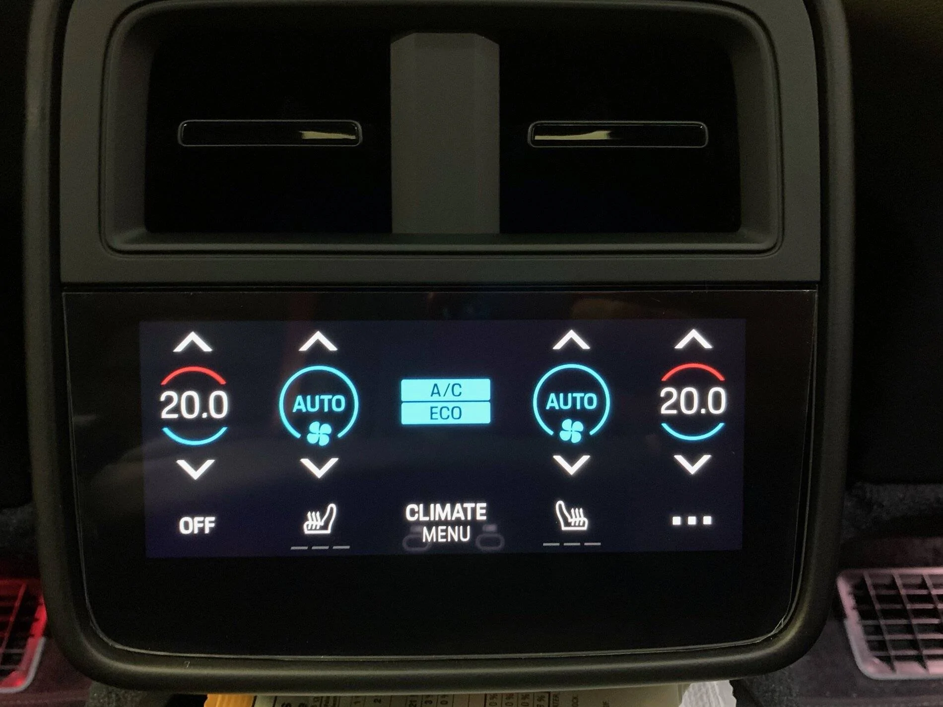

I managed to use the two pieces to cover the center console, main screen, and rear screens. And yes, it is large enough to cover the entire area on the center console. However, for the main screen, I cut it so that it covers just the display area, not the entire screen surface.

How did you cut the film to the center console? Did you pre cut it and the put it on?
Or did you carefully cut it along the edges after putting it on the screen?
Measure the trapezoid dimensions, and pre-cut with an exacto-knife. The sides are straight. If you are in doubt of your measurements, cut a piece of paper first to test-fit, which you can then use to cut your film.
However, the rear seat screen is NOT a straight-edge, as I found out the hard way!
