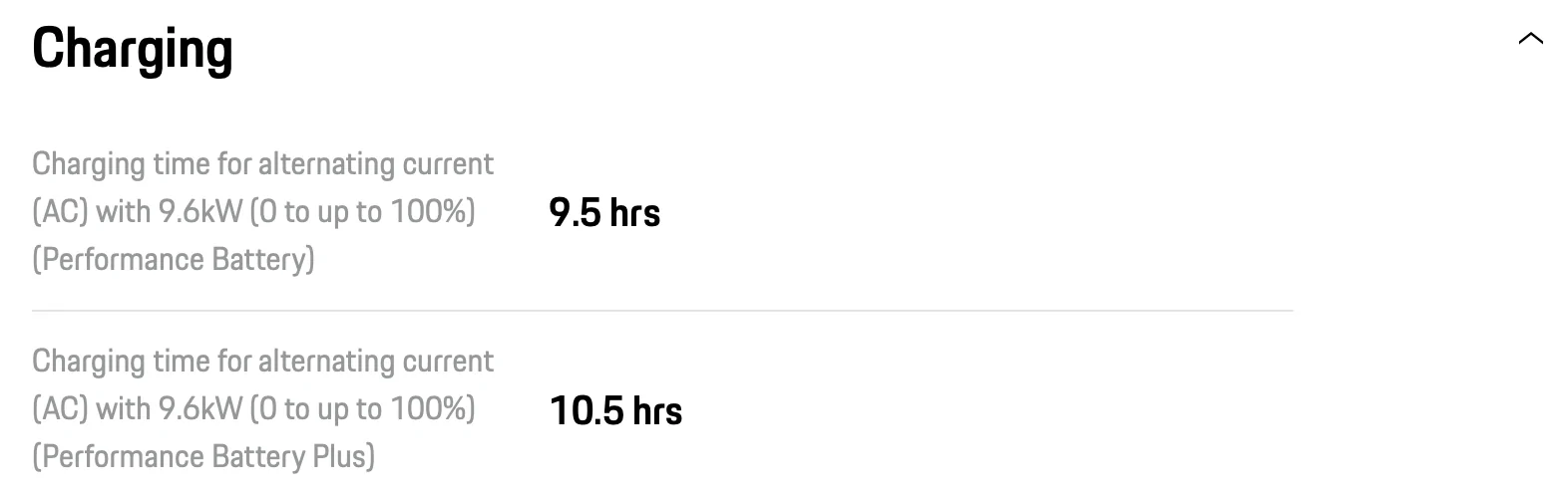

ummmmm - another case of Porsche being conservative with their specs…my 2020 Taycan charging in my garage…Porsche's official specs indicate 9.6 kW maximum charge rate (40 amps)
https://www.porsche.com/usa/models/taycan/taycan-models/
Porsche Taycan Observed Behavior: North American 2020 Taycan has max 11 kW L2 charger (48 amps) not max 9.6 kW (40 amps) Screen Shot 2020-07-13 at 9.37.36 AM

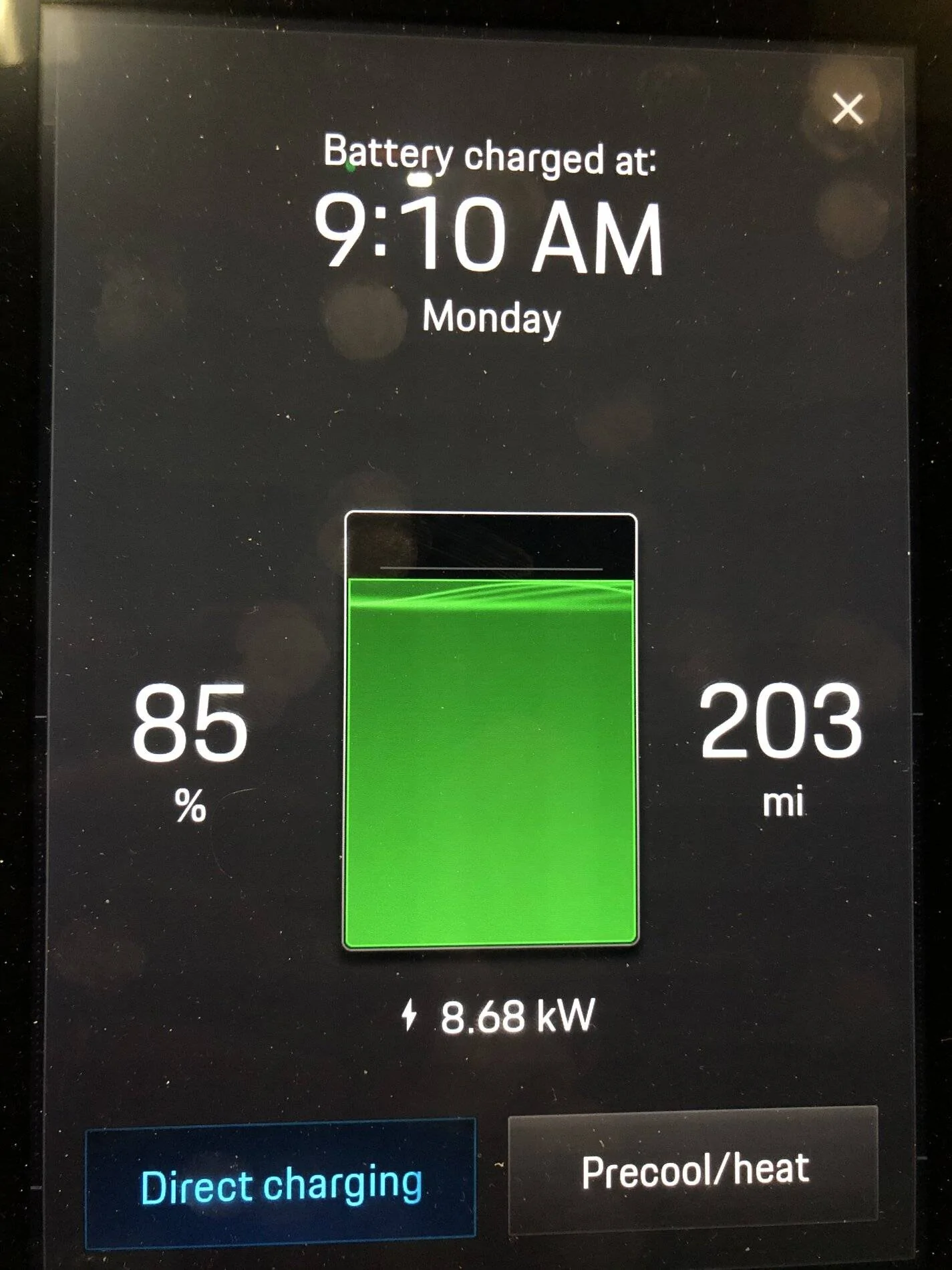

1st picture below shows that Taycan charging from the Porsche Mobile Connect charger plugged into a NEMA 14-50 plug - 8.68 kW as expected from a 9.6 kW 40/50 amp circuit - car charged last night as expected no problems…

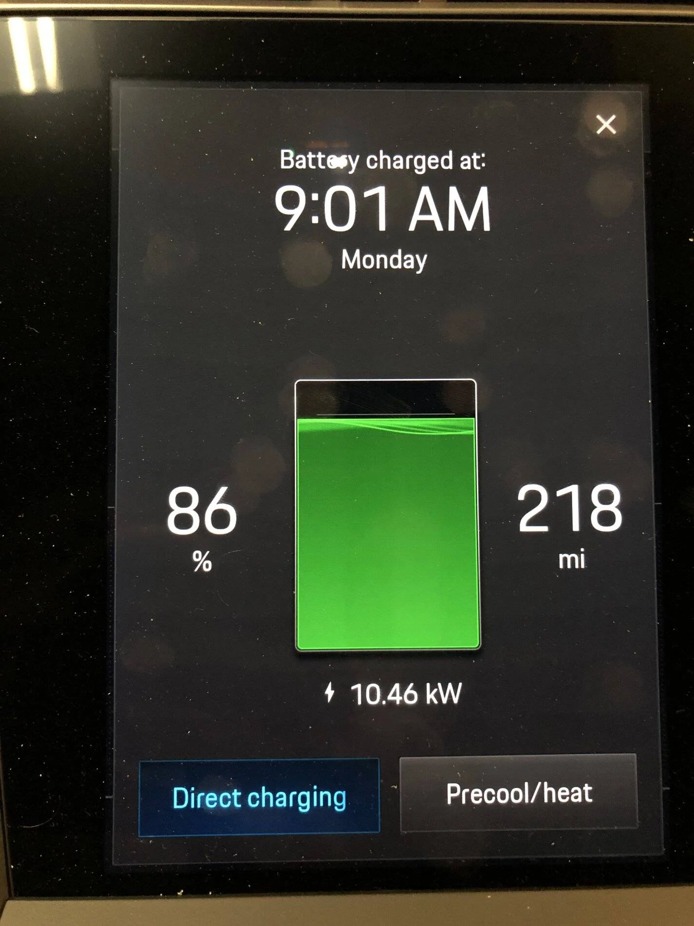

woke up this morning and decide to play around - I'm a long time EV owner and Tesla owner and I have a multi-charger shared circuit Tesla L2 charging setup in my home (4 chargers "sharing" a 100 amp circuit - 80 amp maximum charge rate)…
So I got out my JDApter and plugged in the Taycan to charge - I know this works from various test drives - but I never paid attention to the actual charge rate…
ummmm based on this picture my Taycan has come with a 11 kW (48 amp) charger just like in Europe…note the 10.46 kW charge rate listed below when it's plugged into my 80 amp Tesla Wall charger

However my observed charge rate from my Tesla Wall Chargers with my 2020 Taycan shows pretty clearly it's an 11 kW charger for L2 charging…

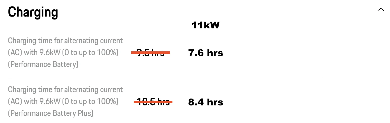

hmmm - update the Porsche spec's page? :rock:

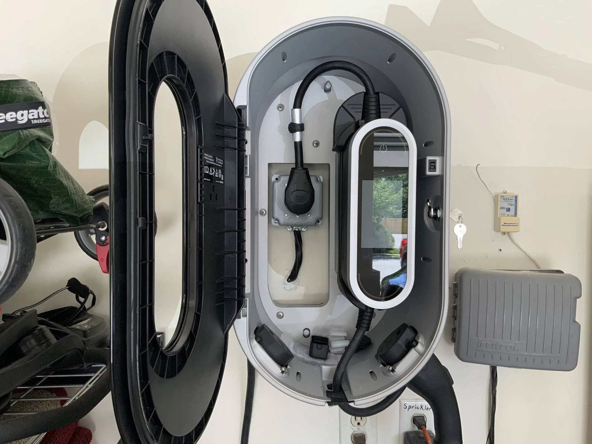

I’m just wondering why, after getting the right 14-50 NEMA plug and installing a 6 gauge wire with a 50 amp breaker, is the plugs’s cable so damn hot after even 45 minutes or so? I know the cable to the car gets warm but the 14-50 plug’s cable gets really hot, to the point where if I squeeze it pretty hard I almost, but not quite, have to let it go. Oddly though, after a coupla hours, that cable is not as hot as it was after the 45 minute mark. Still very warm but not hot to the squeeze. The 6 gauge wire is always warm but not hot, per se.
All this electricity stuff is just plain weird, but also has me a bit concerned if this is normal or not. I can’t imagine letting this charge overnight with wires generating this amount of heat.

This is my set up, professionally installed by my 35 years-in-the-business electrician . Anything amiss here?

Looks like a very good installation in the picture. When you say the cable from the wall outlet to the charger gets very hot, how about the plug itself? Is there something not quite right with the plug?
Second question. The cable that is going to the car, do you unwind that completely Or are there still a few turns around the charging dock? Since there is AC going through that cable can that induce some effect on the lead? I only know when I use my extension lead with my pressure washer that I need to unwind it all or else it gets very hot.

Thank you for your response, Peter. The first 2 sentences of my post say "the plug's cable". The cable you see in the photo that's part of/connected to the plug, going around on top - into the charger - that's the cable that gets extremely hot. Not the wall outlet wire. The plug itself does get very warm also but not as "hot" as the plug's cable.. And yes, the cable to the car is completely unwound when connected for charging.
It may be worth to ask you electrician to check the cable and see if there is a problem in the cable. Maybe manufacturing fault or damaged somehow. I am really surprised that your cable gets very hot quickly and it then settles down and gets lower? I would have expected the other way around.
You may also talk to your Porsche dealer and see if they could lend you another cable with plug for you to test.
If everything is done and designed to the correct standards, which I believe it is, it is strange.
Hope you find a solution!
@KenU and I are experiencing the same situation with the similar charger and charging dock installation. But last night while charging I checked Connect app to see SOC after about 2 1/2 hours and it said charging error. I had not seen that before so went out to garage and sure enough there was no power to Mobile Charger Connect. Checked the circuit breaker and it was tripped. Breaker was also very warm to the touch so it did its job but don't know what would have caused it to trip. I had electrician come back out previously to double-check install and he said everything looked good, so now I have to wonder if the Mobile Charger Connect is a problem or the cable itself. Anyone have any insights or suggestions?
