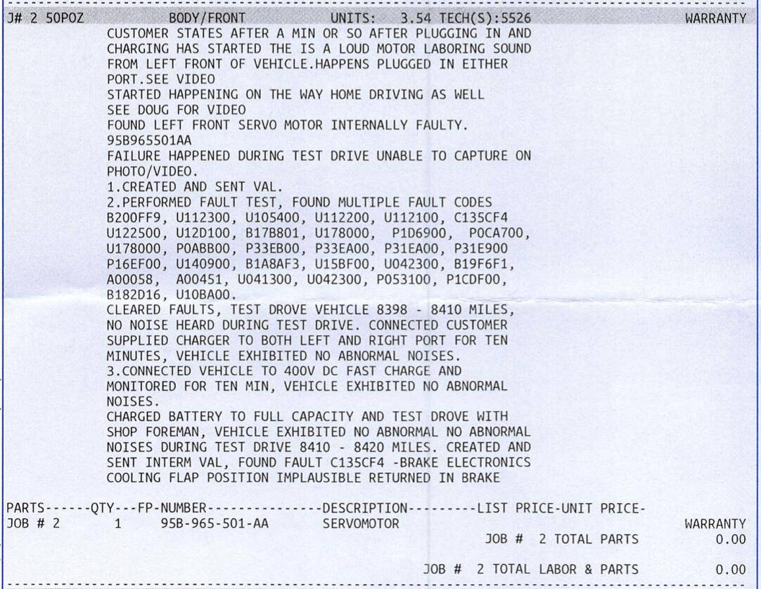

I had a similar sounding problem at the end of May on my MY20 Turbo. It was diagnosed as a "servo motor faulty". They replaced under warranty. Here's the description from my service receipt. Even though it talks about having the problem when plugged in, it was also happening when it wasn't plugged in.

Cooling flap position implausible fault in the brake electronics: Is the brake cooling integrated with or separate from the battery and AC cooling loop?
