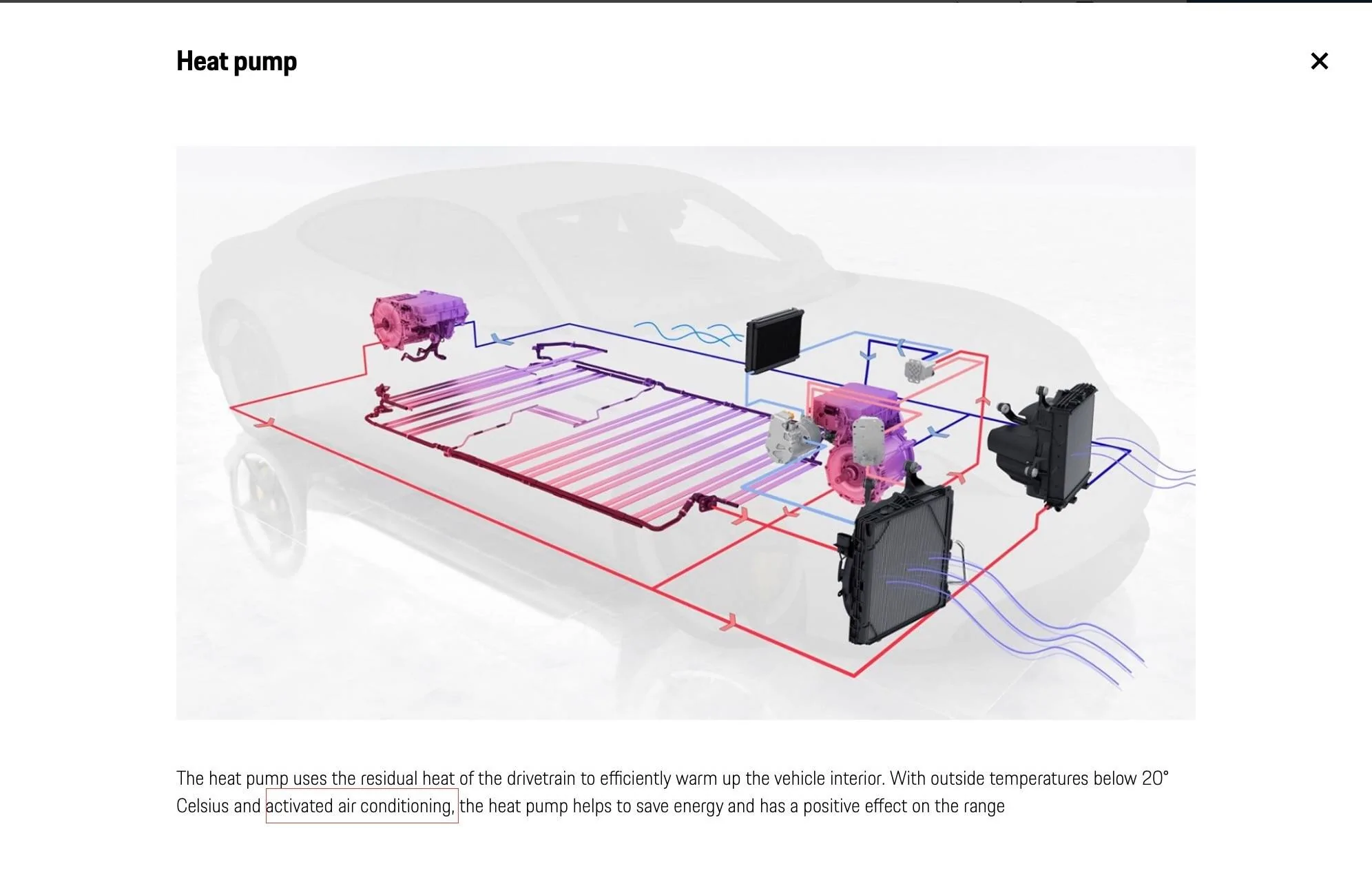

Porsche say Heat Pump is ONLY working with "Activated air-conditioning". Means Heat Pump is only saving energy when AC is activated. That is a different thing AC OFF saving energy by not using the compressor.
I am confused with it a bit, since -according to the description- HP is only working with AC ON, that uses a compressor that uses extra energy....
So should we keep AC ON below 20C to enable HP or saving energy of compressor with AC OFF and not using HP that questioning the meaning of the HP at the same time (???)
It seems to me the (AC) compressor is an active part of the the HP system that is why it should be kept on, otherwise it became a deactivated/useless equipment of the car .

Use AC as needed. Since all the software updates the impact of running AC or not is arguably not material.
Eco Plus is good enough out with winter months.
I am still not sure about that, keeping AC off lets the HP system working... According to the description clearly not.

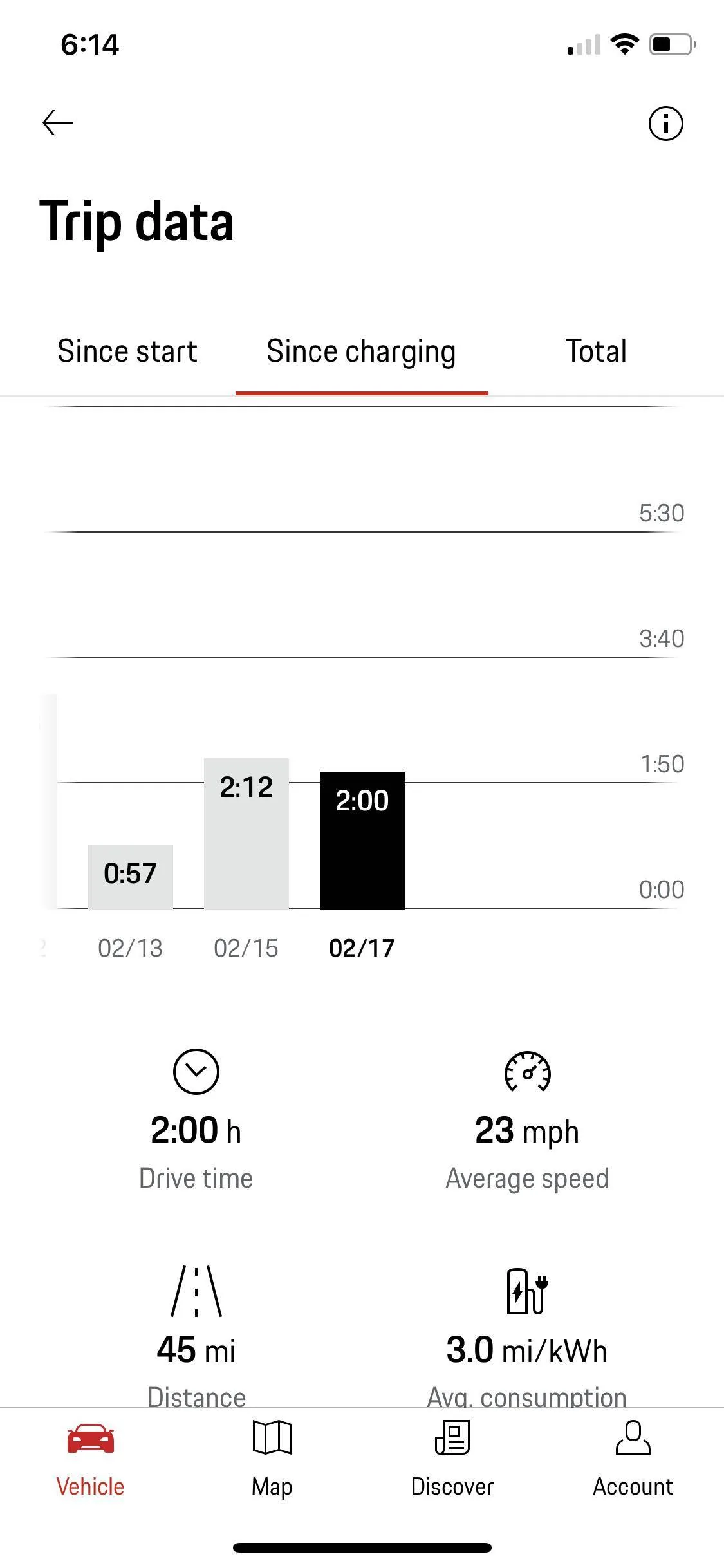

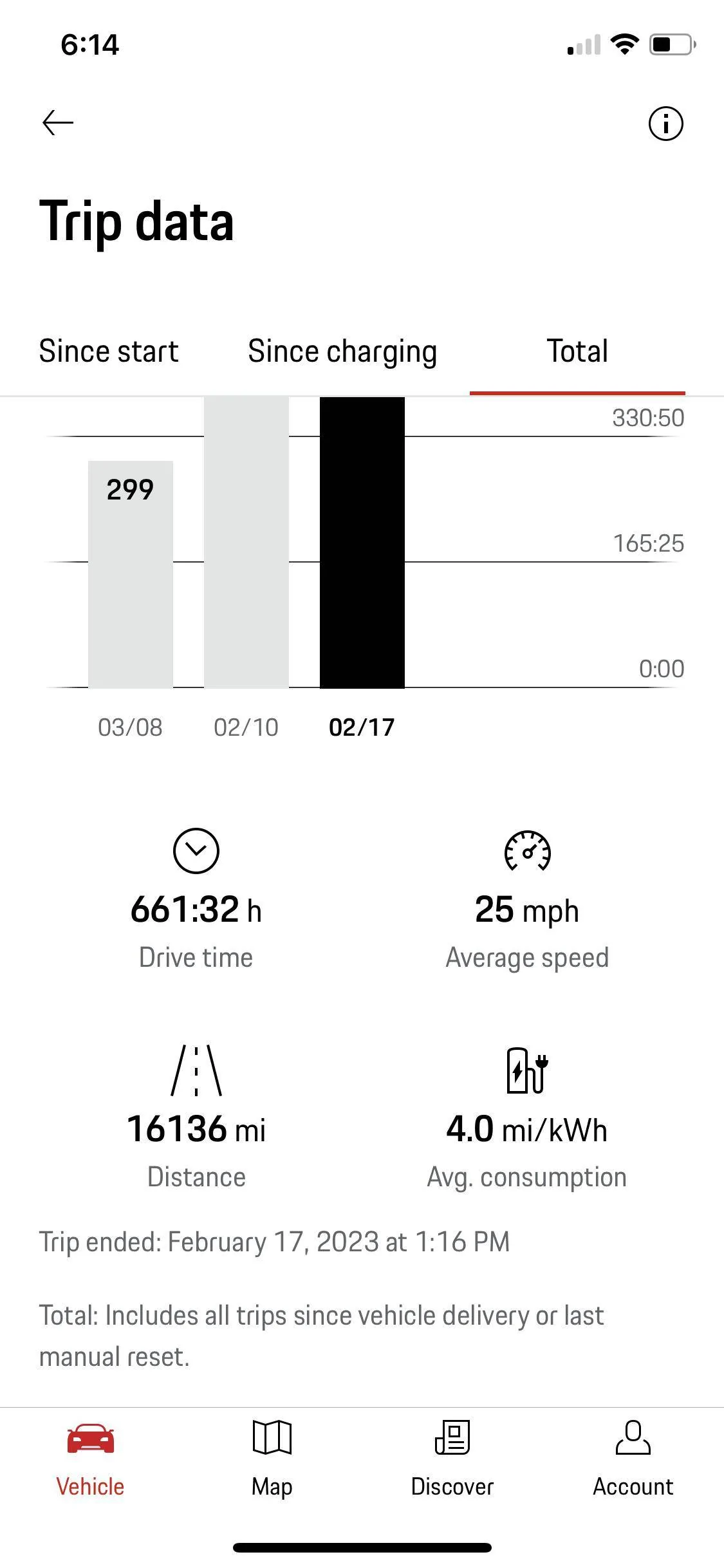

Here are my numbers from the My Porsche app. I have a 2021 4S with the performance battery.
I live in suburban Philadelphia, where it is cold in the winer and hot in the summer. I mostly drive short daily drives, about 100 miles weekly for work and another 50 or 100 miles on weekends for fun. I have gone on a few long trips using DC charging successfully.
I almost always charge at home from midnight to 6 AM to 85 % about twice per week.
I am very satisfied with my range numbers.
So yes indeed with those two panels (last value since charging and your total trip no. in kWh per mi) that equates to between 209 to 279 miles range prediction for 100% battery charge - I'd be happy too :)! This fits very squarely into my car's performance data.
When I plan longer trips I basically think of 240 winter to 260 summer max. range if needed - this way I never fall short and invariably plan to charge with 20% of those values to spare. Keeps things simple and entirely predictable!
