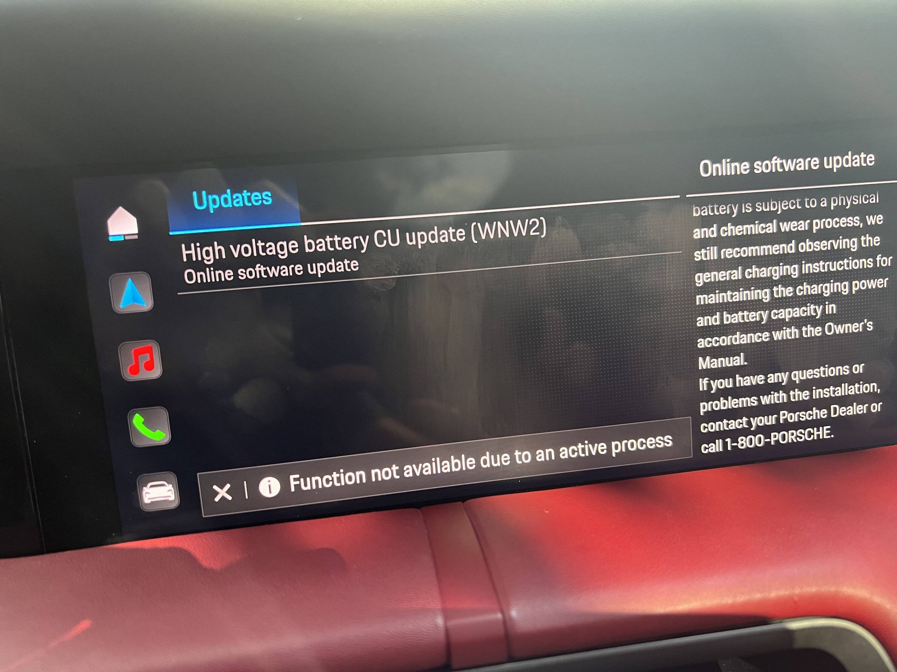

OK - weird one again - SW OTA update finally appeared and I am kicking myself as I suspect an issue might have been my USB flash (media) drive was plugged in the car inside the armrest - could it have blocked posting of the notification I wonder as the moment I unplugged it lo and behold the update was available!?
OK - BUT now no matter what I do in regards trying to get this thing to activate it keeps telling me that there is an "active process" that is stopping the update from initializing/starting!
I literally have nothing else on or plugged in except the FitCamX - took its SD card out and temporarily powered down but PCM still says OTA function not available due to a mystifying 'active process'. Probably staring me in the face!!
Any ideas as I'm drawing a blank!
PS - the same issue occurs when I power down and try to start update before leaving car I.e. pic I know from update app but using to show same error msg
Once you’re at that screen, you press the power button to turn it off then it should prompt you to exit and lock the car to start the update
See PS at end if my post - have hit power off and the OTA appears in the usual goodbye screen but again tells me there is an active process interfering

And if that doesn't work, do the 2-Finger Reset on the PCM, then try the update all over again.
Yeah was hoping not to keep rebooting but I’ll def do this again if no other solution pops up here soon :)

This is probably not a very useful idea, seeing as how you've already seen the post in question, but perhaps take another glance through https://www.taycanforum.com/forum/threads/ota-update-high-tension-battery-wnw2.16152/#post-248525. Is it possible that you have parking pre-climatisation enabled? That sounds like something that could at least theoretically be consistent with what you have described.
Thx but no never use it and def not on and yes indeed had seen that post too.
Well 2nd reboot did the trick - OTA update installed successfully - not exdactly 'Apple smooth' but done!

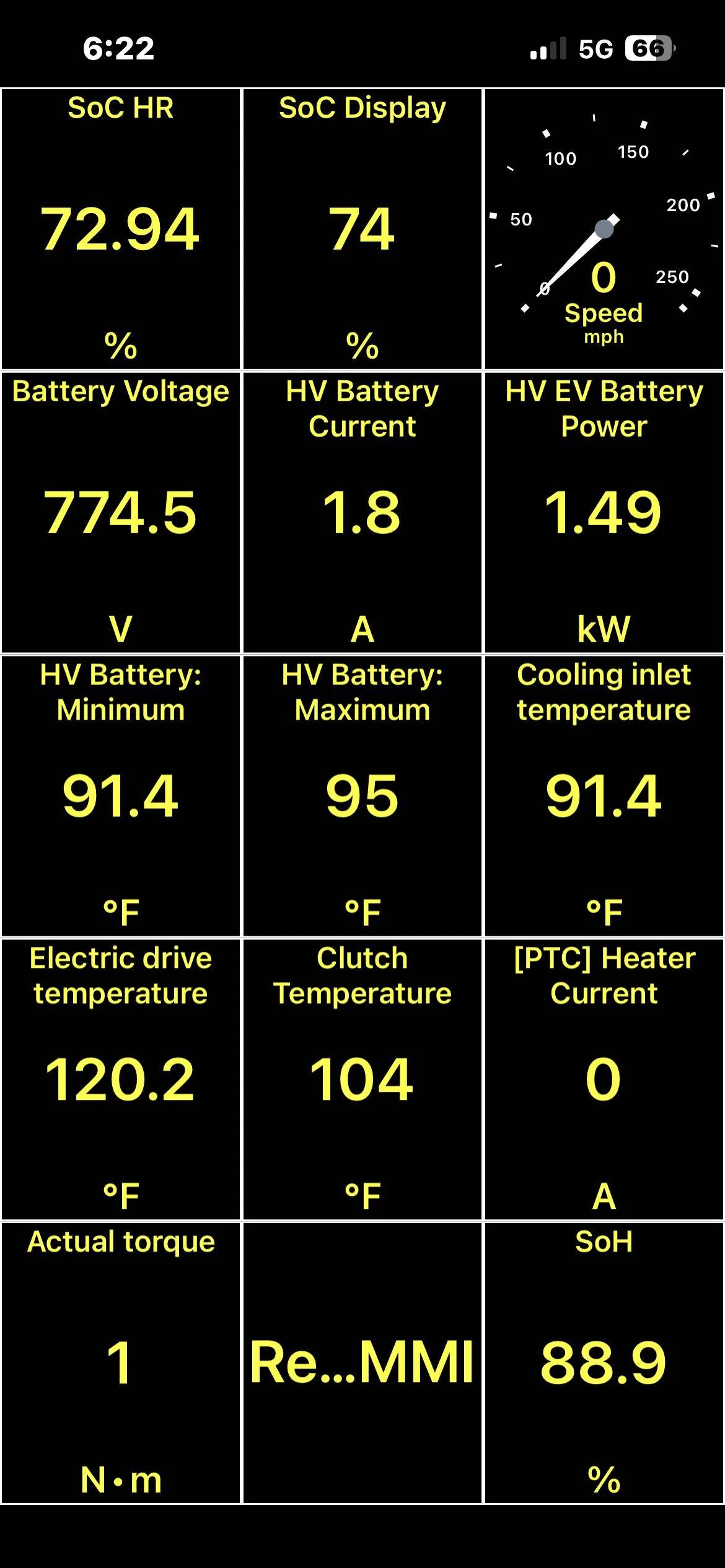

Went back to the car to get an SoH reading and was presented with the blue ring of death on teh PCM - had to reboot yet again and system back but no longer have the notifications I received prior re teh OTA update - presuming a reboot does not reset to a version prior to the OTA update but that would be too weird I suspect.
Also my Soh just like @TurboInCold 's car has not changed one iota since reading last week.
Prior reading 88.9 - same as post-OTA update again only a few days apart:
