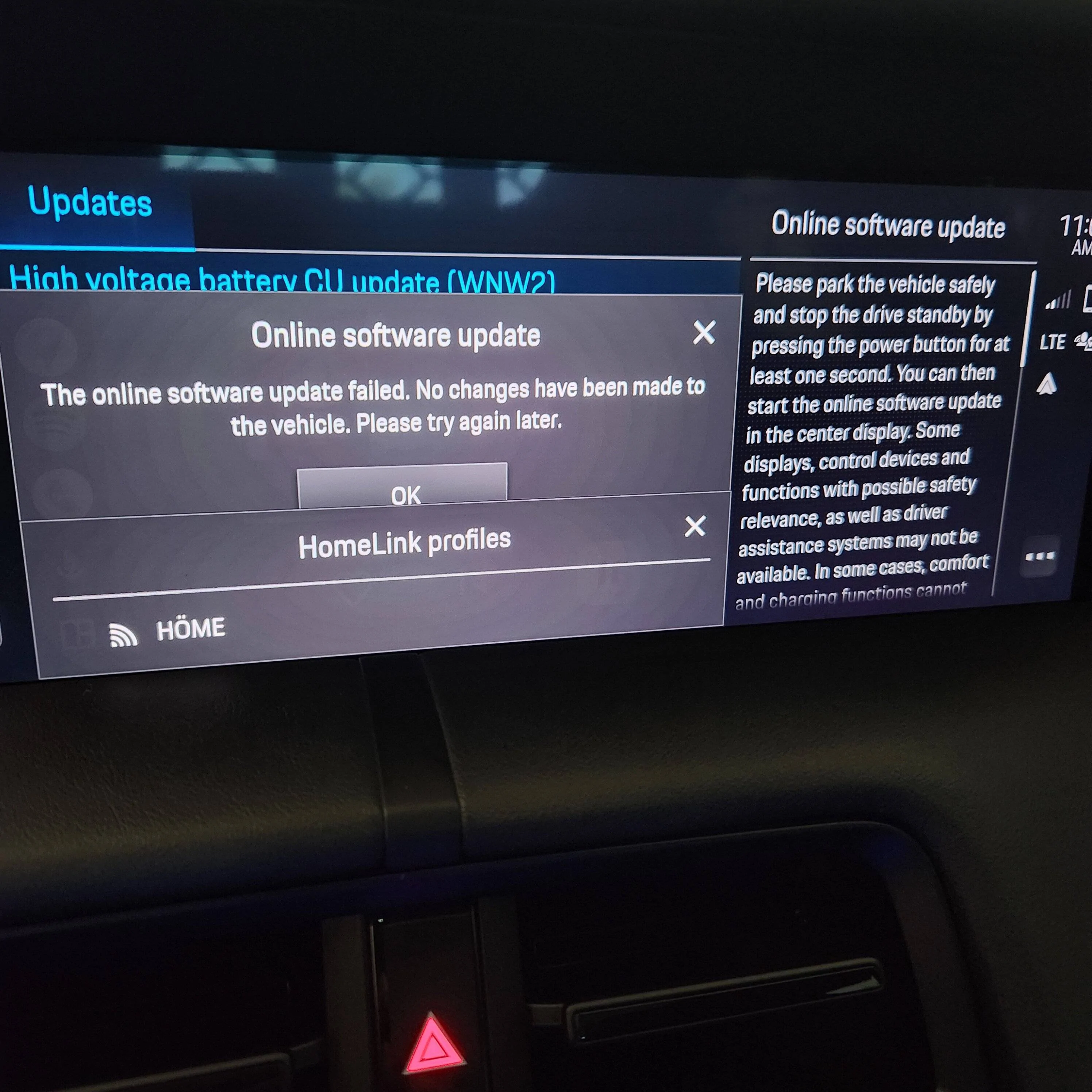

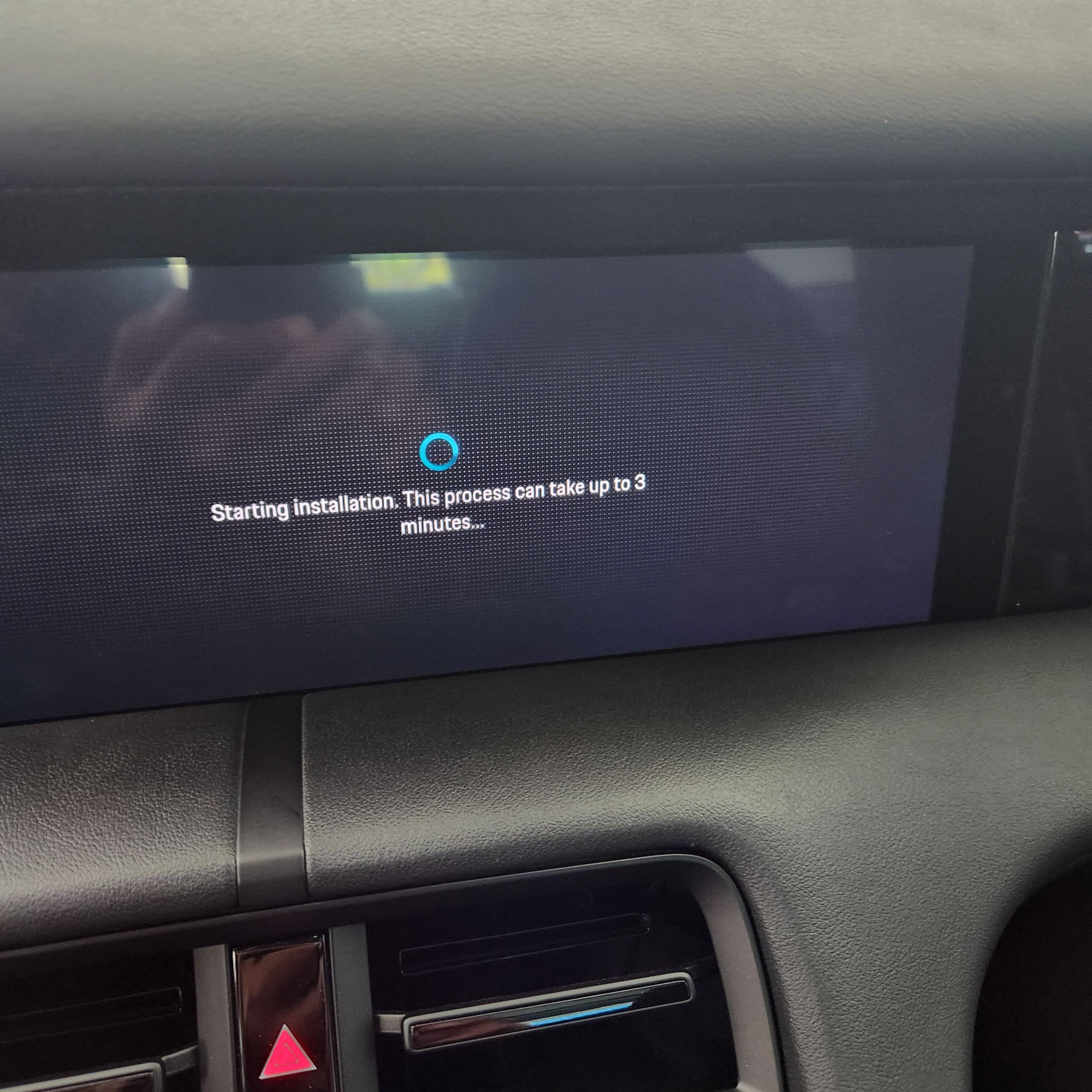

First glitch
Porsche Taycan OTA Software Update (July 17, 2023)! 20230722_110705
It started just fine:
Porsche Taycan OTA Software Update (July 17, 2023)! 20230722_105832
When it was installing I opened the door and just like usual the car fully shut down, bug? But my advice stay in the car until done. Retried again but do not get option to update yet although it still shows update available.
Ot maybe weak connection in garage not sure.
I'll try again in an hour or so

Well, the advanced notification email did say "exit & lock the car; the update will start after". This basically ensures there is no interference from the user with the PCM. Your test shows the update can handle that possibility, though, without bricking the car. (I assume?)
I got the "starting...3 minutes" message and opened the door, turning off the screens. I was also worried that it messed the installation up, but I exited, locked the door, and ~20 minutes later when I checked to see if it worked everything had installed correctly.
