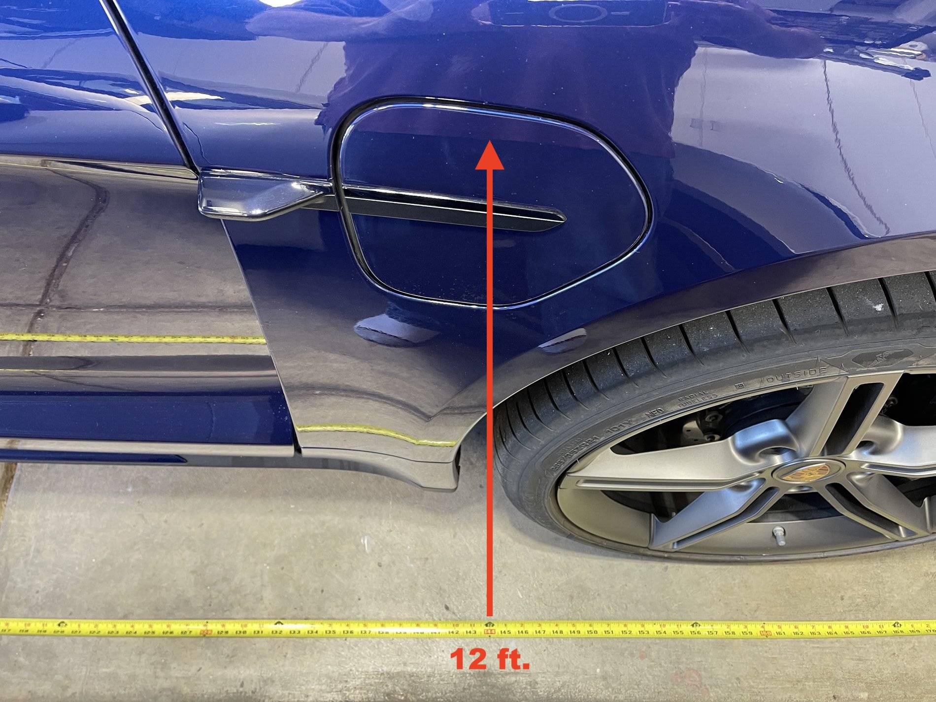

I am preparing my garage and wiring the 14-50 receptacle. Does anyway know the distance from the rear bumper to the charge port cover?

I just did this in my garage quick and dirty like - I wouldn't trust this to the inch (or even 2 inches) but it's close enough to get the right idea
12 ft - appears to be about it +/- 2 inches from rear bumper

12 ft from rear bumper to charge port

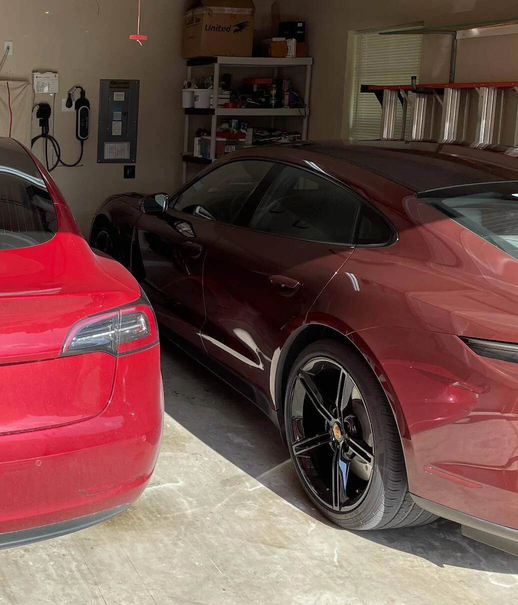

I put mine on the back wall of the garage so when I pull in it's as close as possible.
