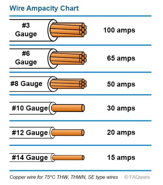

if you're pulling new wire - recommend you consider pulling 6 gauge or 4 gauge wire - overspec for 50 amps…that way in the future you could "upgrade" to a higher capacity hardwired EVSE and just swap the breaker on the other end to the higher capacity
the cost here is the labor/time spent pulling the new wire - the incremental cost of higher capacity wire is trivial - and there no problem running 50 amp across wire rated for 60/70/80 amps…it will in fact improve things.

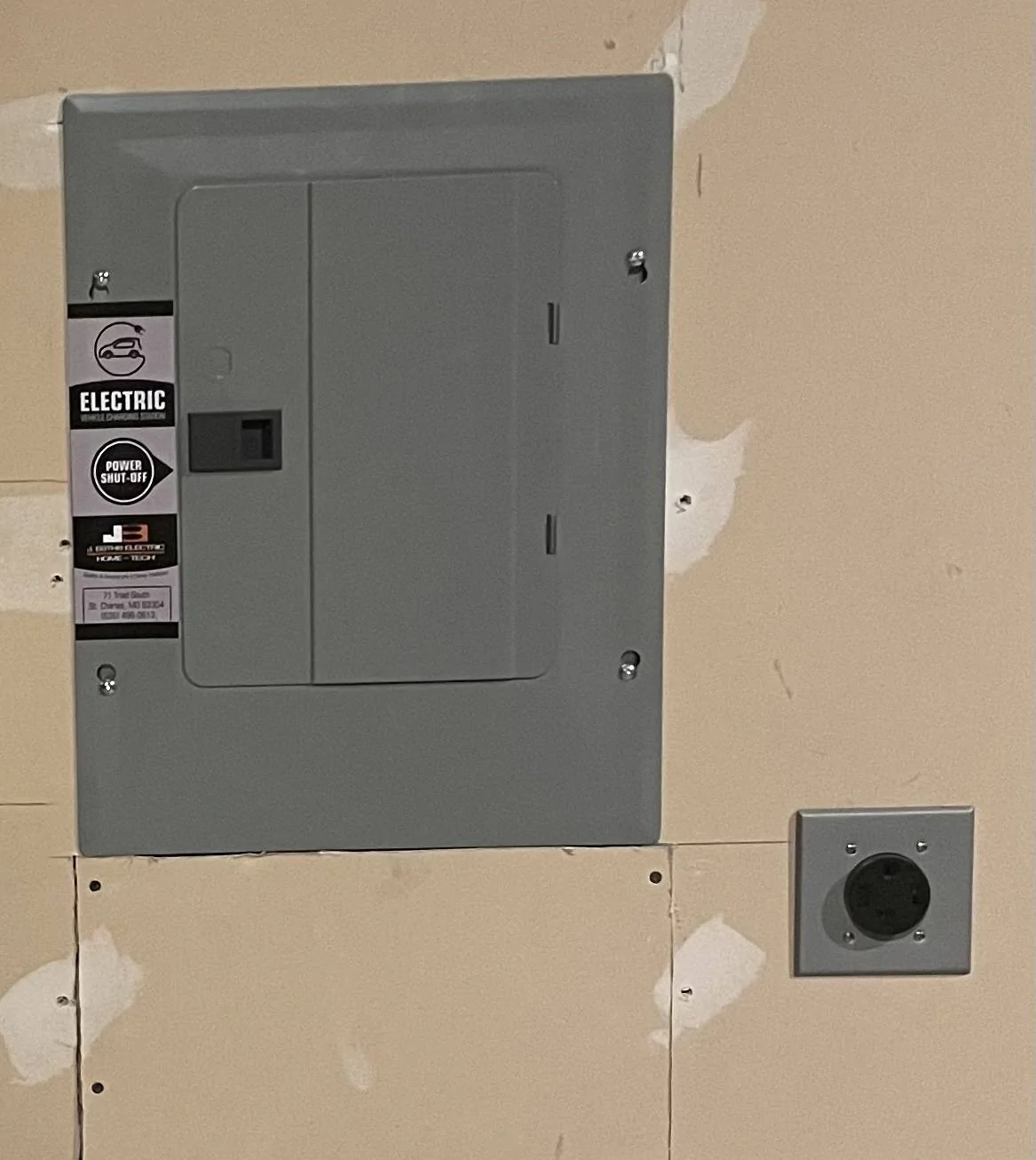

I replaced the receptacle, but then I also decided to reroute the conduit for my main EVSE because I didn’t like the way the electrician did it, so the project took a little longer than expected. I probably won’t get to any testing until next weekend.
I also made a very serious safety error in my project…I didn’t tell my wife I was doing it. ?
So, she just came out into the gagage and saw a bunch of drywall removed and wires hanging everywhere and she had….questions. ?‍♂⚡
