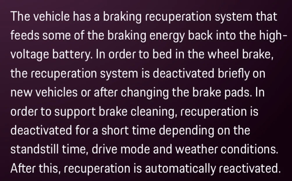

Always on for me. I find it unnatural to lift off the throttle and have the car maintain the same speed. I prefer the car to slow itself a bit like an ICE car.
I always enjoyed my ICE Porsche slowing down as I get off an exit rather than ride the brakes which saved the brakes. I did have recuperation on all the time but recently I have to turn it on every time I start a drive.
I may be cynical but I’m thinking they don’t want it always on since it will reduce the frequency of brake replacements since EV service revenues are significantly reduced compared to ICE vehicles.
Porsche simply increases the parts prices & labor rates but if they continue down this path then a Porsche can no longer be used as a daily driver. For me it doesn’t matter since I only drive any of my vehicles no more than 3K to 4K miles per year. The cost to drive a Porsche 15K to 20K miles per year is going up not down and once you get outside of warranty they have you paying ridiculous parts & repair costs.
My 2007 Mercedes Sprinter Airstream Interstate has 150K miles on it. It’s a workhorse and will go over 1 million miles before it’s retired. I’ll be dead by then. That’s old school German engineering. My old friend has a 1985 air cooled 911 with 250K on it. It runs perfect and is easily serviceable at reasonable parts & labor costs compared to newer models. It’s still worth well over $50K. My 2021 Taycan cost $124K new, $78K at 30K miles CPO and likely not worth more than $50K after less than 5 years and it’s still under warranty for 3 more years.
I would be surprised if it is worth $30K by 2030 at 8 years old with at most 60K miles on it. For me it doesn’t matter because I just drive it around town mostly. Not a serious car I would ever rely on. That’s sad. I have a Porsche I really don’t trust as reliable transportation and I am coming to the realisation that my trust in Porsche as a company is misguided. I hope they figure it out but they’ve already altered my future buying decisions. I’m open to other brands which will provide beauty, performance & reliability at a justifiable price.
You know that’s not how a Taycan works, right?
When you press the brake pedal the computer decides whether to use physical brakes, which it does rarely.
Gino
Gino
Apr 2, 2024
29
916
457
Orange County, CA
2000 Boxster & 2021 Taycan
Good to know. I didn’t realize it uses the counter EMF from the motor for braking regardless if recuperation is on or off. Makes sense. Thanks
