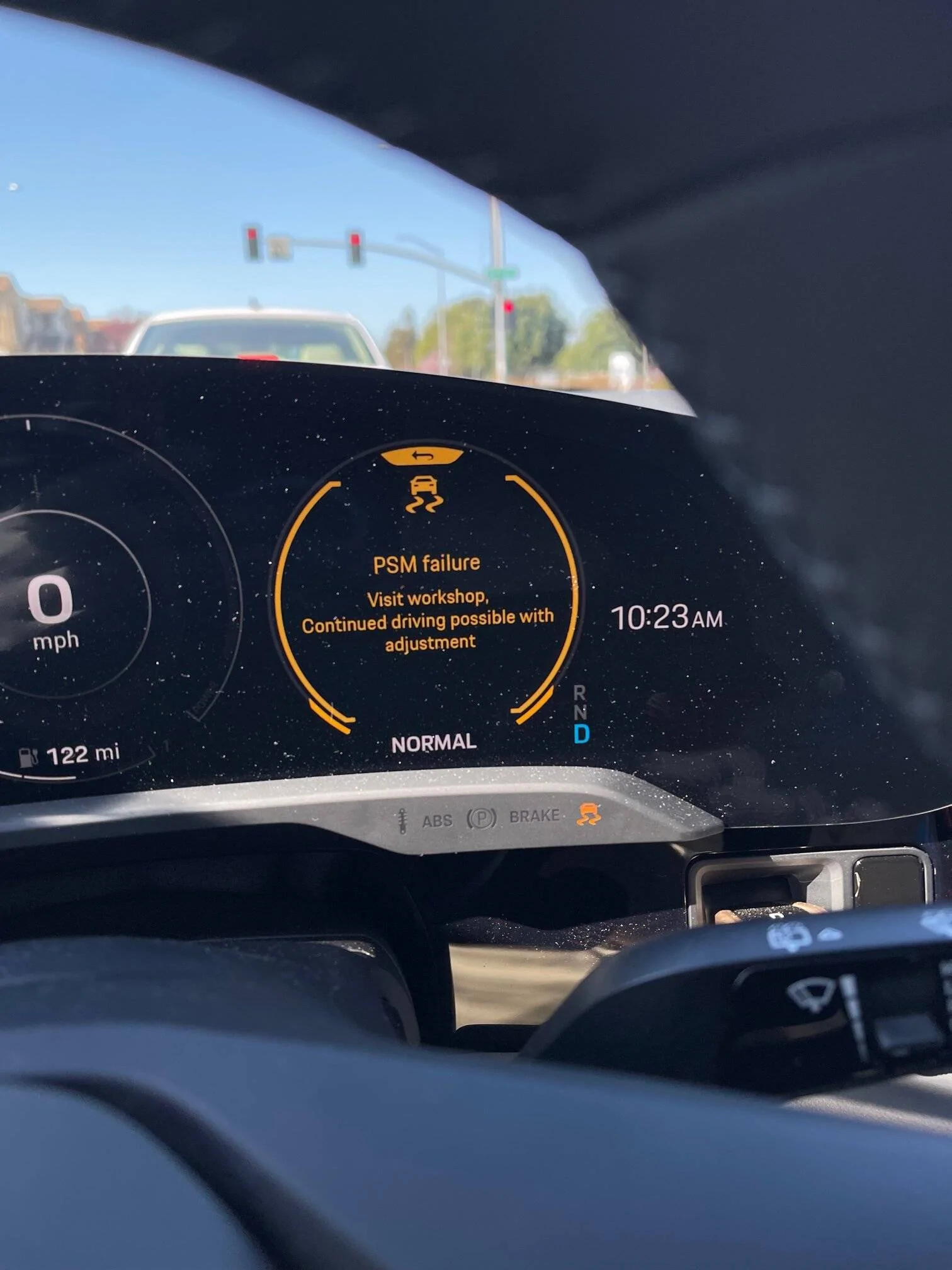

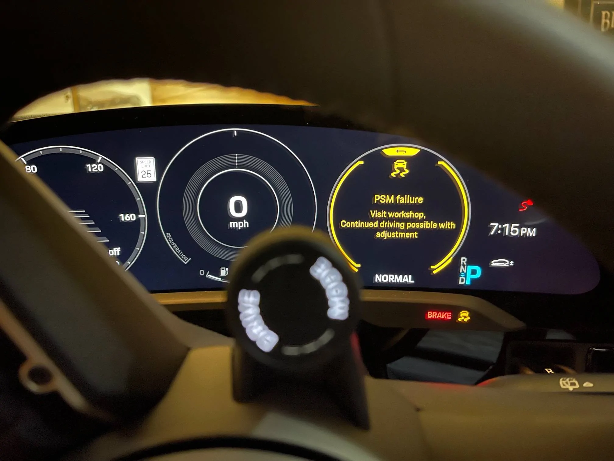

Had to take the car to the shop for PSM error that pops up during braking. I'm also having porsche check the soft / mushy brake feel along w/ odd noise the brake pedal makes during braking. PSM error disappear after vehicle restart but PSM error comes back after every drive w/ regen activated braking. It seems like the length with which pedal goes down changes everytime you try to slow down the car. Pretty disturbing and dangerous. This brake system design need to be further sorted.
Sounds a lot like what I experienced last year. It turned out that my brake module was the culprit and needed replaced. Everything has been working fine since I got the new brake module.
+1 - That's reassuring & thanks for the feedback. Will let the service mgr know.
