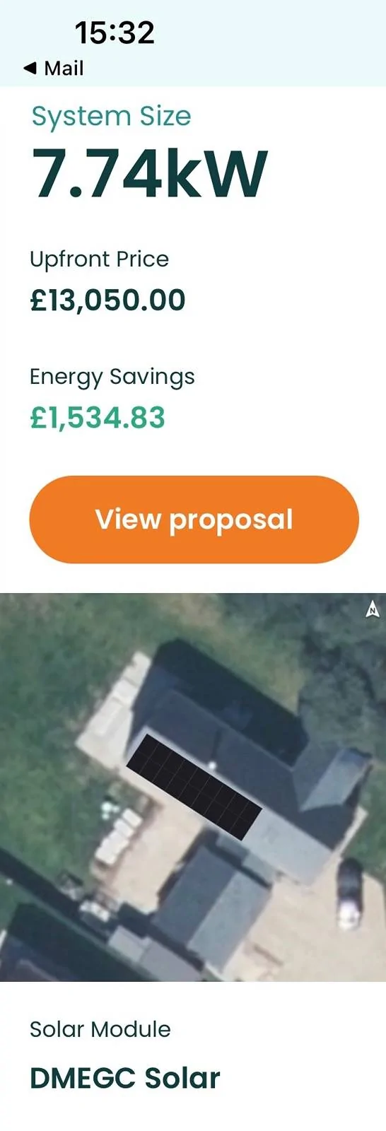

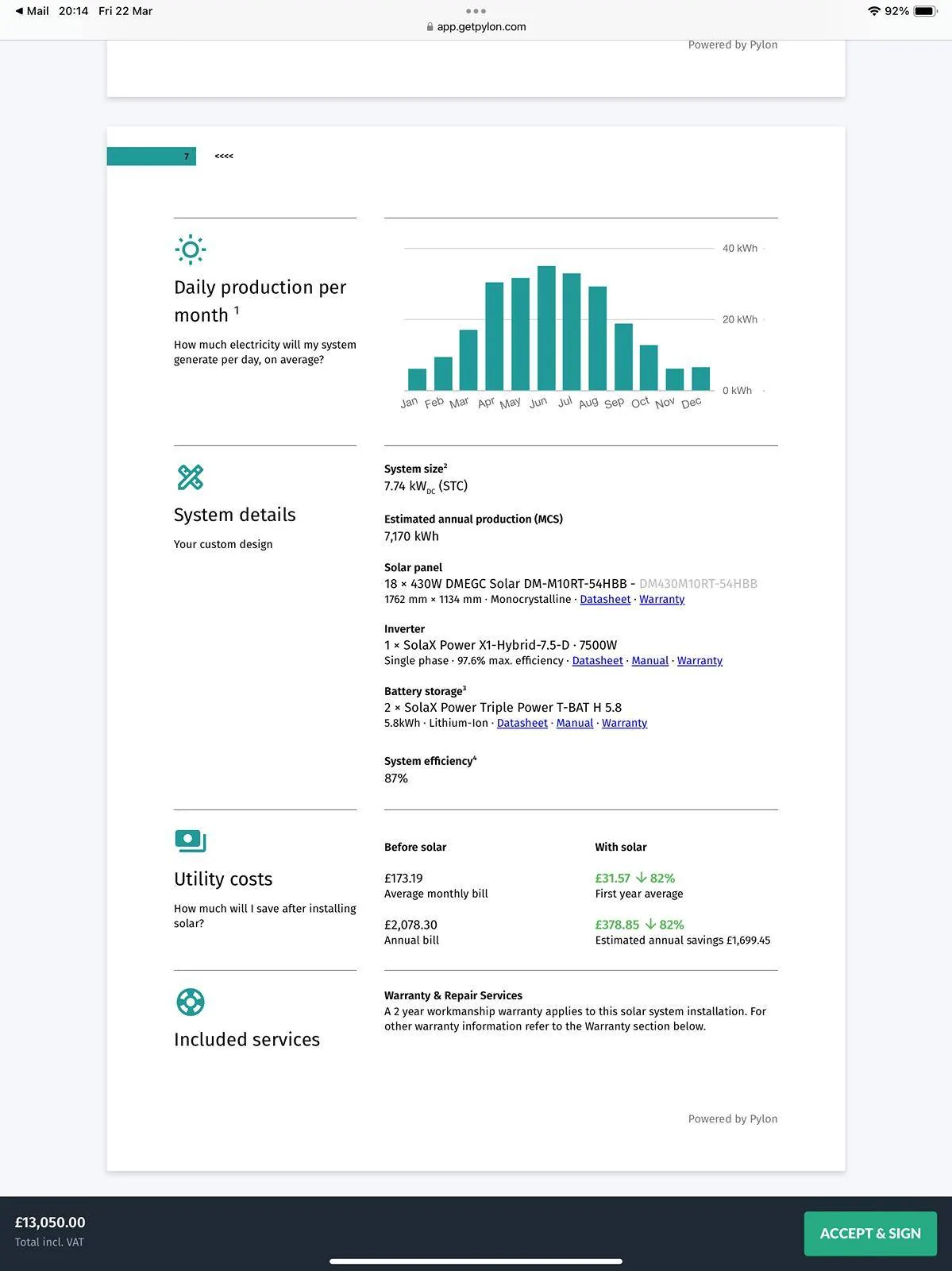

Does my quote look around what you’d expect. It’s a local company, really like them as not pushy. 18 panel system, 12kw batteries for £13k, £1200 extra to have the system flush fitted ‘in roof’ and an extra £700 to change my old pod point to a zappi that would integrate.
Porsche Taycan Solar install, batteries, exporting and ev tariffs IMG_0443
Porsche Taycan Solar install, batteries, exporting and ev tariffs IMG_0444

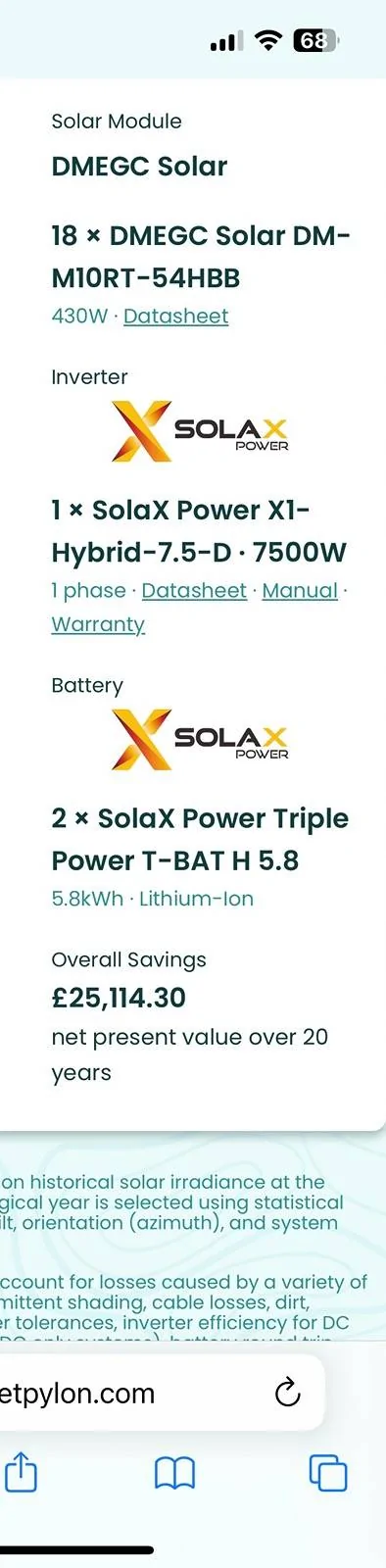

Ah ok, not good on the winter generation. The quote suggests 6kw per day ? We are SW Facing with no shade on the solar side. This doesn’t sound realistic then?
Porsche Taycan Solar install, batteries, exporting and ev tariffs IMG_0097

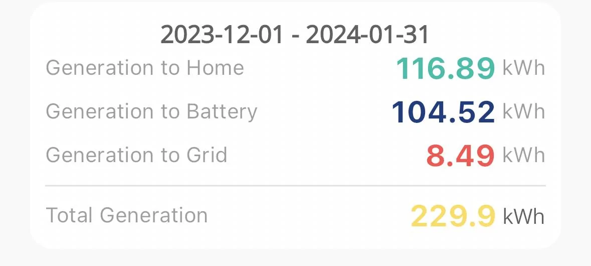

Porsche Taycan Solar install, batteries, exporting and ev tariffs IMG_2458

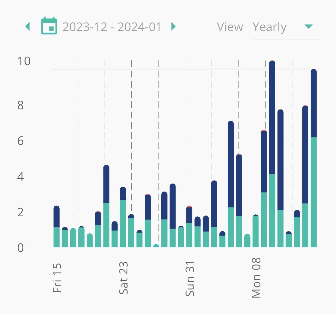

Here’s Dec and Jan this winter - it works out a little below 4kwh a day. It does vary - the graph below is mid-Dec to mid-Jan and some days are nothing, others not too bad
Porsche Taycan Solar install, batteries, exporting and ev tariffs IMG_2459
On the other hand, in the summer it generates more than we can deal with so we end up dumping a load in to the grid. This year we’ll have 2 EVs so if we’re home we’ll plug in and used the excess for those. During a week away in July last year we were exporting over 110kw to the grid on top of what the house was using to idle

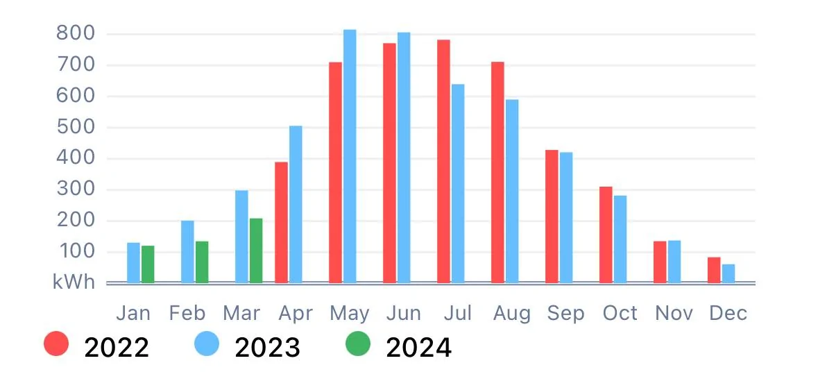

here is my monthly generation:
Porsche Taycan Solar install, batteries, exporting and ev tariffs IMG_0787
During summer there is enough generation to fully charge the Powerwall and fully heat my hot water, and see us through the night on battery - so zero grid use from around May to September. Note - no EV to charge last summer.
Although last summer I only got 4p/kwh export and gas was expensive, now it’s the other way round I’ve disabled the Eddi, as it’s better to export the excess solar.
during winter the Powerwall comes in to its own. It’s VERY clever, learning use and solar output and looking at weather forecast, it will charge just enough over night and allow maximum export of what’s left. They are expensive, but my mate has as more panels and a bigger inverter than me, but a 10kwh battery without the intelligence - his frequently runs out.

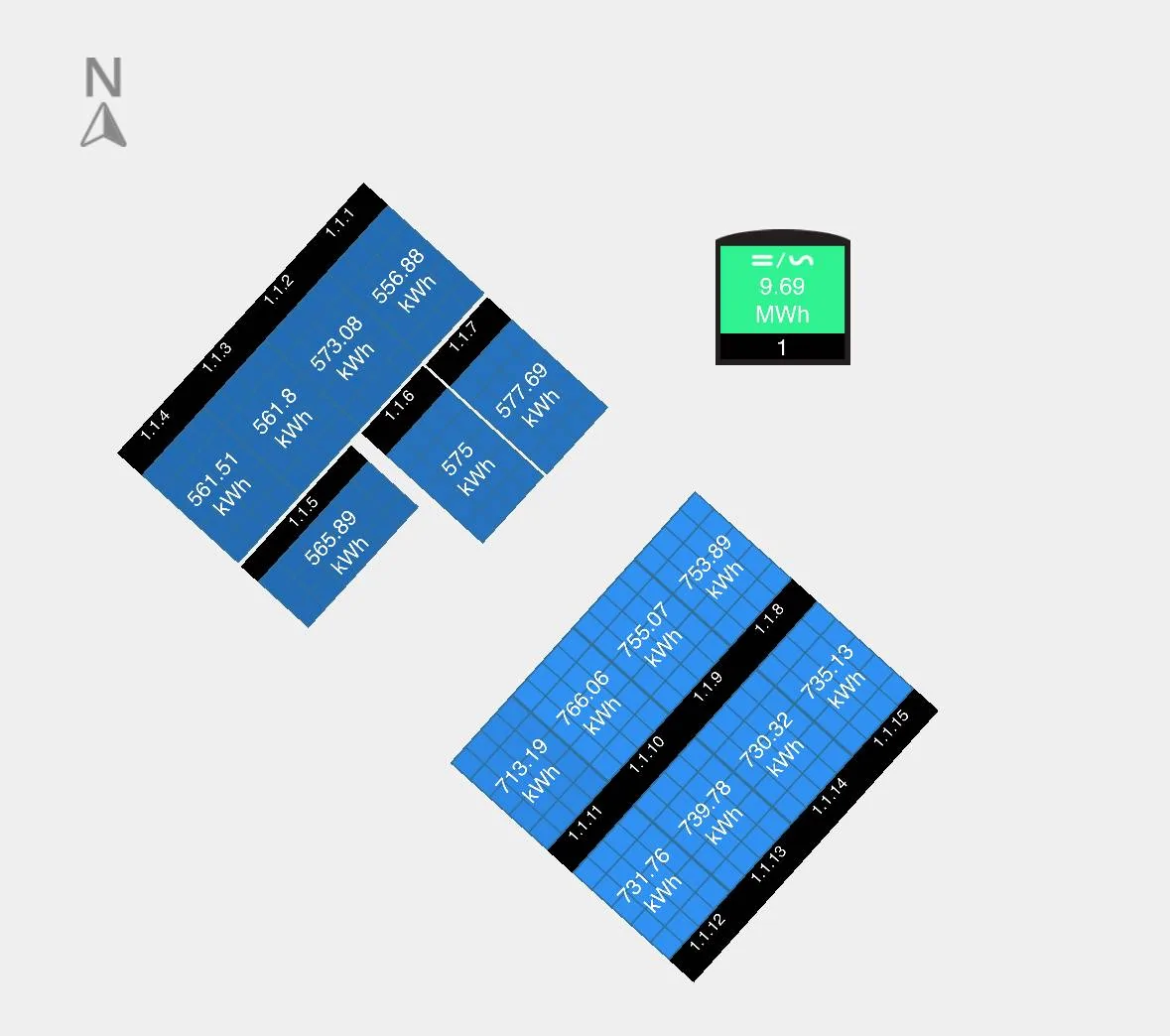

Oh, my roof layout is far from optimal too. Half my panels facing NW! However the pitch of my roof is only 20 degrees, so they still work surprising well!
Porsche Taycan Solar install, batteries, exporting and ev tariffs IMG_0789
I do love the SolarEdge inverter for its data!
