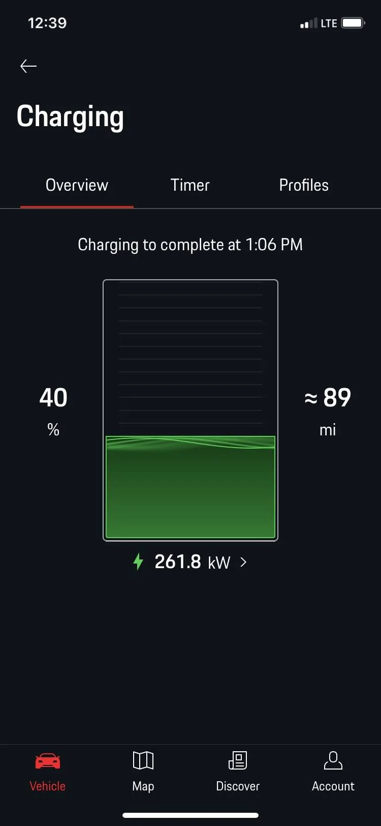

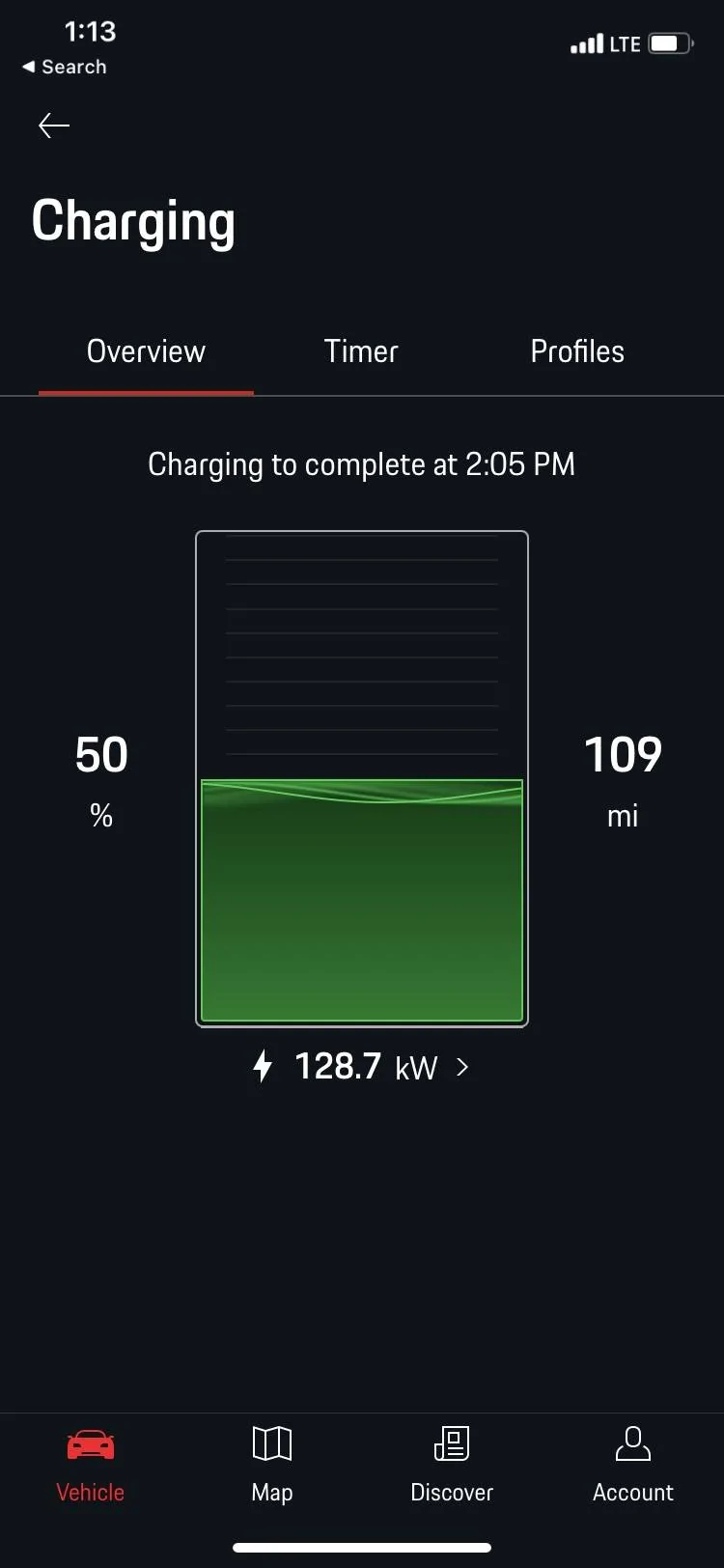

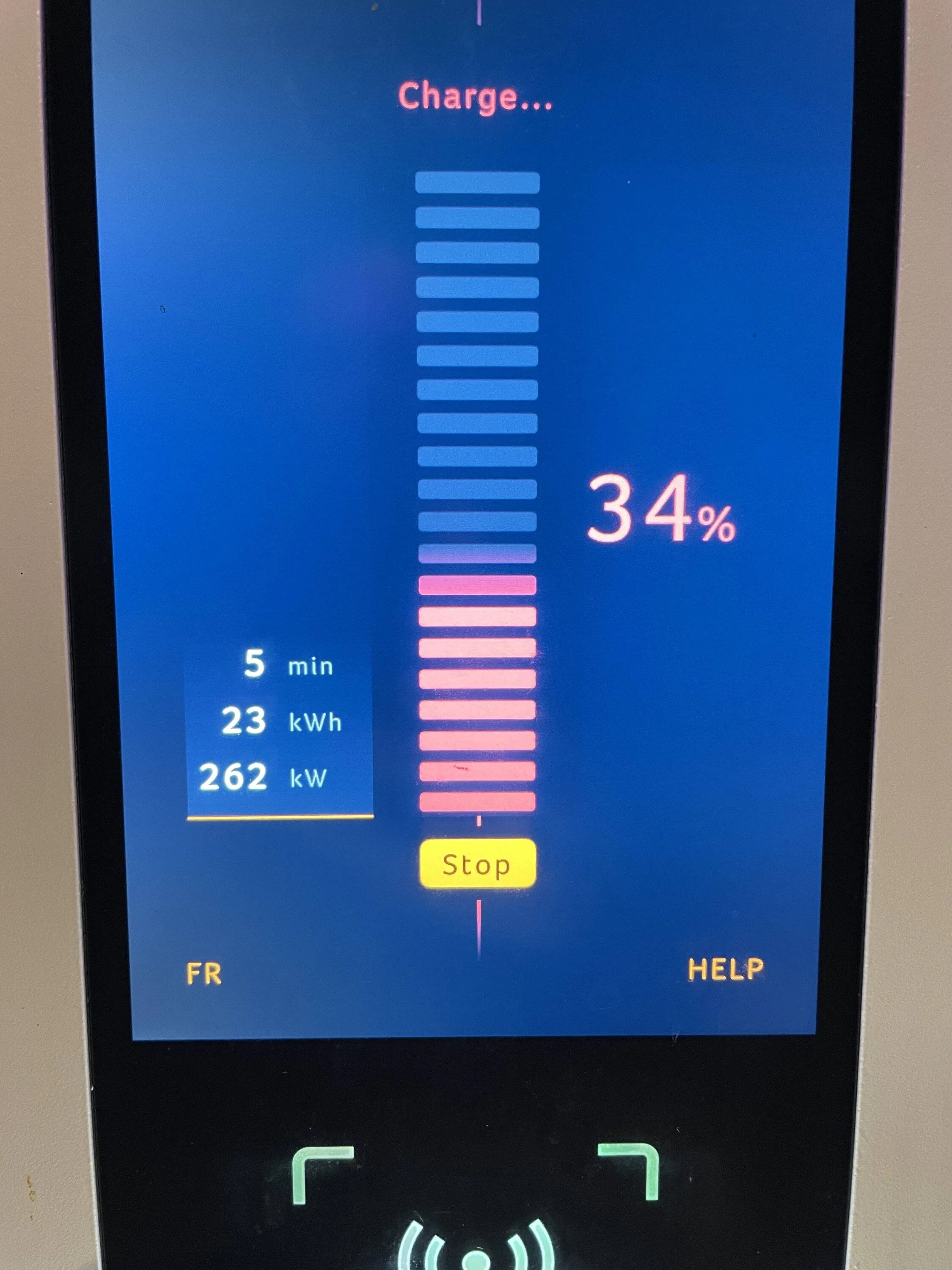

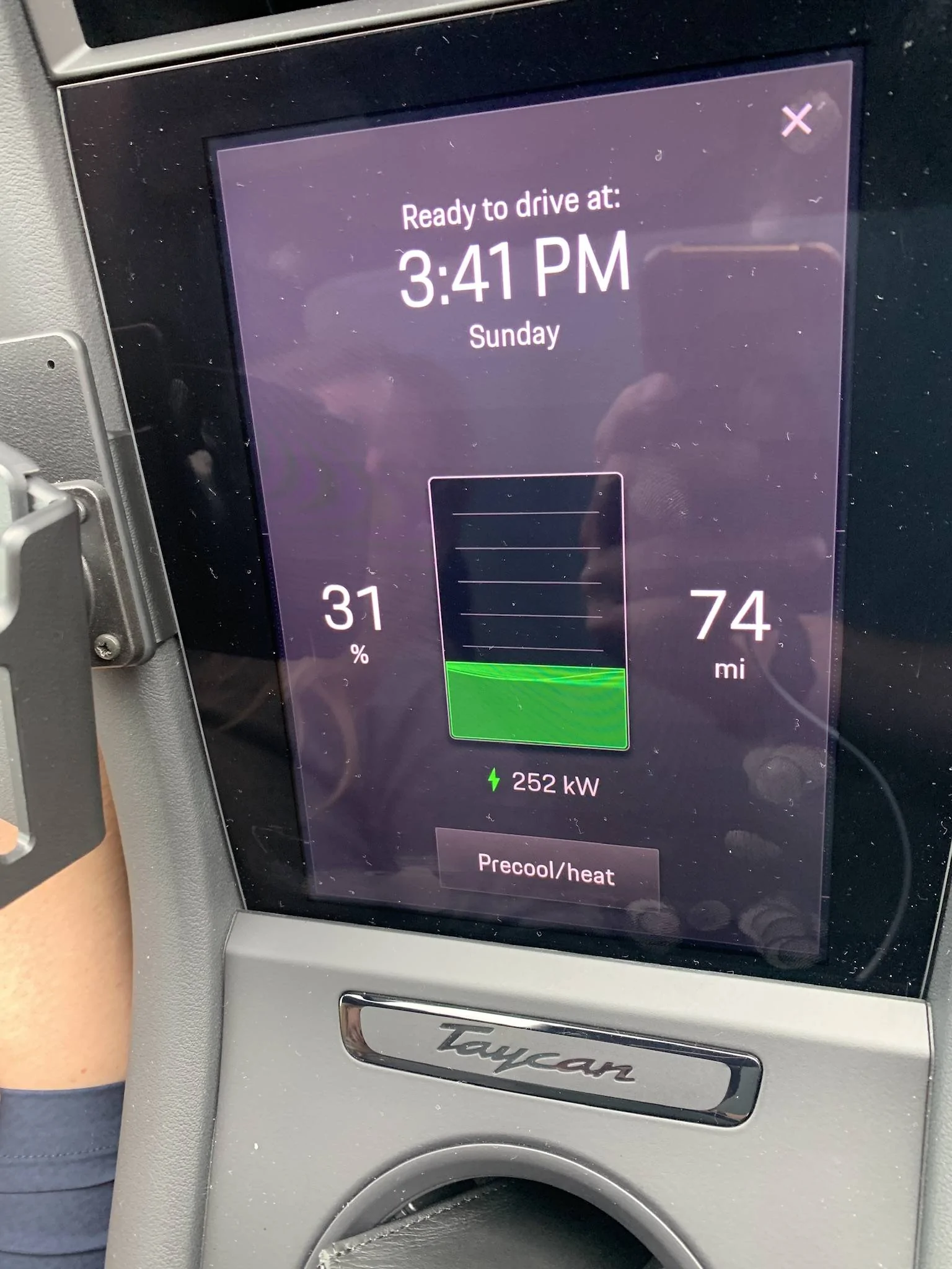

I think there is a lot of variability between EVSEs but my charging rates are generally higher than you indicate. Here are some photos and screenshots from my last road trip…

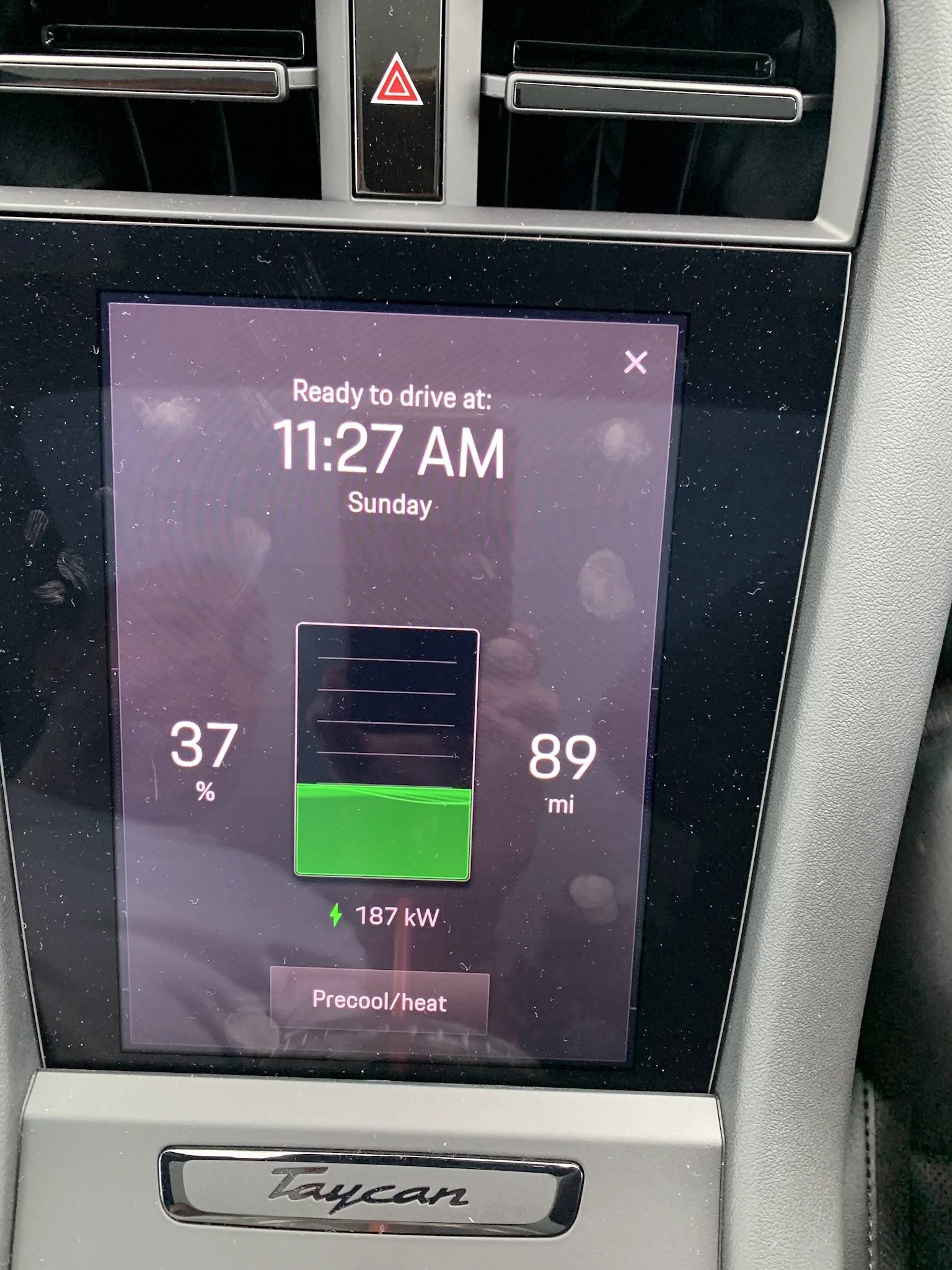

I never plug when I’m at 40% and often at 5 to 10 but here is an example at 14% when the battery is warm.
And afterwards it continues to go up a bit
