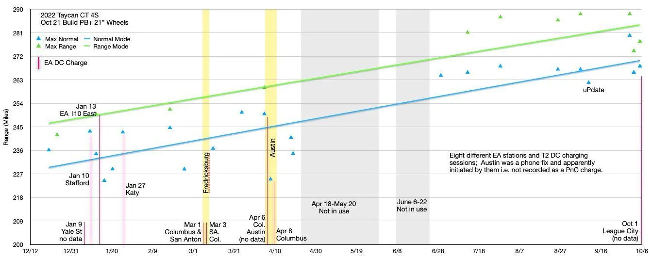

To date, albeit with no where near the mileage you are logging, I am actually seeing a drop in range post-uPdate that I cannot (I don't think) attribute to the slight drop in temps here (we are still at 90F in PM but cooler overnight in 60s) vs Aug-Sep.
Have had a few funky charge sessions (impromptu bad planning!) so my trip data not terribly consistent right now but just using the max. 'predicted' ranges for Range and Normal mode as I have done over the last year also shows the drop in efficiency/predicted ranges - seems slow to recover just to where it was never mind any indication of an actual increase in range.
All that said, my expectations were low in regards the latter as being an Oct '21 build of a 2022 model car I did not expect any significant range changes TBH.

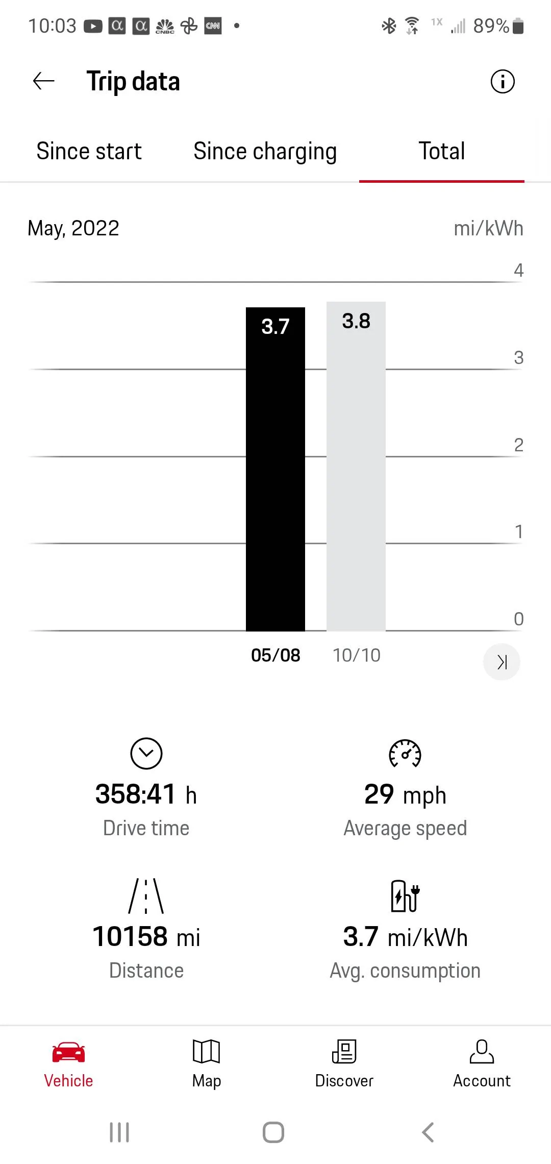

Have you looked at you center display to see if the new strategy has been invoked properly. Mine shows four wheel when I first start up in the morning for a couple miles. After that it shows rear wheel drive when cruising (especially with cruise control) even up slight upgrades. Rear wheel also continues when on highway at 70 (haven't tried higher yet). Four wheel recon when off accelerator.
I normally drive in Range mode and I have 20" wheels. My recent "since charging" data shows 3.5 miles/kwh. That's up from an average bar reading of about 3.2. My total of 12,000 miles shows 3.8 which consists of about 3,000 miles of highway at 75. I live in a rural area so a lot of my driving is 55-60 with average trips of 10 miles. Bar in May is before uPdate, bar for October has about 1,000 miles after uPdate.

Porsche Taycan Taycan Range Test With New Software Update Screenshot_2022-10-11-My Porsch
