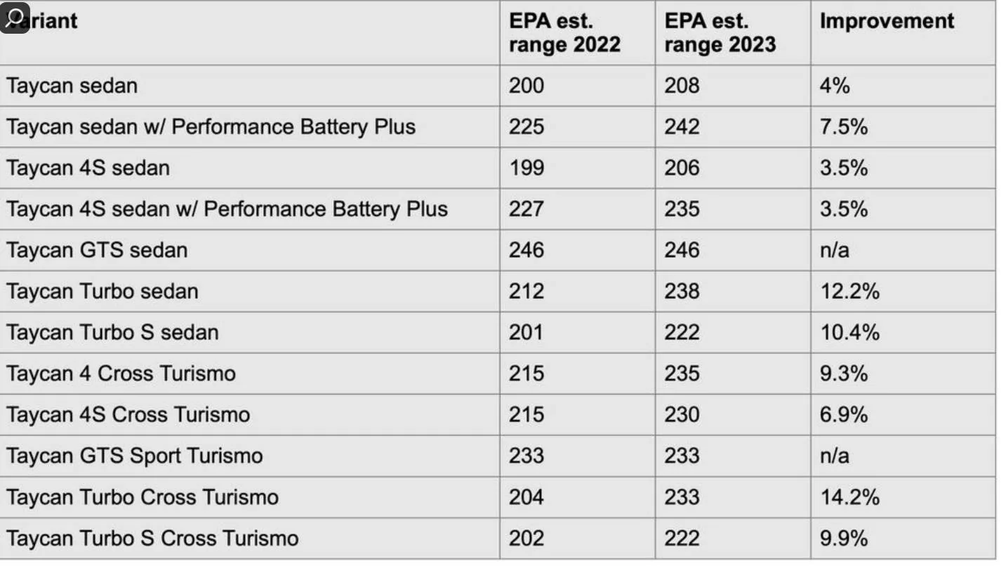

I think I may have found why so many people are reporting different mileage results after the uPdate. This article shows a chart (hopefully from Porsche) showing what they expect for different variants and years.
Before the Update at highway speeds I got about 278 miles. I have not done a highway trip except back from the uPdate and I imagine that the battery management system was not properly calibrated- and may not be for a while. In addition, I was travelling 85MPH for a good portion of that trip. In a very unscientific look at M/KWH for each start before the uPdate and after I got an improvement of 1.0406 better M/KWH after the uPdate. The chart shows that I should have gotten 3.5% which is pretty close. If I apply that to the one highway trip before the update it would predict that I would get 289 miles.

Porsche Taycan Taycan Range Test With New Software Update Inside EVs article on uPdate mileage1
11,093
6,868
WRT charging, I'm not as impressed. I traveled to the Electrify America charger this morning and set the charger as the destination. The charger was about 25 miles away (non-highway) and I monitored the battery temperature. It started at 75 degrees. Very soon after the start the temperature was 85 degrees. It continued to go up steadily as I got to the charger except that at the charger it was 110 degrees. It had always been 95 degrees +- before for my best charging speeds. The charge did not go as I had expected. Max was 166 KW and it was below 100KW by the time it had reached 65%. Total charge time was 19 minutes from about 25% to 65%. I did have the battery saving application on, but I actually thought that would make it peek at 200KW and hold it. I believe the battery was too hot for peek charging. I called Electrify America as it was charging to see if they could tell me whether the charger (350 unit) was the limiting factor or the car. She could not tell me.
Chuck J
Yes we saw the chart and it is marred with anomalies plus it doesn't reflect real life. Most people see higher ranges than what's reported here.
Remember also that all cars are effectively MY23 now since uPdate. No known physical improvements have been made or introduced.
I was just addressing the percentage improvements, not the total.
+1.
Compared with that chart for CT4, I had opposite numbers before uPdate: 400-420km (250-262miles)
Now, after uPdate: 365-375 km (228-234miles)….which is close to 235 miles in the chart for 2023.
I still think that might be just coincidence and worse range is simply based on battery degradation after one year of usage…

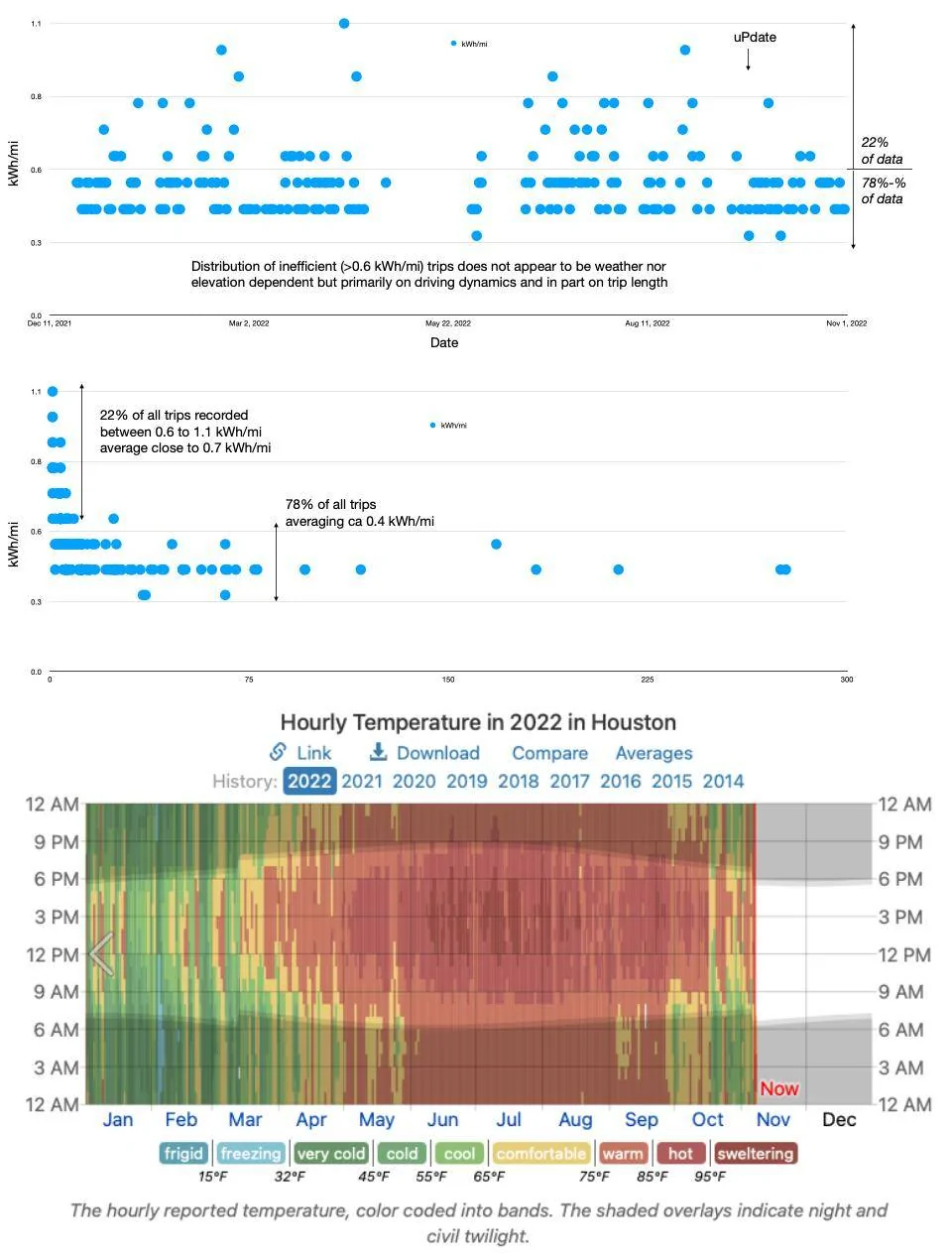

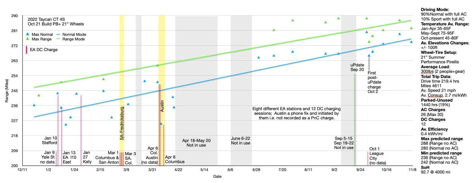

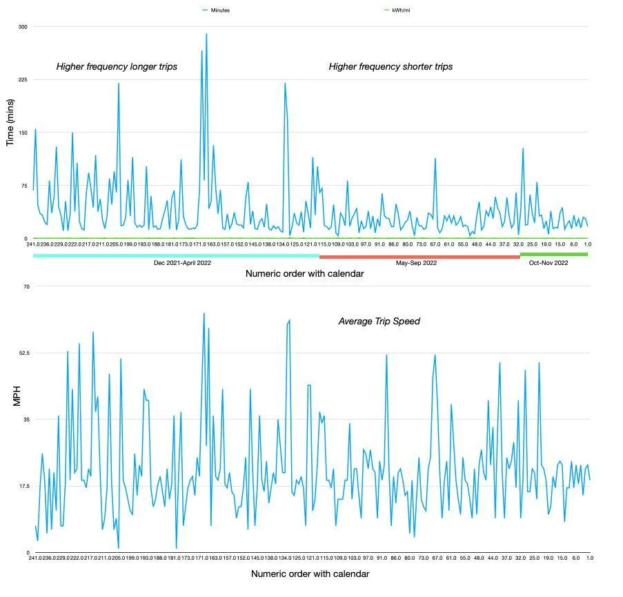

ciaranob
Jul 3, 2021
3,547
2,639
Latest home charging data - need to add a few trips to the trip data but no significant deviations from the trends here i.e. the uPdate has had zero effect on my car's performance metrics but again nothing more than I expected and very happy with it to date.
In my somewhat unusual case the general consistency of elevation, temperature, AC use and driving style metrics all point towards driving dynamics as a primary impact on my efficiency and range variation as compared to areas with dramatic differences in e.g. seasonal weather, elevation etc. - literally YMMV :)!

Now that's some data!
I'm really thinking the charging speed increase above 50% is the largest benefit. That, combined with the extra 10 miles will make road trips better. Unfortunately for me, my typical road trip has extremely limited and unreliable charging stations so I have to use my ICE car for those.

Yeah, does seem like a lot but all available in the App or Porsche web site - only additional data is my recording with my phone the SOC after every home charge (in first plot).
BTW, saw your post re DC charging but TBH, I'd be very surprised if the uPdate had any effect on DC charging speed - I could be 100% incorrect here but will be interesting to see how your future DC sessions behave as I suspect the variation you saw there is almost entirely due to the DC charger's behaviour rather than the uPdate.
I need to check the list of changes in the uPdate but don't immediately recall anything re DC charging improvements - do you?
