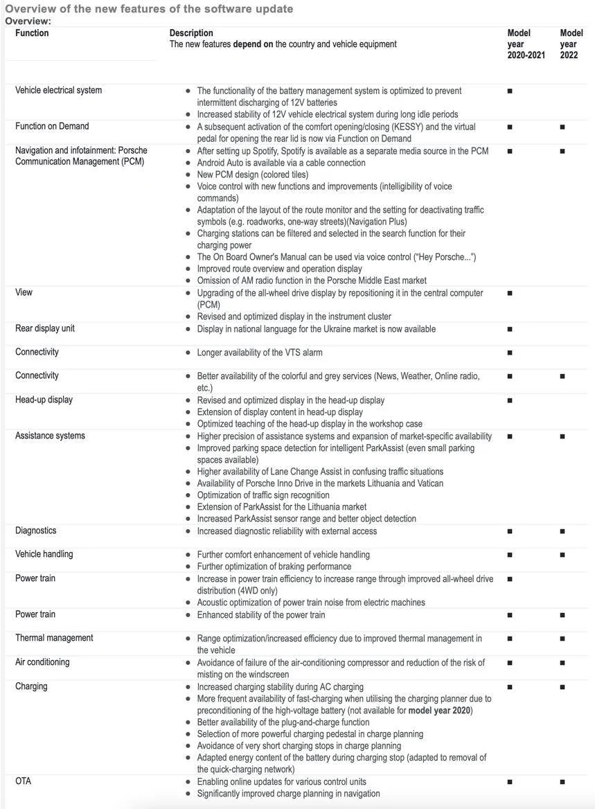

Quick check of the uPdate improvements list and there are a couple of candidate charging related items but again, not sure they'd be relevant in this case.

Was that option available before the uPdate, I never looked for it? When I tried charging before at 90% it was down to 50KW area or less.
