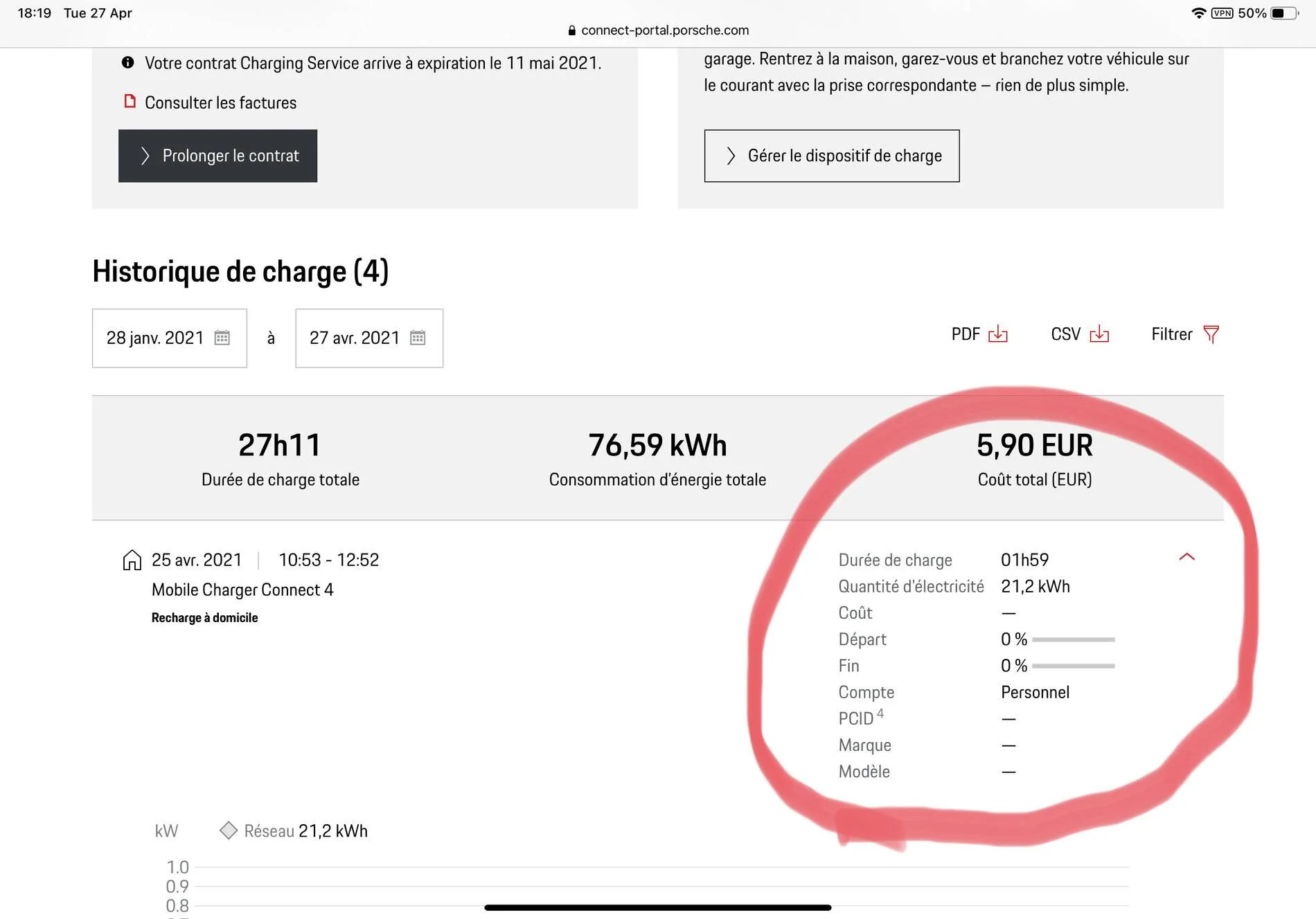

I have not seen any SOC on the display after the update either. Not sure this works yet on MY 20? It is a bit surprising since the PMCC reports a lot of data bck to MyPorsche under home charging. There it seems it should report SOC at start and finish etc. As well as the car details. so hopefully something else will be updated to show all the details?
I have SOC displayed on my PMCC (MY21 car and no updates to PMCC following WMA6 campaign).
However, the stats recorded on My Porsche can be random and incomplete. SOC at start and end is not always populated plus the time axis is completely off by -6 hours which frustrates the hell out of me.
