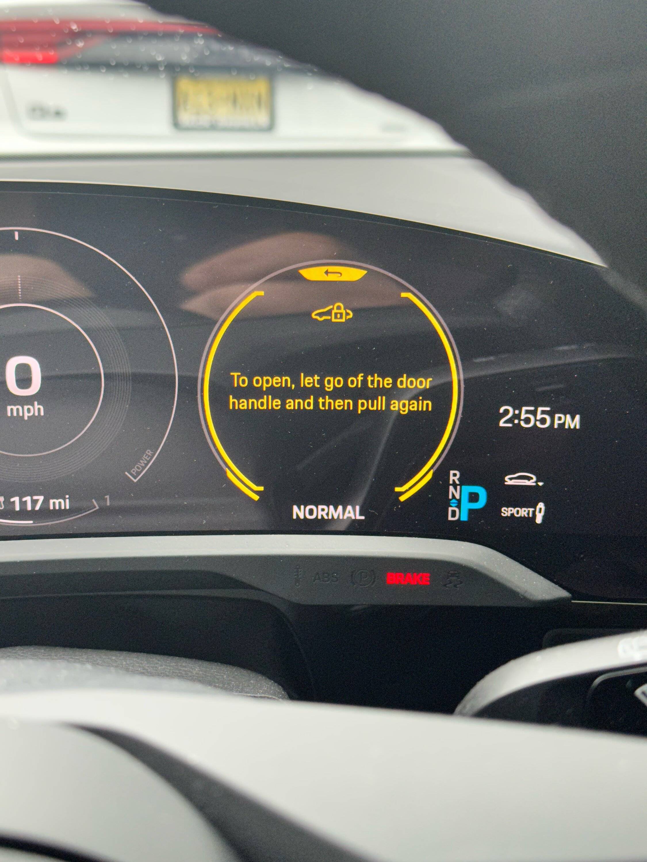

Hi Folks, anybody got such weird issues. Message like this started popping out on the tube. I was able to identify that it is rear driver side door, but the only issue I see with it, that it requires to pull handle a bit stronger/further then other doors. Tried slamming few times, left car for some time, but it still persists. Dealer visit?

So this happens when you pull on the interior door release incompletely and it doesn't open you then get this message. The message may lag from the failed door open attempt.

It is possible that son was not fully pulling interior handle, but not sure how to get rid of this. Only dealer visit? It is not only annoying message each time I get in car, but also worried not to damage handle because of increased force needed to open now.

Is your door opening electronically from the inside or are you having to use the manual override? I had this message... The rear left door wouldn't open unless I used the manual override and the locking mechanism had to be changed by the dealer.

Thanks for advice. I probably didn't fully realize how it worked. Now I checked and indeed other 3 doors opens easily both from inside and outside, so that's where electronic asset works, on this door both inside/outside it seems mechanical part only works. May I ask you how long it took them to replace it? I'm asking because there is great difference in service appointment availability if I select to come and wait there or get loaner.

Mine was in for a half day for diagnosis and another half day for replacing the faulty part.

I was getting that issue after I had to use the manual key. Since the car is dead at the dealer, no way to know yet if it was related to my using the manual key or not.
