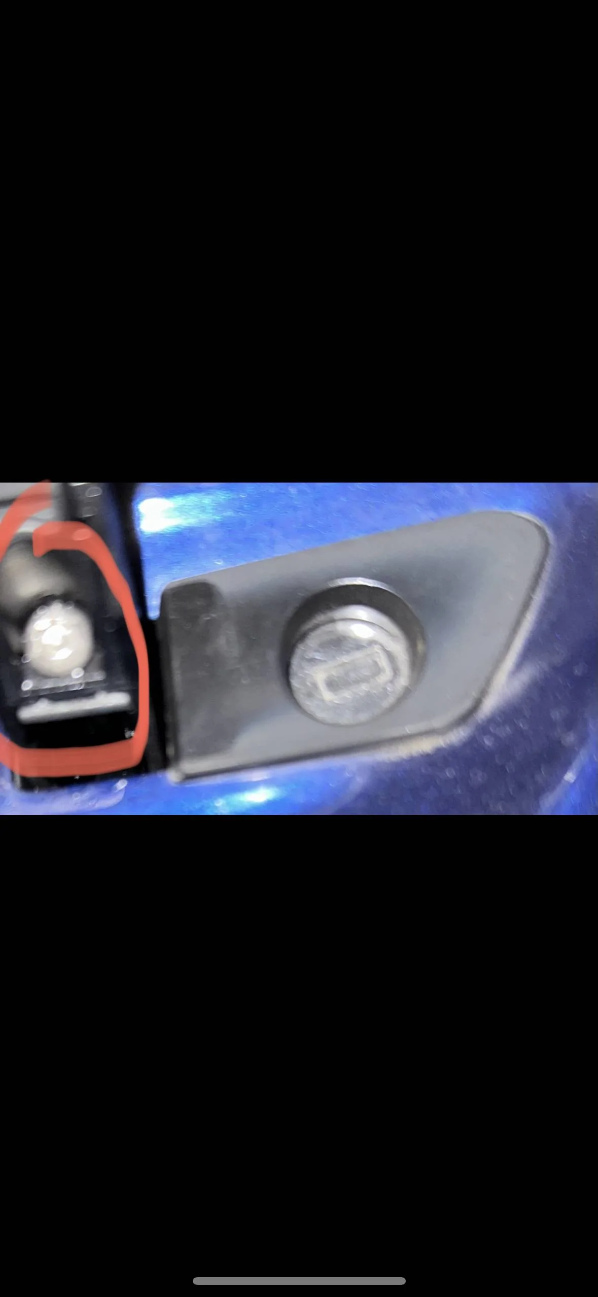

Anybody figured out how to lub them by themselves?
rim23
Feb 14, 2023
173
That turned out to be easy - pull the handle as much as you can and apply some lub (I used a stick for ear cleaning) right on the mount behind the screw (see the pic)

Best to use either silicon spray, or silicone grease. Both are safe on plastic and rubber. WD40 and other petroleum based lubricants do bad things to plastic and rubber over time. For the door handles, the spray is probably what you’re looking for.
rim23
Feb 14, 2023
173
Spraying there is not easy. Better to use a stick and just some of the lubricant to avoid having everything in this stuff
