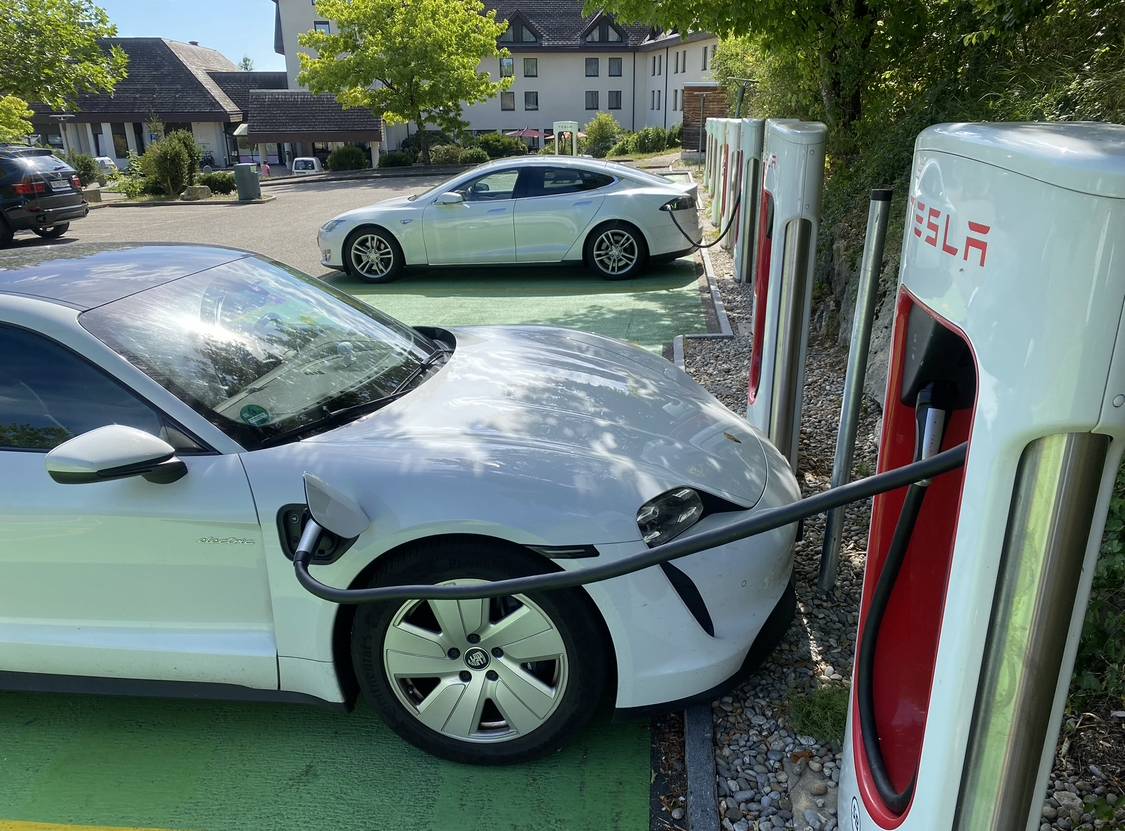

Hi. I assume some of you have used the tesla superchargers to charger your taycan. Can you confirm the approx time it takes to go from say 30 miles to 230miles. Can you also confirm how easy it is to do once you pull into the tesla charging bay and connect. How do you pay? Do you need an app etc?
Thanks Lewis

I have used Tesla 3 times. Two V2
Chargers. First one just to try and I couldn’t park close enough and had to take two spots. Just 2 minutes to see if it would work.
second V2 150 Kw was last weekend. I preconditioned and was at 35% SoC. Still only had 66 Kw. No one parked next to me left and right. 4 Teslas charging total 10 chargers.
I used a v3 250 kw charger last winter and it gave a message charging was limited to 100 Kw by the charger. Not a big problem because we planned to have dinner anyway.
so from my experience charge speeds were not great at all. However both times I had used them because Ionity stations were too busy. From that point of view I was happy they were available. Connecting is fast and easy.

Do you need an adapter to plug into the Tesla S/c?
In the US the chargers opened up have a “Magic dock” installed to convert to CCS1, what we use in the US and Canada. In Europe and the UK Tesla had to use the standard CCS2 connector every other EV uses so no adapter required.

thank you very much - crikey thats a short cable!
hopw would I know if i have the 150kw charging option?
It is very short. So short you have to park in the bay on the right to use a charger situated on the left thereby hogging two bays unless you are at the end where you can park in the adjacent none Tesla bay. 20% to 80% takes about 90 mins at 50kw. It's slower but there's normally plenty of free bays at the one use.
