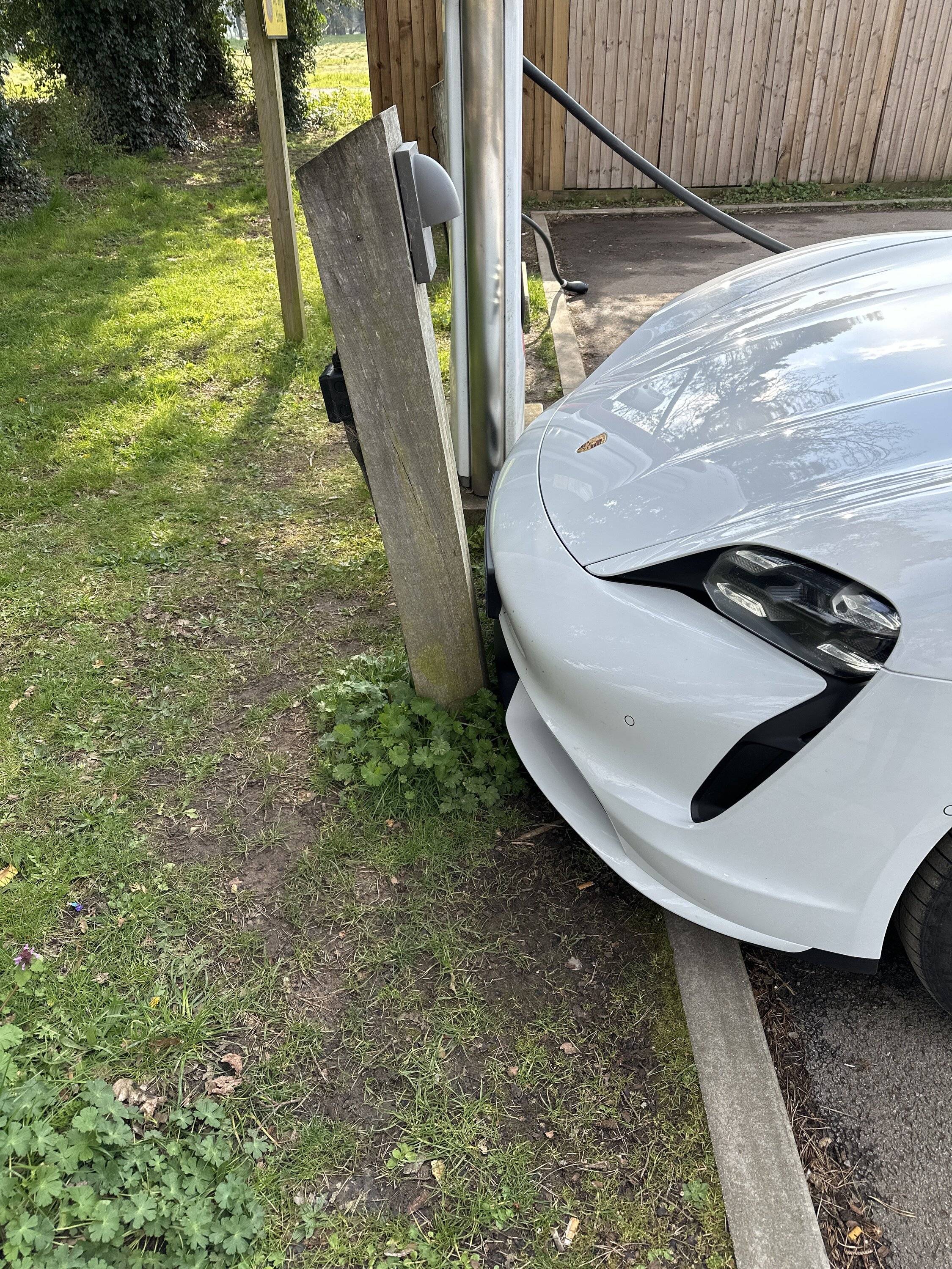

Hi. I assume some of you have used the tesla superchargers to charger your taycan. Can you confirm the approx time it takes to go from say 30 miles to 230miles. Can you also confirm how easy it is to do once you pull into the tesla charging bay and connect. How do you pay? Do you need an app etc?

Yes I have done so multiple times.
You need to check that the SuC has chargers positioned “side ways” else the cable can be very short to reach the Taycan.
Secondly you need to have the 150 kW option for the charging in your Taycan to get up to 150 kW. Else you will be limited to 50 kW.
You do need to have the Tesla app to pay and register a payment card in the app. You will find the chargers under your account option “Charge your non Tesla”.
once you pull up at a SuC, identify the charger location on the map and choose the charger that is free and numbered like 2a, 3c, etc. . Simple plug your car in and tap the charger number and click start charging.
It will start very quickly to charge and is very similar to a normal 150 kW charger.
In my experience they have all worked superbly and never had any problems.

thank you very much - crikey thats a short cable!

1) To pay: it is easy. Just download the Tesla app. Register. Link to credit card. At the charger: choose the charger on the map. Select the specific charging station. Start charging.
2) To connect: before driving to a Tesla charger check in apps like Chargemap photo's of the charging location. You can check the orientation of the chargers. If they are 'next' to the parking spot, it is fine. If they are in front of the car and there is no high curb between the charger and the parking spot, it is fine. If they are at the front of the parking spot and there is a high curb between it, the cable is too short.
3) Charging speed: Maximum speed is 134 kw. I would count with an average of 120kw if you start low and go up to 75-80%. That translates to 10 to 14 minutes to charge 100km. I personally count that a charging stop at a good charger like ionity of fastned is 15-20min. At charging stop at Tesla is 25-30min.
Yep. Tesla chargeports are at the back, so a long cable isn't needed. Tesla will likely have longer cables on their newer chargers.
I have used Tesla Superchargers in New York state and they had several installed so that you could pull up to them on the SIDE..that made charging easy IF those are available..(otherwise you take two spots - a technique to be avoided if at all possible!)
