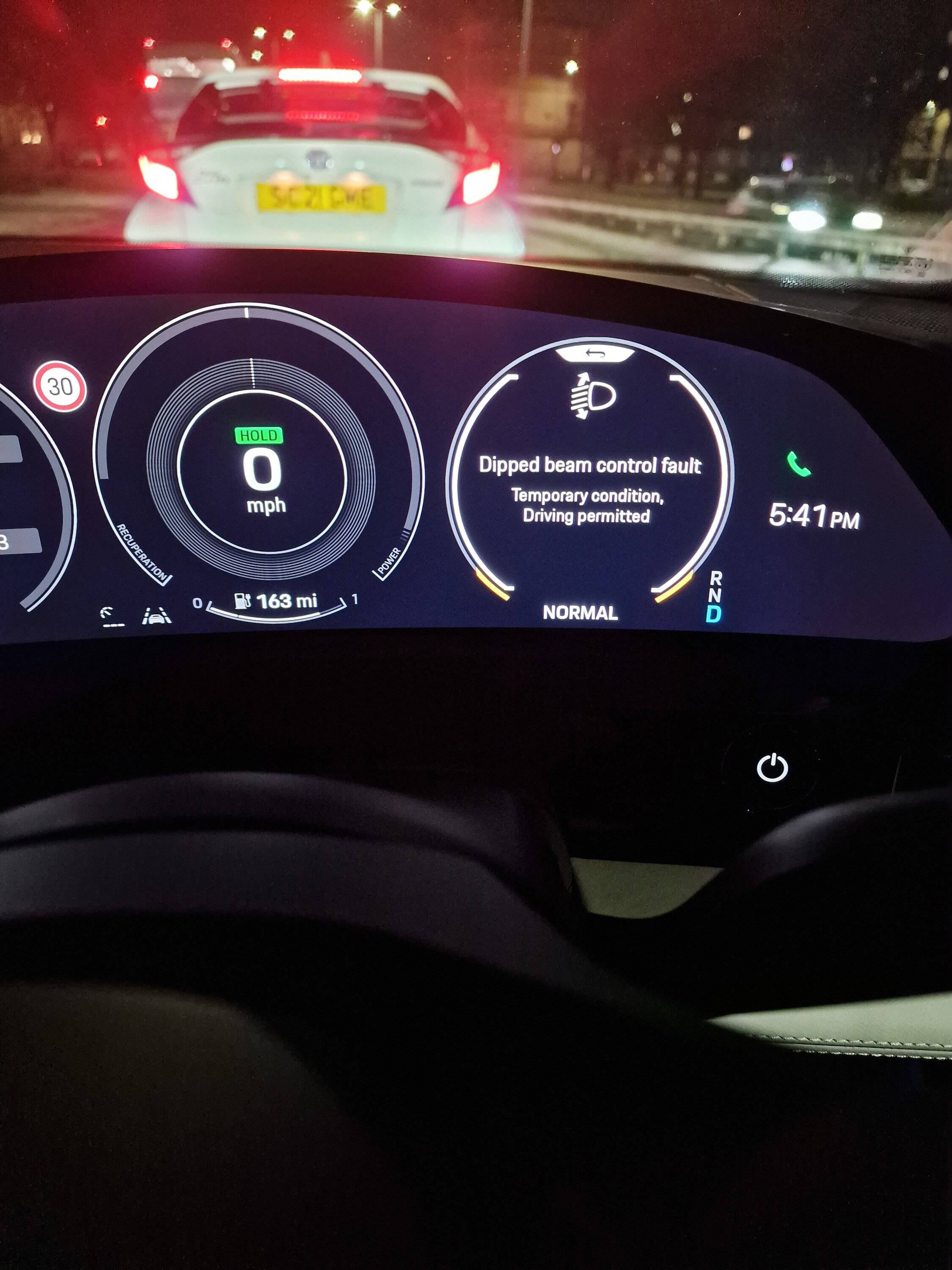

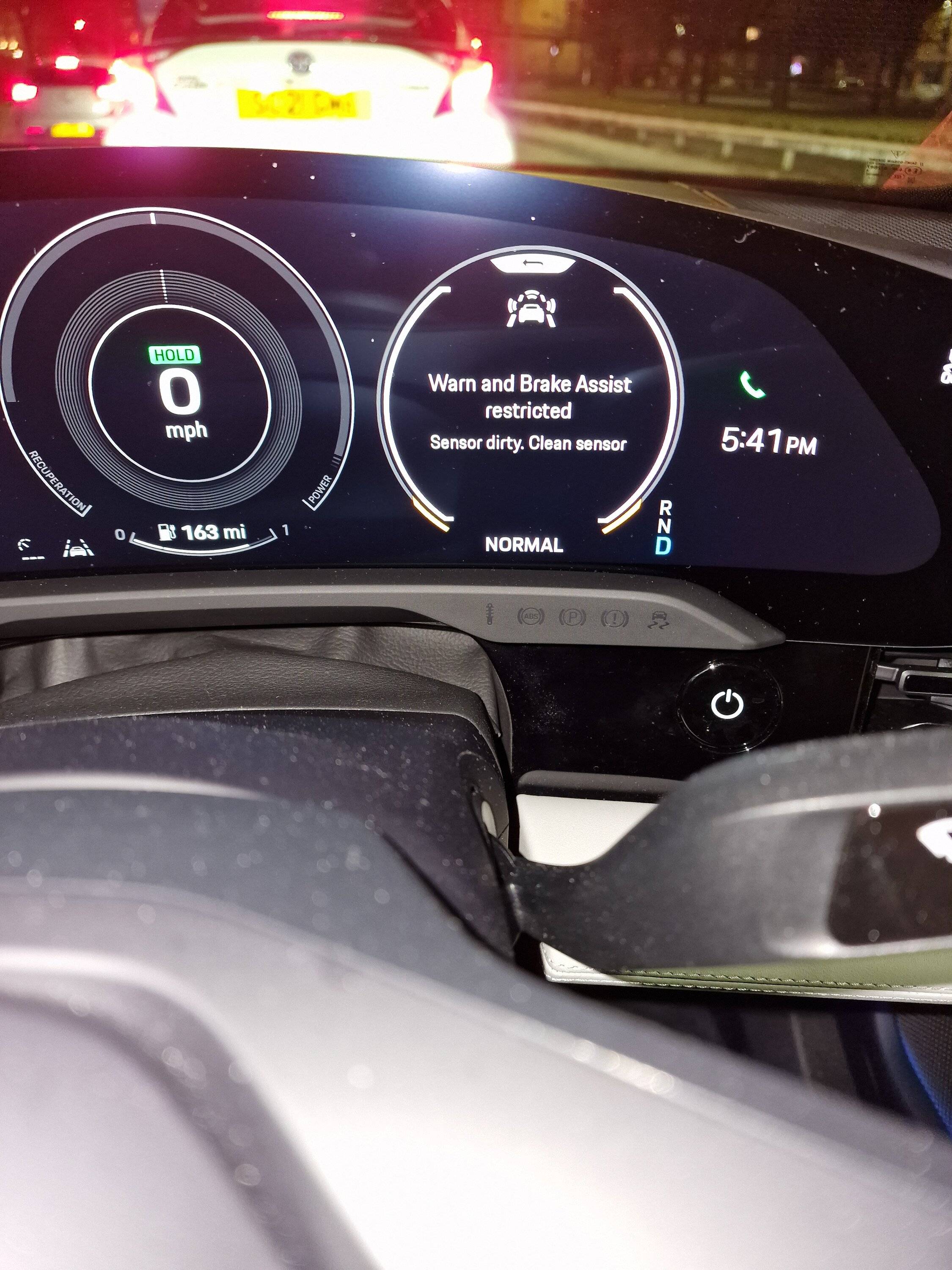

Hi all
These warnings have come up a few times last few days due to the bad weather and muck/grit on the roads.
Where is the sensor/camera for this? Is it behind thd rear view mirror or below front bumper?
Thanks
Porsche Taycan Warning lights and sensor position 20221212_174150
Porsche Taycan Warning lights and sensor position 20221212_174137

Hi all
Thanks
It's the camera in front of the mirror and the front bumper sensors
If you have ACC optioned then the front radar dome (as per photo) at the front may also contribute.
You'll get these warnings during ice weather or dirty / damp sensors and camera.
Normal behaviour and generally self clears

I had exactly the same last two days, it’s was the sensor on the windscreen at the mirror it was fogged up on the inside of the glass it cleared up after a few minutes as the car warmed up

Had this on my car yesterday and a dipped beam control fault. Both went away when the car warmed up.
