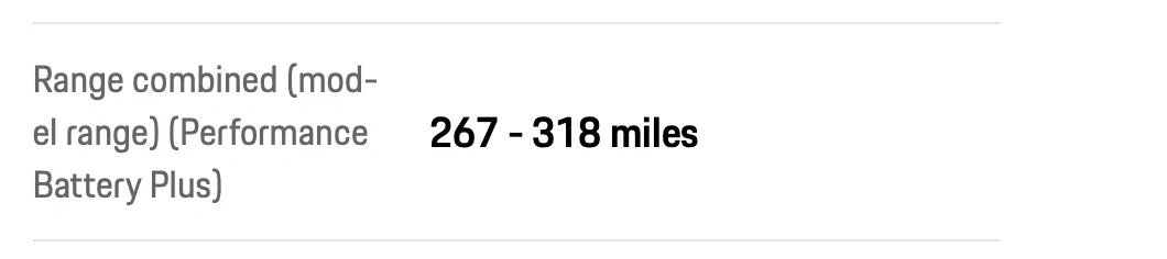

Hi Archimedes, quoted range for performance battery by Porsche from the website is
My question is has anyone achieved this or even close to this as in the 2 weeks i had the car it never indicated anything more than 210 miles in range mode. Taking account of cold weather (say -20%) it should say 254 miles.... I have an electric yacht and the slower you go the further you go (massive difference). I was wondering if I have a defective battery and thats why the question. I'm looking forward to getting the car back from the garage and driving really slow zzz to see how far I can get. I realise its completely un Porsche like and it should be driven as though you have just stolen it ;)
