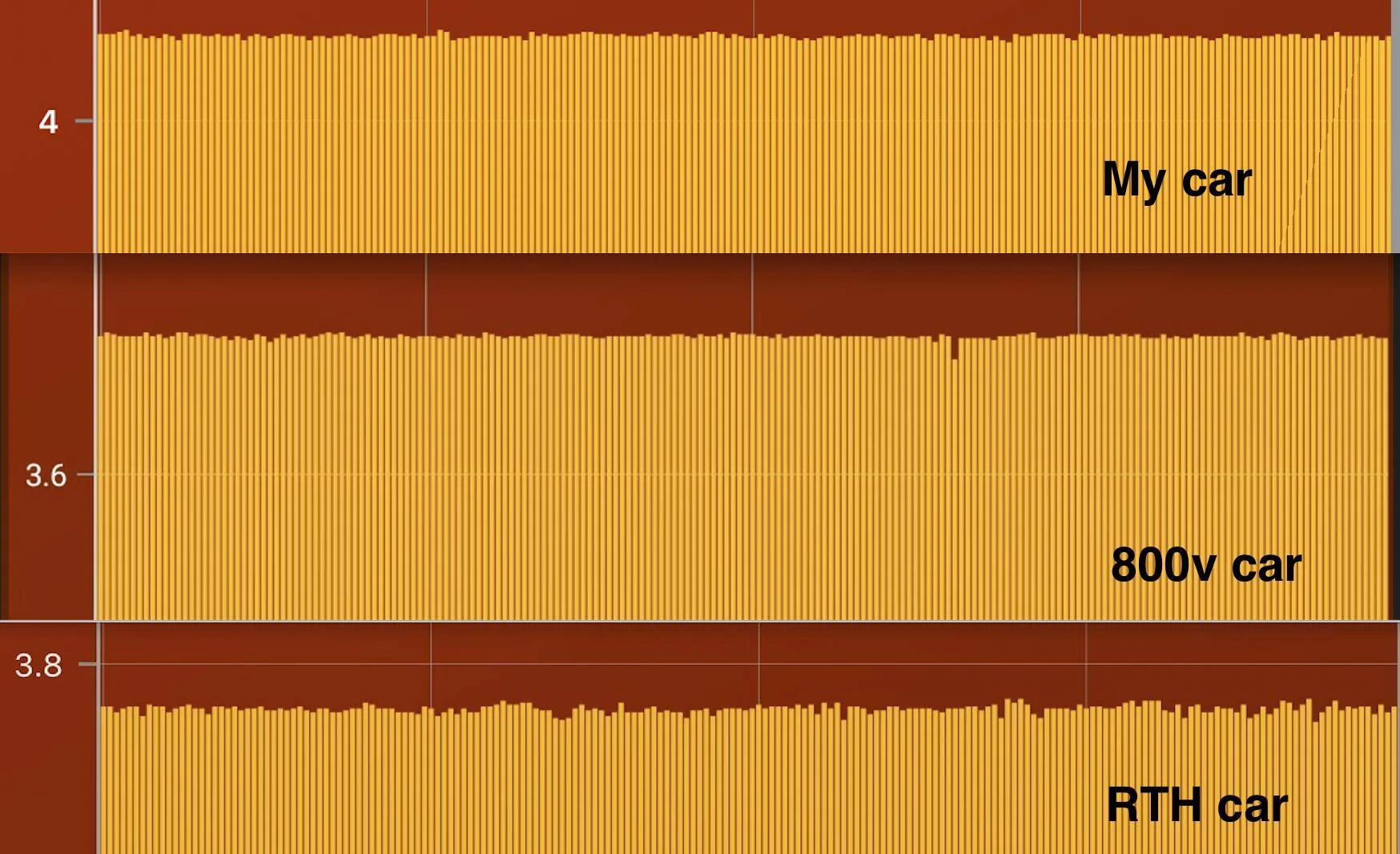

Whilst I agree with a most of this and in fact suspect his car is simply on the low end of the Hot-Warm climate SoH degradation curves I would add:
1) this 'third party tool' or OBDII (many of us have used on all our cars for decades) has been used here on 50 Taycans in this Forum with 76 readings and his car has the demonstrably lowest reading to date - so even if you don't trust these tools (I personally believe that they are likely fairly accurate in respect reporting what the PCM is reading) you can at least say that you have 76 readings which are consistently taken with the same tool and show his car to have the lowest observed value (whatever that might truly mean) - and yes lots of variables add a consistent margin of error of +/- 1% on all readings.
and
2) in respect Cell voltages - they're values of course related directly to SoC and indirectly to battery health and from what I've been told, variations in the 10 mv range may be significant. So for example here are 3 maps from RTH, 800V and my car and I'd argue there is more 'chatter' in RTH's cell values in that 10 mv range - I realize it is minor but at least observable. Again does this imply any causal link between his low SoH and cell integrity - I can't say definitively and I'm also certainly am not the one to ask :)!
Again my advice given was to have the dealership test his SoH and start charging with newly available AC - and further do additional measurements with the OBDII - as again, I suspect the larger issue here is that our Taycan's HV battery does not appear to stack up very well against Tesla data published to date (new separate thread) and basically, what we have is what we have!
Cheers, C.

I'm 99% sure that those cell voltages will align with a slow charge from very low SOC to 100%. In the old days, lipo balancers would only start to burn off excess voltage when in 80+% range and would only actually balance the cells if the charging was very slow and close to full. most balacing would happen near full i.e. 95%.
Note that balancing (which sounds high tech per se) is nothing more than discharging individual cells while letting other cells "catch up". This "burning off" has to be performed at low charge rates or the balancing can't cope with the generated heat. There are physical limits.
I bet that when we see that downward curve even on low speed charging, it's when the balancing is starting (which is also the time we disconnect from the charger and move on lol)
Ah - so implying that if RTH's prior charging by almost entirely DC vs the other 2 cars entirely by AC that this might explain the chatter in his snapshot of the current SoC?
