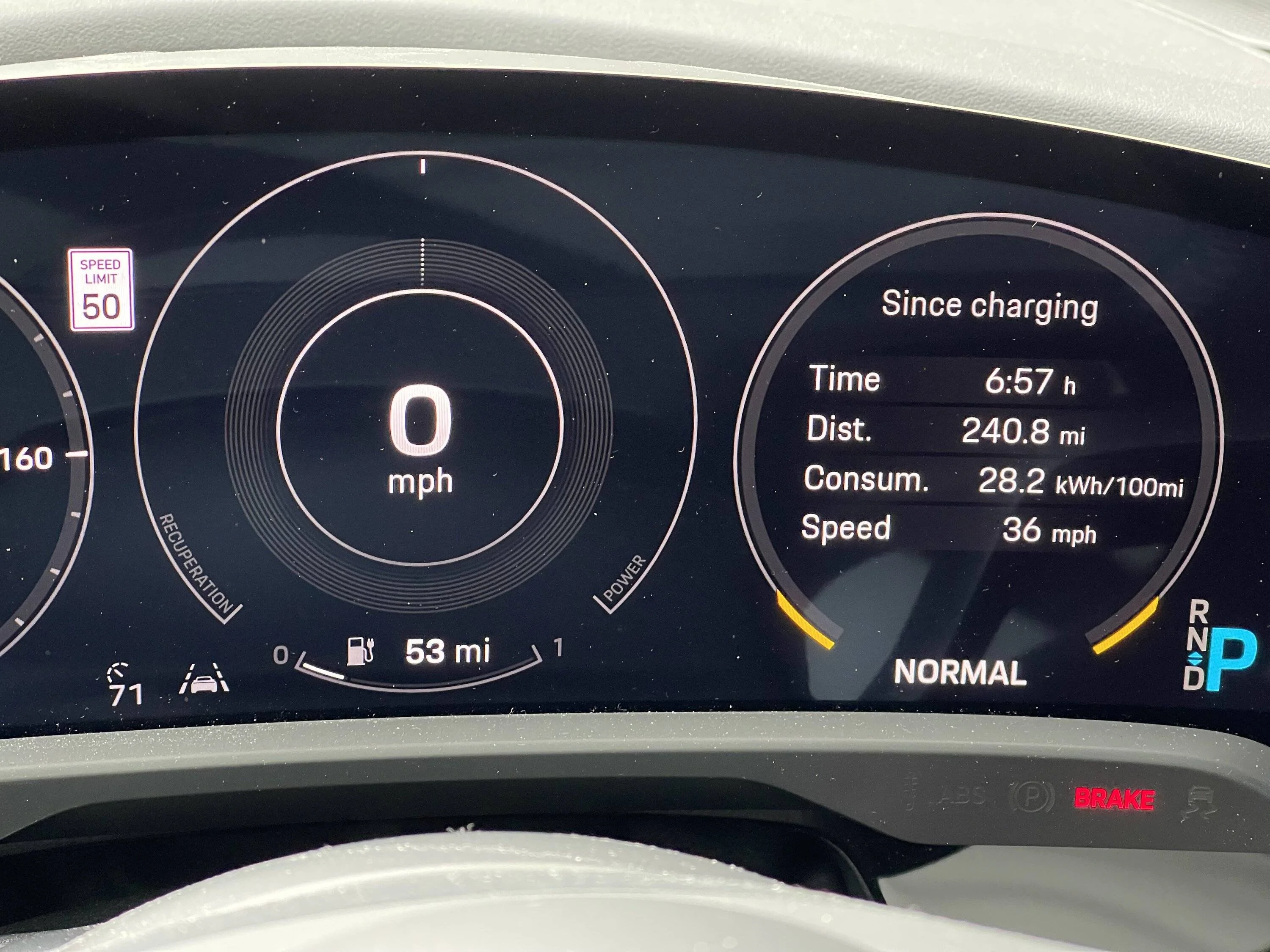

2022 Taycan RWD about 10k miles on summer 21” tires.
Went to a wedding in New Jersey over the weekend. Hot so the A/C was on the entire trip.
Started with 100%, drove 241 miles, guess-o-meter showing 53 miles still available. I think the 53 mile number is pretty accurate since I kept an eye on miles to go in Waze and miles available in the PCM. Both tracked well.
Note: on my Tesla Y, while I think the potential range is about the same as the Taycan, I am getting killed with phantom power drain. I need to charge after driving 120 miles over a week.
