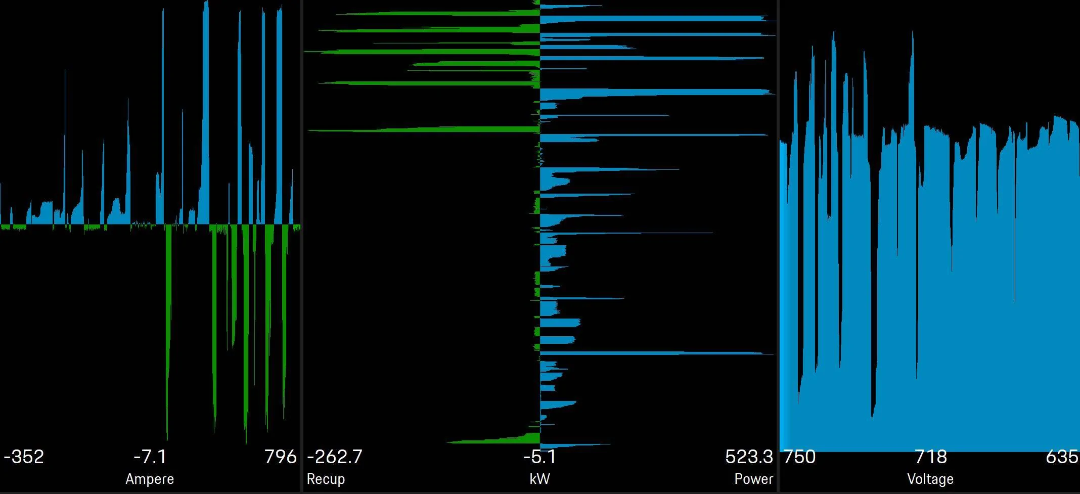

some real life facts in this interesting discussion.
this is a short extract of a logging drive session* with a Taycan Turbo with some full acceleration at 90 kph with 23°C battery temp and 50% SoC
Porsche Taycan When will Porsche release a 1000HP Taycan? 1650957544066
it already shows 796A current draw with voltage dropping to 635V.
So the math is never correct to calc max amps with a fixed 800V value.
(*the windows tool will be published soon as a free to use tool for non-commercial enthusiasts)
Of course, the max amps time nominal voltage only gives you theoretical upper bound which is not practically reachable (due to internal cell resistances, wiring and other parasitic resistances in the system like connectors). In other words, if the max amps times nominal voltage doesn't come even close to 1000hp, the battery is guaranteed to never be able to deliver 1000hp.
As a side note, at 796A, it will make a difference whether or not you're measuring the cells voltage by adding up the individual voltages reported by the 33 CMCs (Cell Module Controllers), or if you measure it at the battery output, or at the motor input (will even be different in the front of back motor). Current on the other hand should add up, though keep in mind not all current goes to the motors (some goes to DC-DC converter, some to HVAC, etc) so current from the battery is not exactly equal current to the motors.
How will this tool collect the measurements? OBDII scans? I'm curious.
indeed there is a distinct "cell voltage sum" diagnostic value I'm logging. Did not realize they divert too much. Will have a look.
yes, UDS scanning through OBD2 port.
