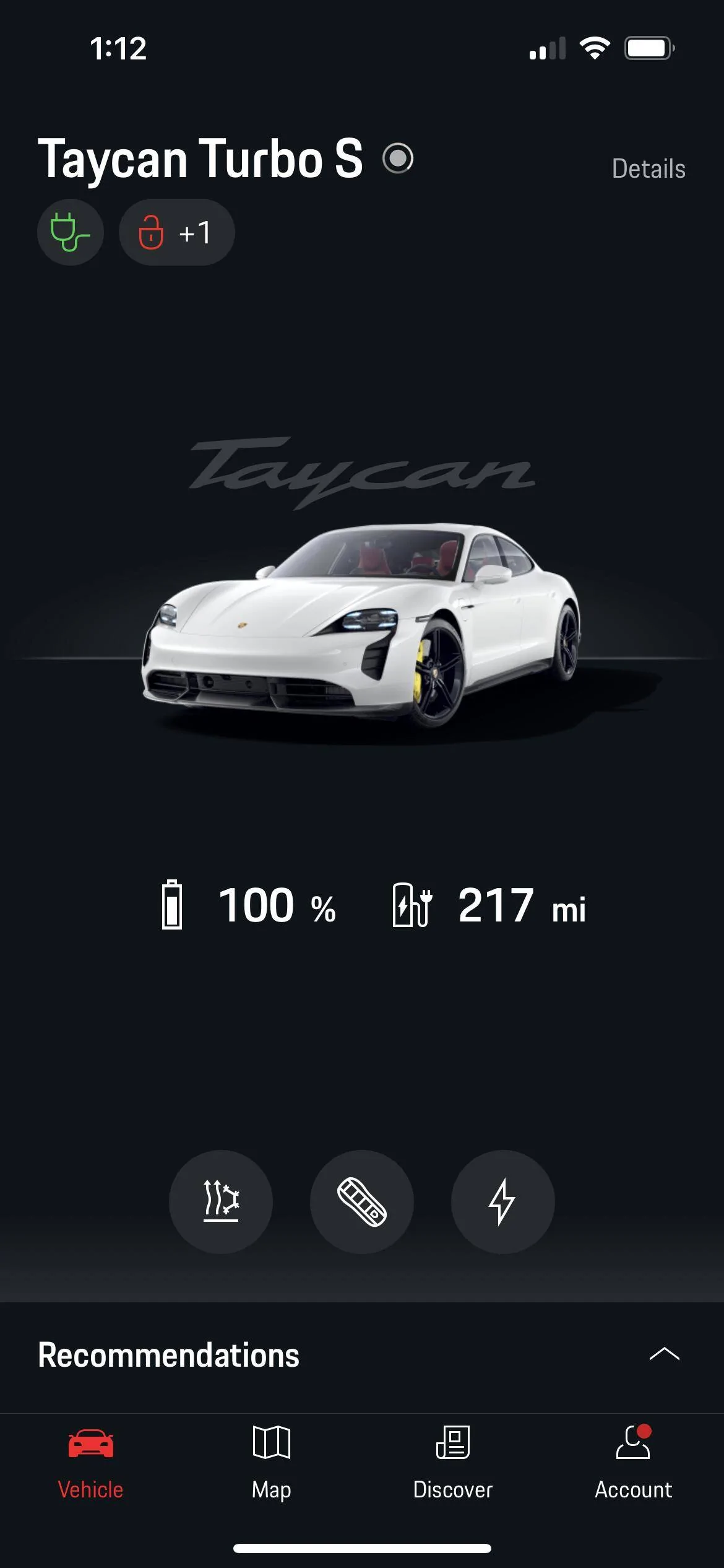

I picked this car up in May of 2021 and very few of these were out yet due to covid. I used the superchargers alot in the beginning of ownership. They worked flawlessly before the crowd came into Evs. There was a thread on here asking about battery health for longer term owners. I charge it always on level 2 due to the overcrowding of super chargers now.( unless i have to drive long distance) But at 100% in summer i still show 217 miles of range. Im sure somebody can figure out what their new TTS shows at 100% but thats what mine shows. I dont think thats bad at all battery degradation for the use that it has had to date.

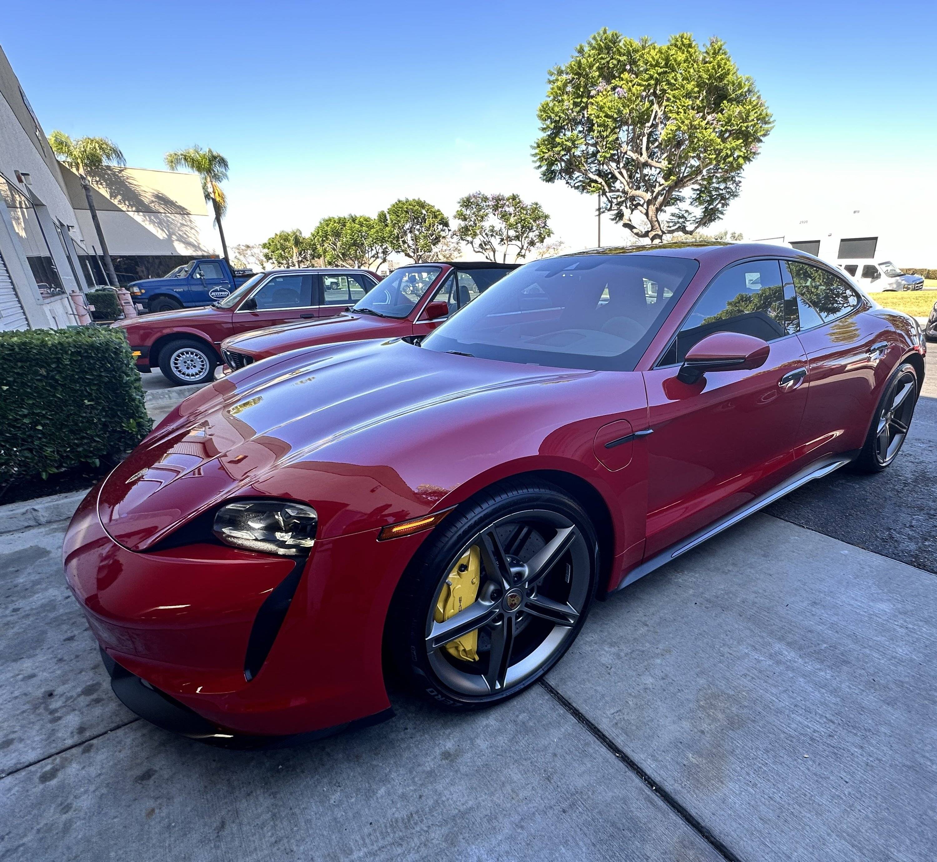

Appreciate the review. I am loving my 2021 TTS also! I also don't do launches. I just drive it and keep it in Individual Mode (sport, sport, regen on, low, noise on) and love it. What a car! I have a brand new 992 911 Turbo S and a 2020 Cayenne Coupe e-hybrid. Just sold my 2022 Macan GTS and 2023 992 911 GTS cab (loaded)... and now... I just always gravitate to my Taycan Turbo S. Here is a pic right after I had the PPF done.

Beautiful car! Im curious... Do you still find that you gravitate to the TTS even though you have a 992 turbo s? The comfort you have with the taycan is next level with the option to dial it stiffer in an instant. I recently bought a 2023 bentley gt speed. But thats next level to the taycan. My biggest frustration with the taycan is the supercharger network and getting into the car the B pillar is forward and you can whack ur hip good if you dont pay attention :). But the overall package with the taycan is impressive.
