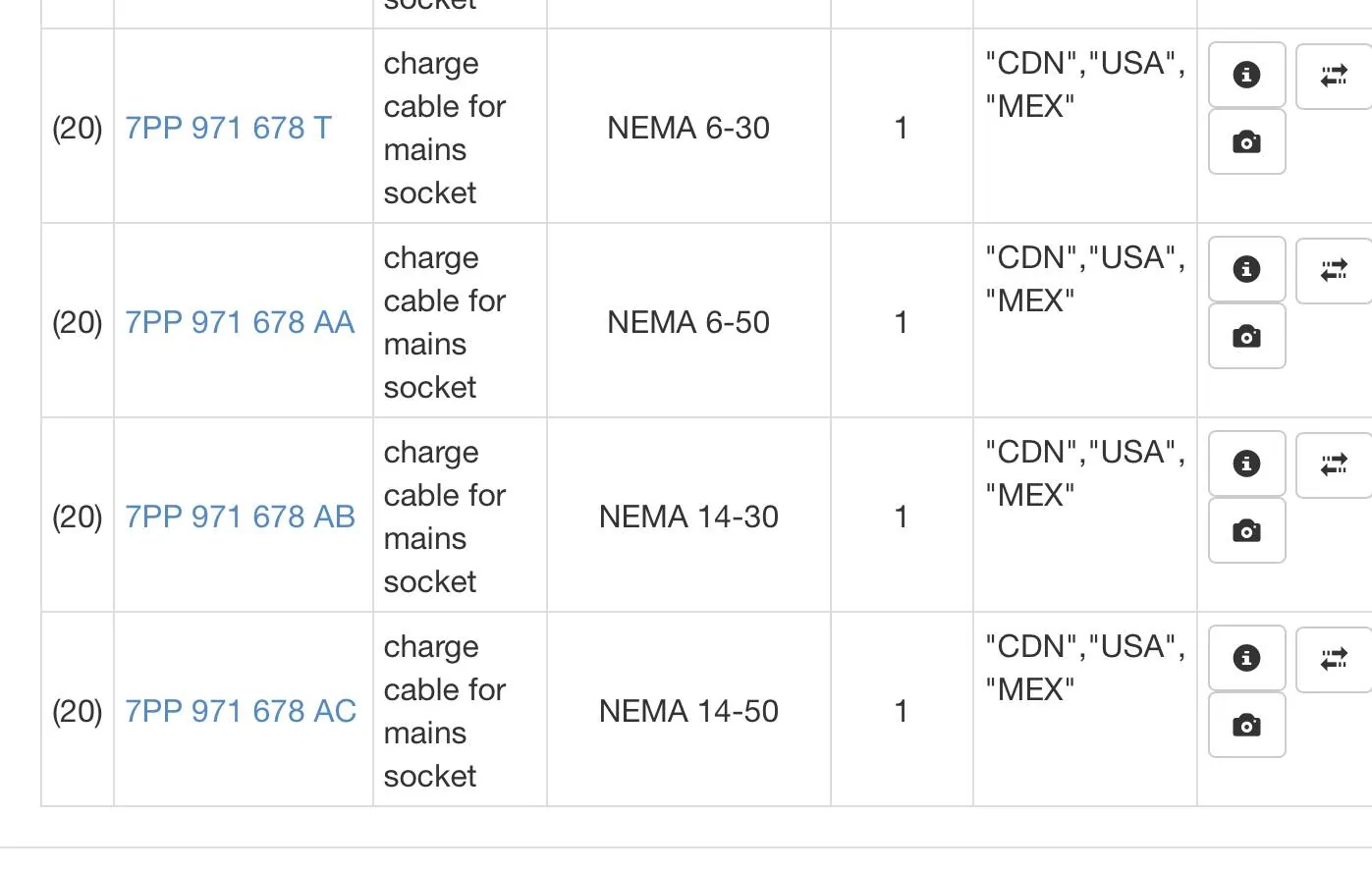

Just moved into a condo building that only has 14-30 outlet. I don’t see that OEM pigtail in Porsche parts but I could be wrong. Can I just pick up a 14-30p-14-50r adapter on Amazon and make it work with the PCC+?
no it would be unsafe - since the PMC+ would not know it’s plugged into a 30 amp circuit - there is a 14-30 supply cable from porsche - your dealer can assist you with ordering it - however for what Porsche charges for just the supply cable you can almost purchase an entire extra EVSE - so it’s your call…
but your going to want to use the correct cable so that the PMC+ “knows” what type of plug it’s using and will adjust the charging amps to match the maximum allowed load.
your dealer can assist you with finding hte part number for the 14-30 supply cable - it’s the same for VW/Audi/Porsche - and the EV chargers are shared across all the products.

here is a PDF of all the ”parts” for the Audi EV chargers - NOTE: these chargers identical to the Porsche EV chargers…it includes the part numbers for all the supply cables…

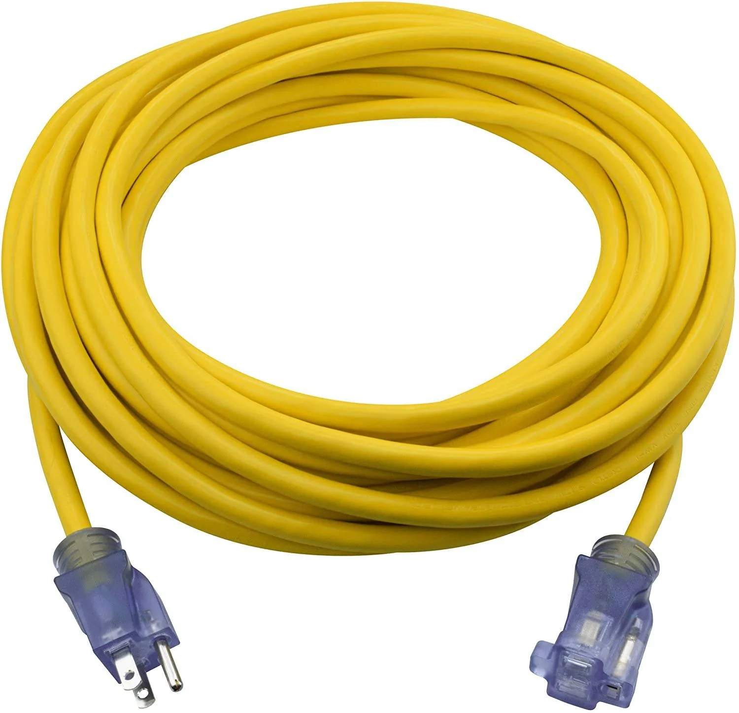

I’m anticipating my first road trip in December. I have the PMC+ and will be visiting family for multiple days. Due to the layout of the home, there is no practical access to a NEMA 14-50 outlet. So I will be on level 1 charging. Access even to a 110V outlet in the garage will not be easy - I’ll be parked at least 30 feet away, outdoors. Would I be safe using an outdoor extension cable with the PMC+?

if it’s a high quality 20 amp extension cord I would be un-concerned - some sort of industrial grade/construction-site “yellow” extension cord that is thick and heavy duty should be fine - but it’s your call - follow Porsche’s advise or take a well considered chance that all will be well.
I’ve used extension cords to charge my EV’s in the past - I believe Porsche’s advise is CYA and also when people say “extension cord” - not all cords are equal - and it’s certainly not a good plan to use low end indoor “light weight” extension cords. You need something rated for a full 1800 watts - not just any extension cord say for a lamp or TV…

I would be hard pressed to see how anything like this cord presents any serious risk…I’d recommend paying the extra $7 for the “lighted” version - which has a small LED light in the plug ends so you can “see” that the cord is powered…
this is 12 gauge wire, 3 conductors (hot, neutral, ground) and rated for full 15 amps - and the PMC+ with the proper supply cable attached (NEMA 5-15 supply cable) will pull the recommended 12 amps - make sure the plugs are well seated and keep the plugs out of the wet and I’d be mostly nearly completely un-concerned - check in on it periodically during the first few hours and make sure it isn’t getting too warm and nothing is melting at the plug ends and it should be fine.
Clear Power 25ft 12/3 SJTW Yellow Outdoor Extension Cord w/Power Indicator Light, CP10147

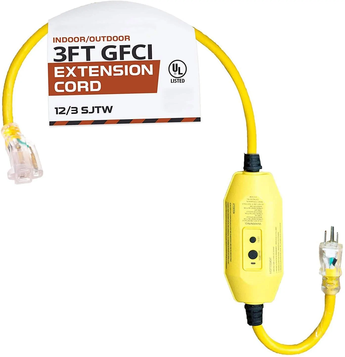

extra credit - also buy one of these pig tails - GFI - this will add an extra layer of safety should there be a short due to wetness…
  1. plug the GFI adapter into the outlet
  2. plug the exention cord into the GFI adapter
  3. plug your EVSE into the extension cord
charge the vehicle via the EVSE - check in on the whole thing periodically - cease/desist usage if anything feels “hot”, smells funny (burning plastic), or is visbility melting, or it’s ”wet”
if the GFI or breaker keeps “tripping” - then also recommend not using it - because these safety items “tripping” means something is going wrong.
IRON FORGE CABLE 3 Foot Lighted Outdoor GFCI Extension Cord - 12/3 SJTW Heavy Duty Yellow Pigtail Extension Cable with 3 Prong Grounded Plug for Safety, 15 AMP

* - note -when not using the extension cord plug EVSE into the GFI adapter for added circuit safety.
