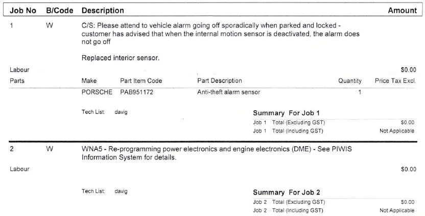

Had my alarm service carried out today, can confirm the problem is fixed. I tried both ways of replicating the false alarm and both failed to trigger it.
FINALLY!!!
New part number is PAB951172 as already confirmed by others.
I also noticed that the Alarm service has disappeared from the Porsche Connect / My Porsche functions list (visible when you log in on a web browser.)
EDIT: Kept the car locked overnight and played with the My Porsche app this morning... still no alarm!!! It's fixed :clap:
Did Porsche make you remove the Fitcamx first?

Ahh thanks for asking, I knew I forgot something.
The Fitcamx stayed there the entire time, they didn't mention it.
