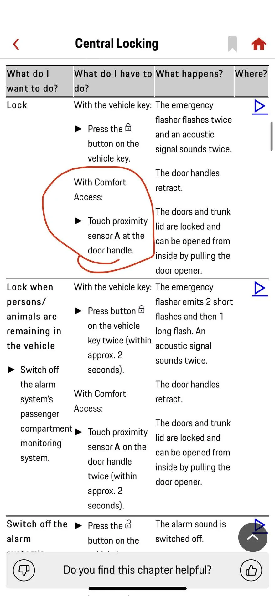

My car has comfort access and it does not do this. When I get out of the car, I have to touch the little indentation on the door handle, then the car will lock the doors. Also, if my phone is in the same pocket with the car key, sometimes it interferes with comfort access.
Try this Tony. Lock the car and walk away. Come back and (key in pocket) walk close to the car. The car should unlock. Do not open the door. Walk away (i think you have to be 19.5 feet) and watch the car and you should see it lock (lights flash, door handle close (mirror will not fold up)).

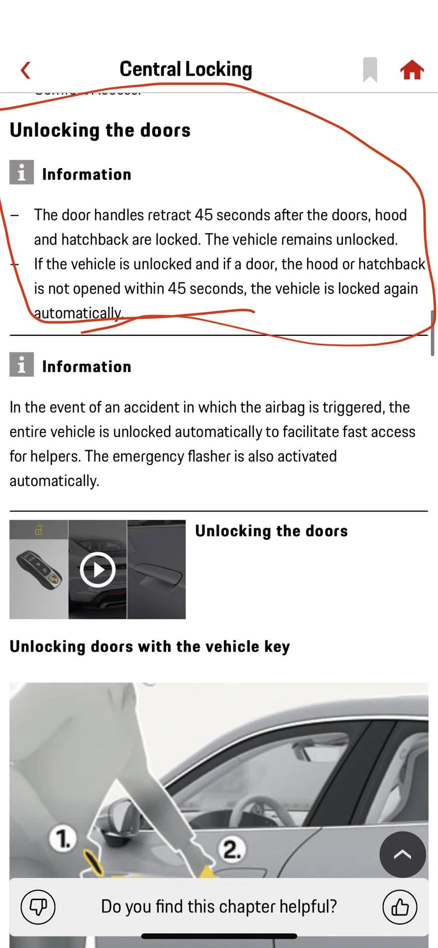

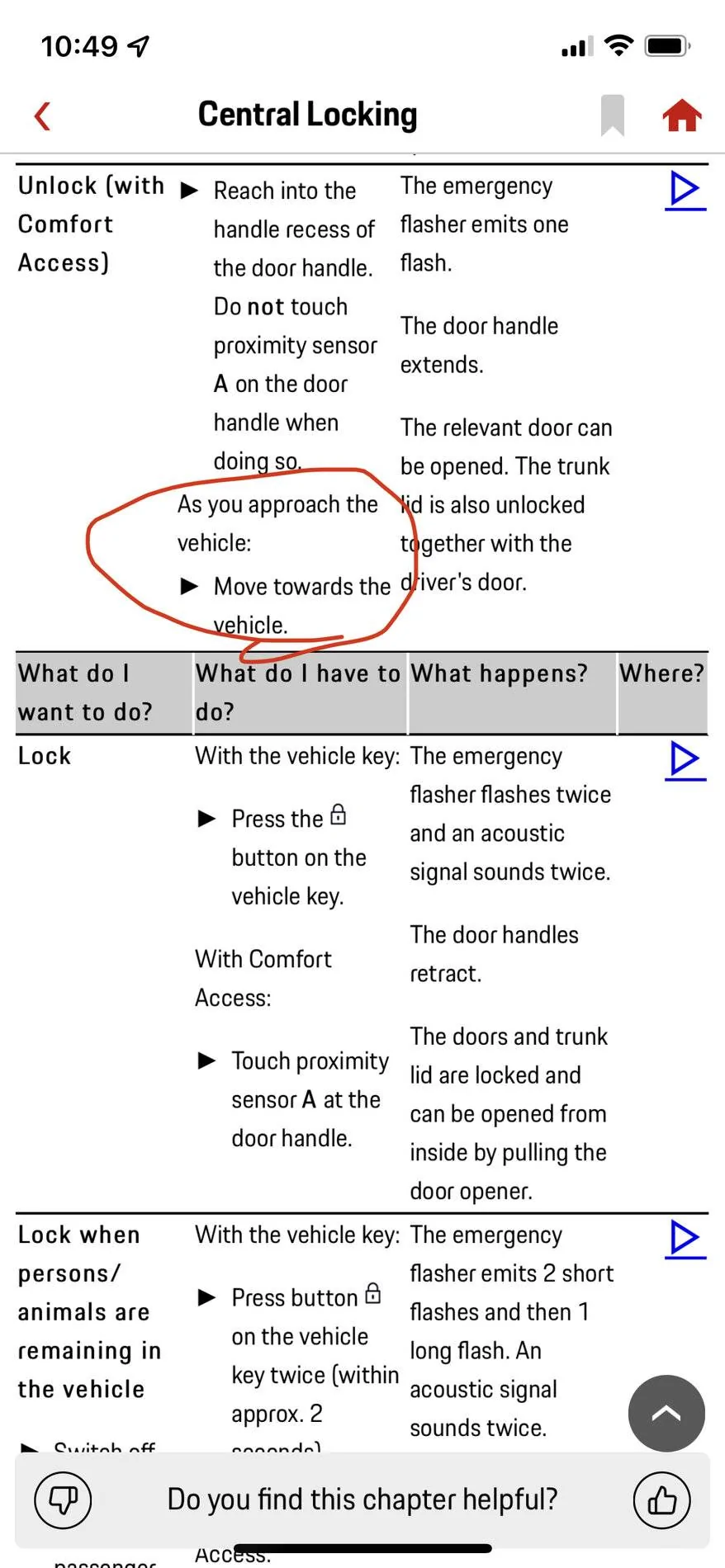

All these questions are answered in the Good to Know app:
I read the PGTKA. It does not discuss the operation of the mirrors folding or not folding with the automatic locking feature. It does mention "locking automatically after the 45 seconds if left unlocked, but is not clear on the conditions that allow that to happen.
If I pull in my driveway and get out of the car and go in the house without locking the car, it does not "automatically lock" after 45 seconds I wish it did this, but I cannot make it happen.
The only instance I can get it to automatically lock is when the car is already locked and I walk by (with the fob in my pocket) and it unlocks (and I do not open a door) and then walk away; the 45 second automatic lock does lock the car (but does not fold the mirrors).
@submatrix are you aware of an automatic locking after the car was in use and parked?
I'm not aware of any Taycan functionality that automatically locks the car in the normal case of parking, getting out, and walking away.

that all makes sense, but don't think it is a work-around as for this scenario to happen, it seems that you have to have locked it at some point, manually.
I think what it is doing is just sensing the comfort access 'unlocking feature' and then realizes that you did not actually enter and access the vehicle, so it goes back to the last default position. Which in this case is the locked status (that again, you had to manually set to at some point). @PDACPA the Good To Know, shows what I am stating......it as an 'unlock' feature, not a auto-locking feature anywhere where you don't have to manually lock it at some point.
