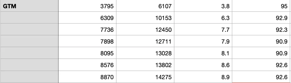

Updated - for ref this is what I have from your posts to date:
Porsche Taycan Baseline for HV Battery SoH Performance Screenshot 2024-01-22 at 2.53.07 PM
Looks like I inundated you more than I remember. Didn't realize you had logged the readings at 7898 & 8576 miles. Mileage and SoH are correct. Not sure what columns 2 & 3 represent but I'll assume they are correct given your attention to detail. Thanks for tracking all this data.
Yep - all your posts are still in this thread :)
2nd column is km equivalent and 3rd a calculation for another chart not shown (about efficiency per Soh pt).
