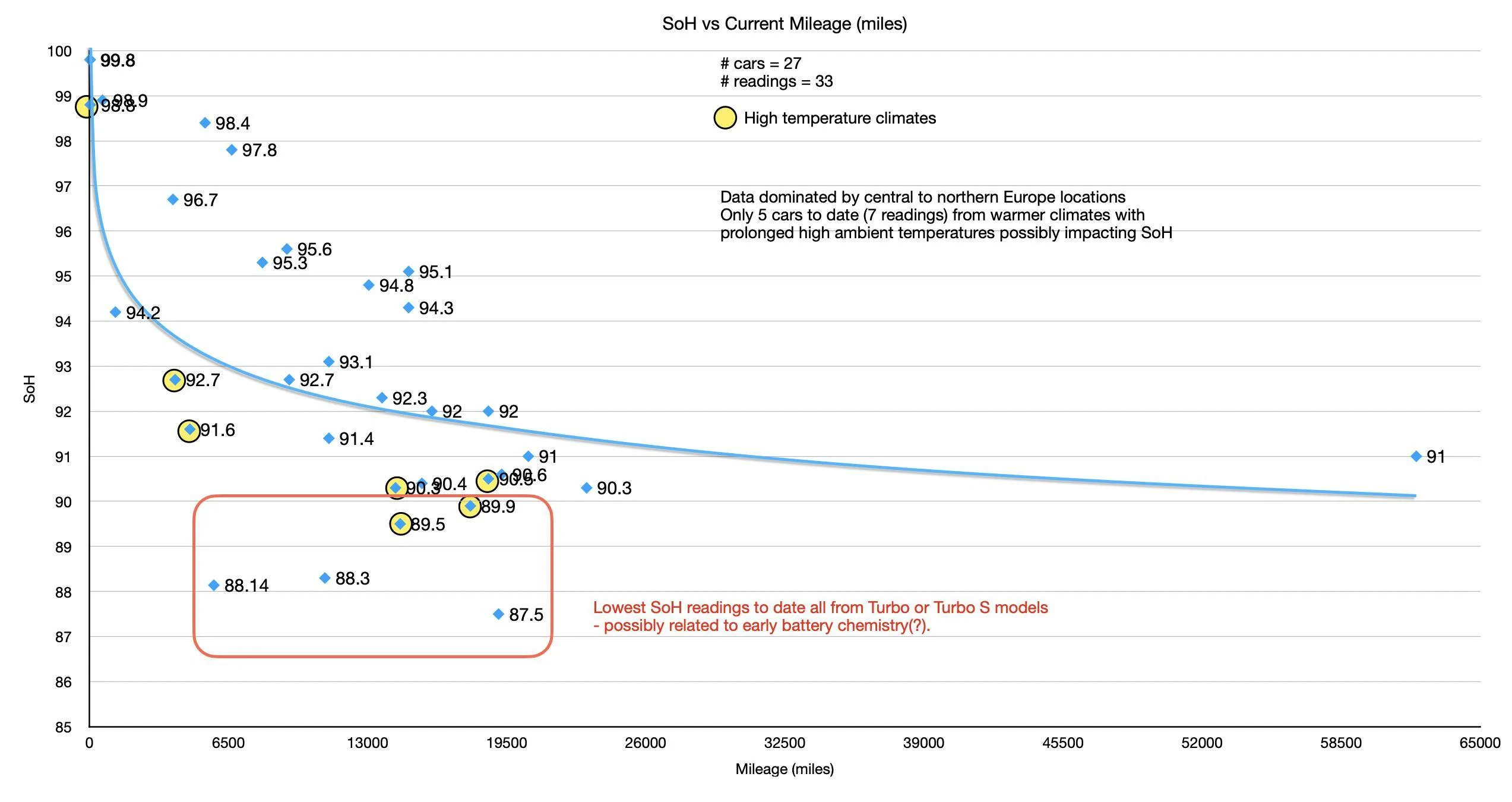

Curiously (and not statistically robust at all at this stage) but 4 of the 5 lowest SoH readings to date are in Turbo or Turbo S models.
EDIT - UPDATED to reflect post by Scandinavian below:
Porsche Taycan Baseline for HV Battery SoH Performance Screenshot 2022-12-08 at 8.05.17 AM
Interesting! I have not been following the Forum much lately, but wonder if you can see if the majority of these curious samples also are related to the first model, MY2020.
I think I saw a post (think by @rs38 ???) about different chemistry in the first model year compared to later cars?? That is perhaps linked here?
Spot on - the data is actually there in the spreadsheet I have posted and keep updated in my first post - all 5 are 2020 (one 2019) builds! (modified chart comment to reflect your post).

The TSB does not say much though -- it may be a slightly different cell without much impact in practice. That is my guess or otherwise Porsche may have made this more public ??
Also, I am not sure if we have enough data to draw any conclusion -- I think in my case the low score is due to a single cell; there is a screen in the Car Scanner that shows all cells as a bar graph and one of them was a bit lower than the rest. My car is in service now (for the Update) but when it gets back I'll post a screen shot.
