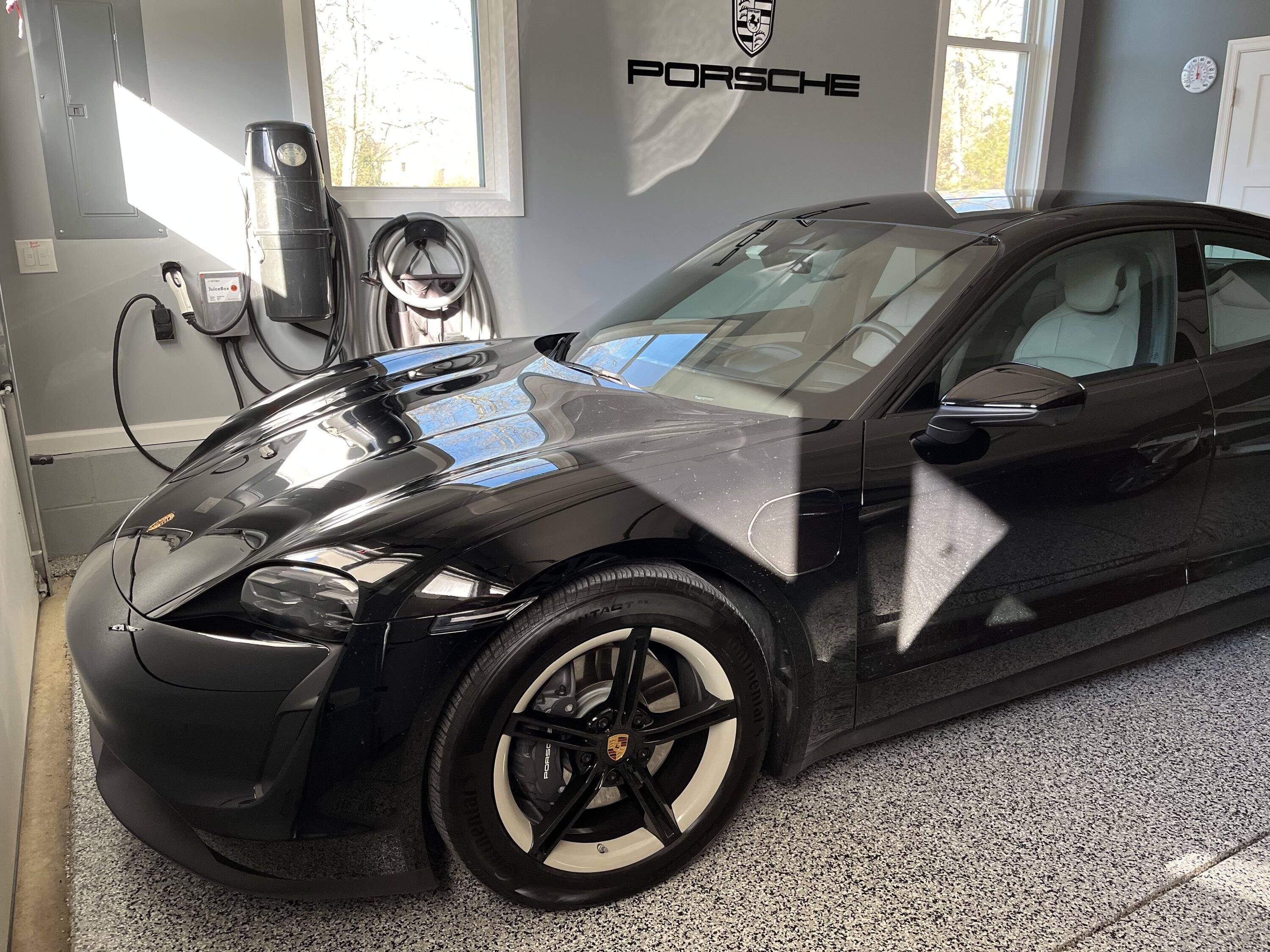

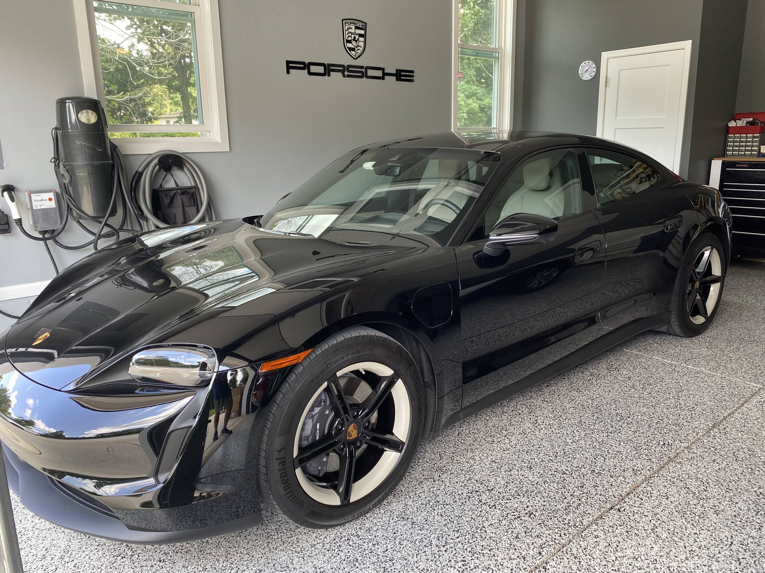

I replaced my stock amber side marker lights with the Euro clear/white side marker lights in my jet black 2022 today. It took me less than 5 mins per side and it makes a world of difference in the appearance. I highly recommend this minor modification!
One note I wanted to call out, many folks who have already made this modification and added instructions stated to remove one screw within the wheel well skirt for easier access to the side marker. Honestly you do not need to add this step, just use a T15 on a ratchet wrench to the fastener that holds the side marker light. Turn your wheel all the way to the side and you can see/feel the fastener. Its just that simple and fast to remove and change out!

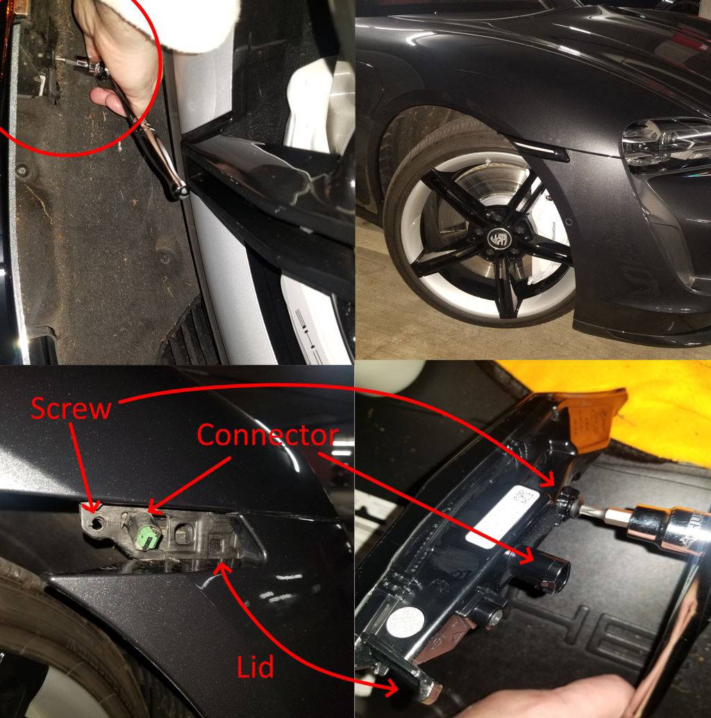

I needed a T20 (torx) screw also -- I think it may depend on the model year? Mine is a 2020.
With a ratchet it is much easier to access the screw without the wheel getting into the way, and pre-threading really helps! The hardest part for me was to push the sides of the connector at the right place to unlock it.

Thank you I appreciate the positive feedback. The wheels are gloss black and chalk. The interior is tan and black.
i love the Porsche logo on the wall. My kids made it for. Thanks again.

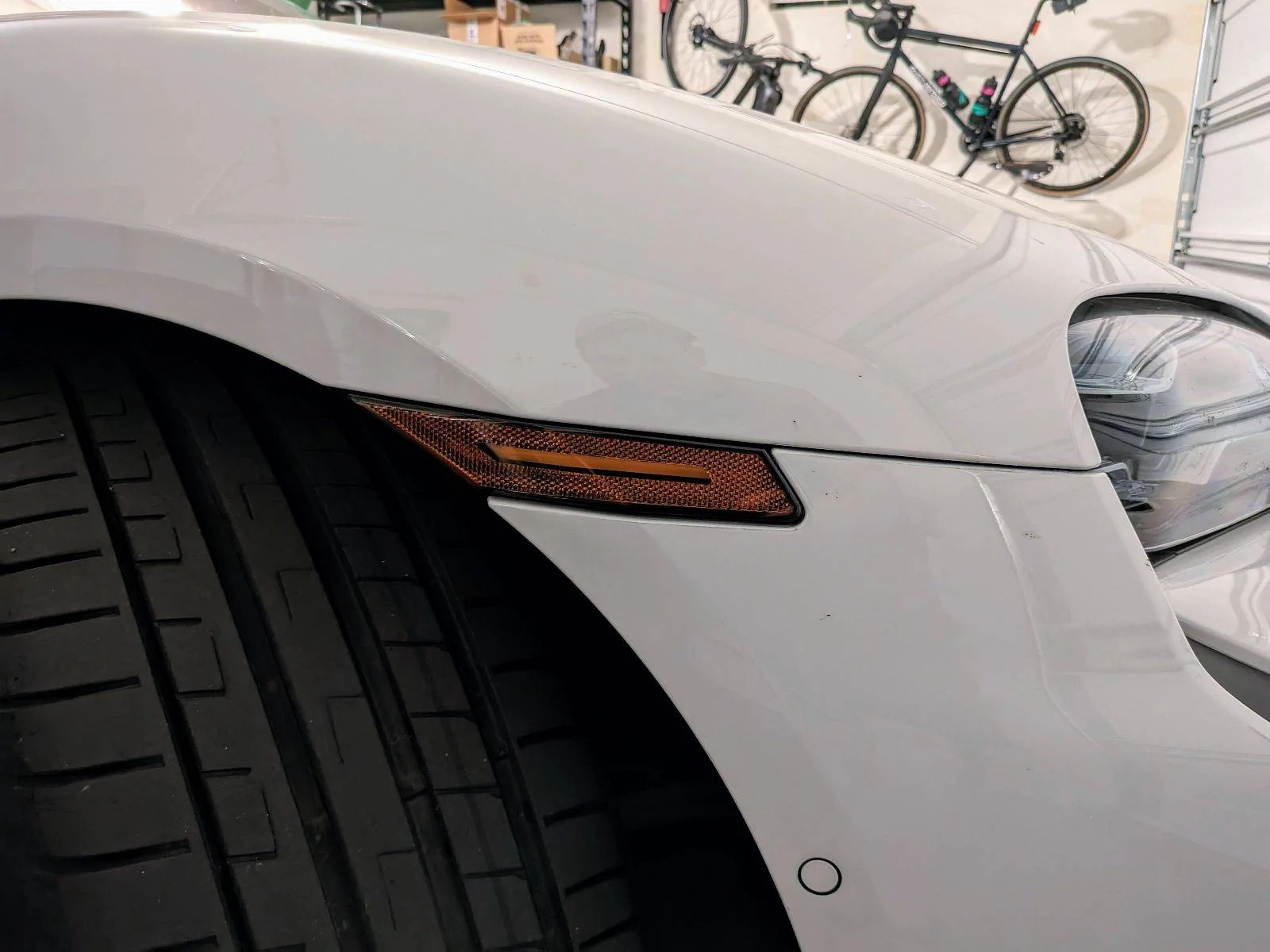

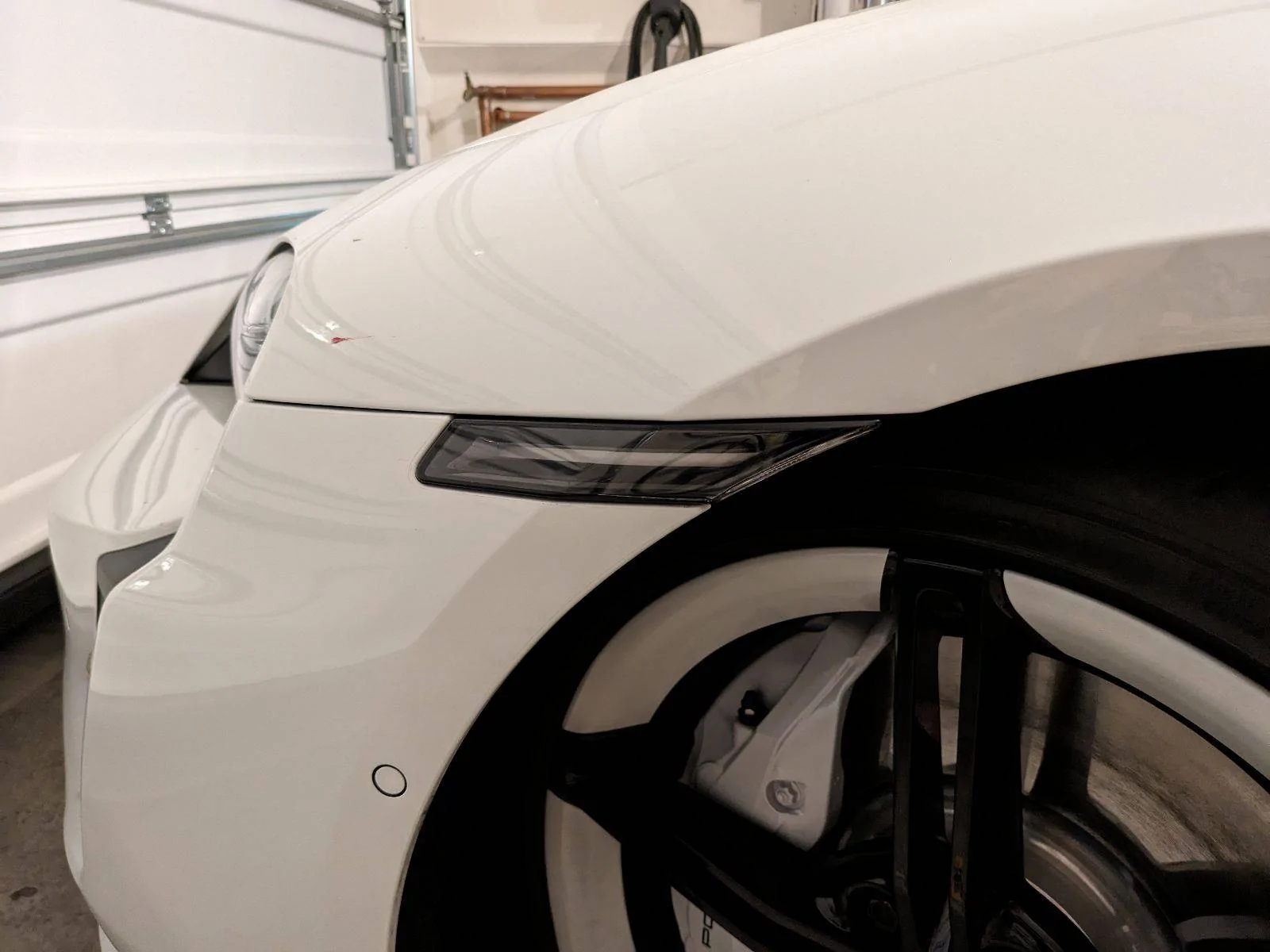

I know this is an old thread but I just did this mod. I found that it was much easier to turn the wheel the same direction as the marker you are removing. You can fit pretty much anything in the wheel well in this position (first pic with orange marker).

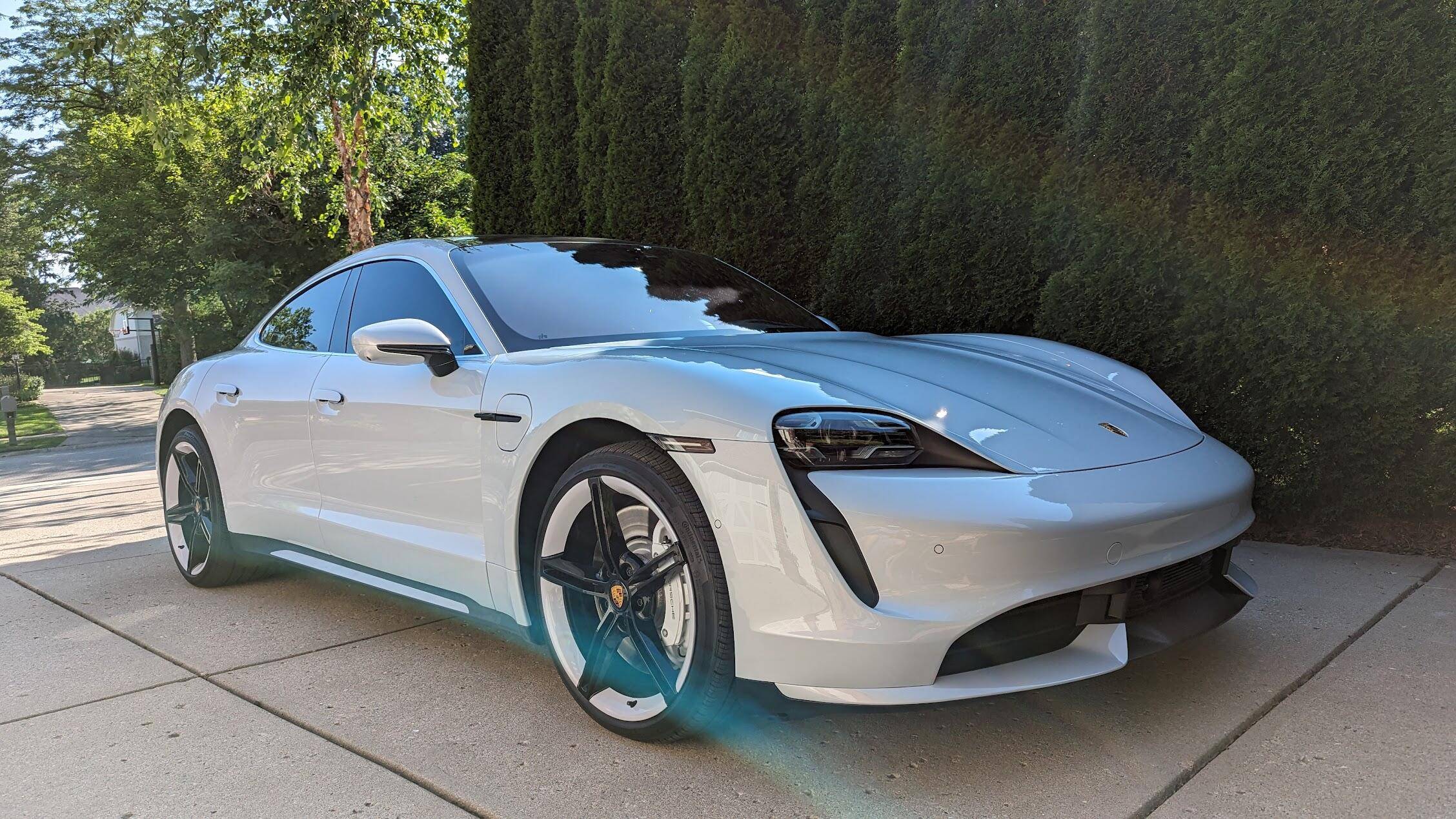

I love this mod as well. I asked my PPF installer to do it since it is good to have them off to wrap the film. I only did the front bumper with colored fins and headlights, lower parts of the doors, and a bit behind rear wheels, but not the hood as not to distort the true color, although the film does a good job on being invisible.
