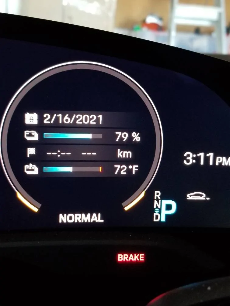

Here is the latest. Battery temp continues to increase (now 72F) at 79% SOC charging 5.24kw. Maybe by the time it finishes charging to 85% it will be at the ideal temperature for charging :like:.
Porsche Taycan Does the battery get heated up by default upon charging? 20210216_151126_resized
Kingske
Kingske
Jun 6, 2020
79
1,431
1,643
New Jersey and Colorado, USA
It seems to be following a very similar SoC-temperature trajectory.
