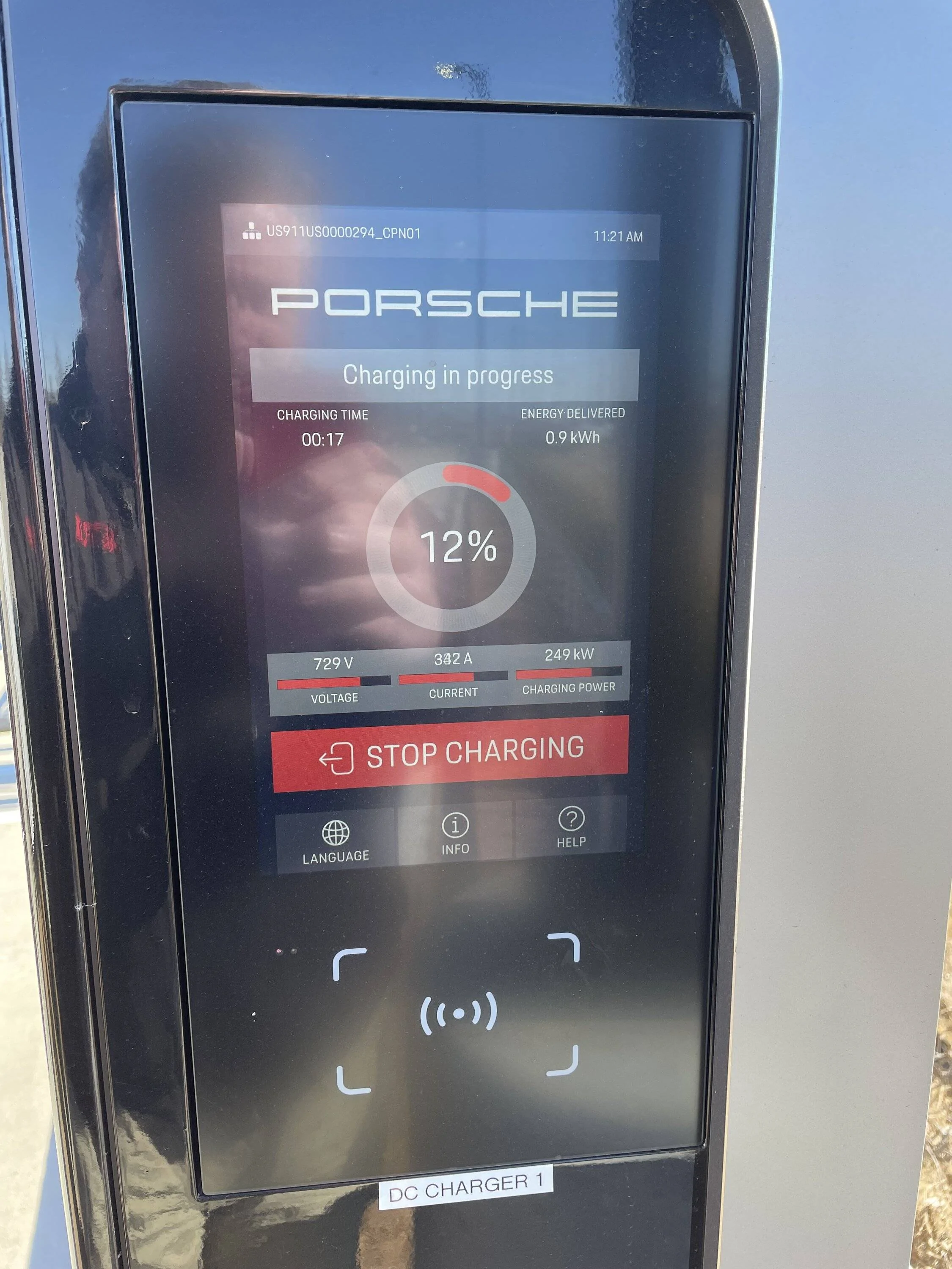

I observed pretty good rates at my stealership.
My dealer has been under construction since I ordered my car. They have been sharing an Audi dealership so they do not have any high speed chargers. Hopefully when they open the new dealership they will have one and we can both check the charging rates.
My dealer installed this exact kind but they know very little about it. My SA confirmed that this is mandated by Porsche but no one has yet to use it. My question would be if it shows on My Porsche App (not showing it for me in My Porsche App using charge station view in the map) or any other app with kW label and if it is busy or not. I wonder if you can confirm for your dealer's charger, Derek, if it shows it for you and if there is available/busy status.
