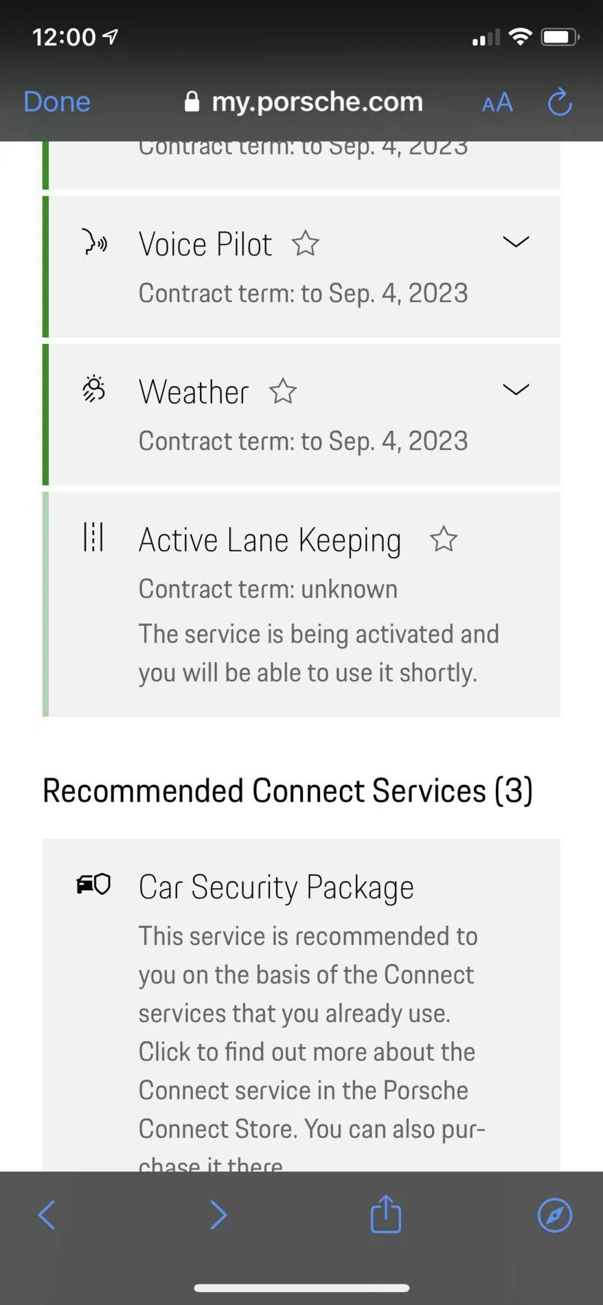

Was it the same problem? You selected an FOD option and it showed as “the service you selected is awaiting activation and you will be able to use it shortly” ?

This is what my Active Lane Keeping FOD looks like and it’s been that way for 3 weeks:
Porsche Taycan Function on Demand - Not Working? 1B07C5E9-998D-49D7-A27F-52134AB1C5B4

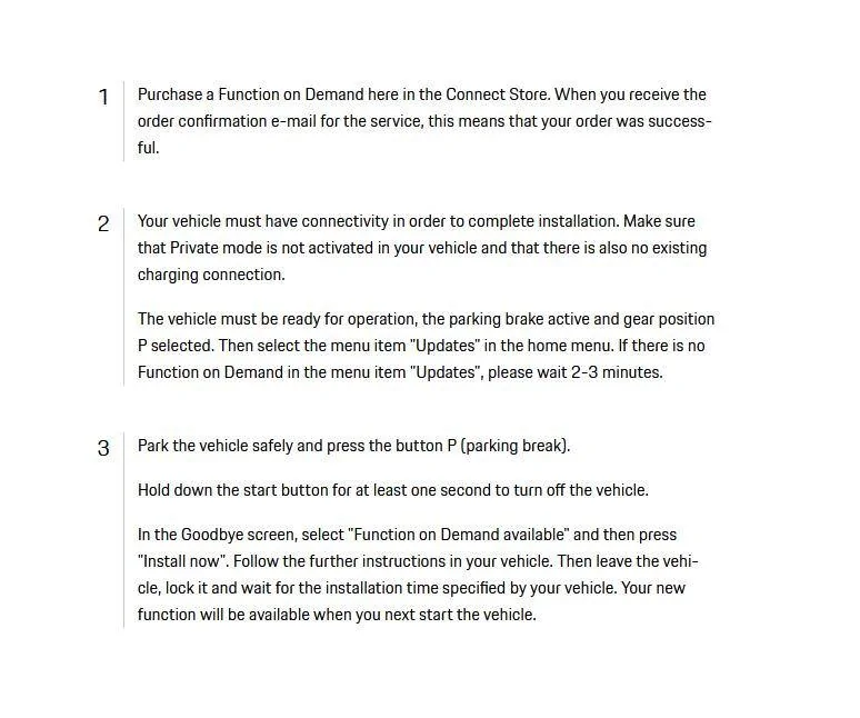

Not sure if it will help, but as a sanity check, did you guys follow these steps?
Porsche Taycan Function on Demand - Not Working? 1624122427432

I've confirmed privacy deactivated, parking brake on, P mode, nothing in updates.
I have not tried sitting on the update menu and leaving it there 2-3 mins. I have tried entering/reentering updates frequently though.
Yes, exactly the same. It stayed like that for weeks.
And I also tried every trick I could think of, but no luck.
A visit to the PC was necessary and they fixed it.
They said they did a reset of the PCM, but I suspect they did more than that.
Anyway, I now have the FODs.
